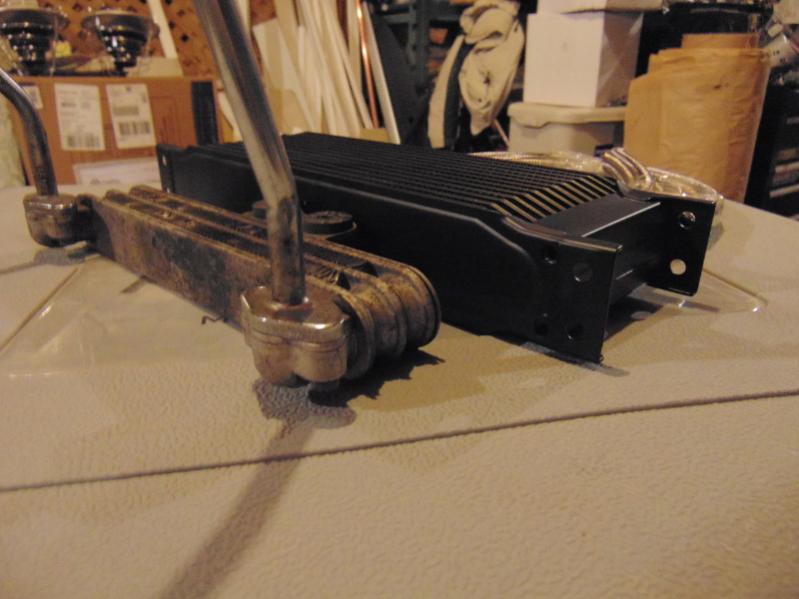

So today I got my PAIR block off plates, thanks superdutyd. As well as the hose kit for the rads, and the new oil cooler. All I have to say is OMFG this oil cooler is... HOLY F@#$ING $H!T... I just dont know what to say about this...
I'm starting to wonder, between the oversize dual front mount rads, the electric water pump, and this ungodly massive excuse for an oil cooler if I even need to run a fan lol
I may just get 1 or 2 small fans on a toggle switch and scratch the temp switch, because I'm beginning to think I wont need them very often...

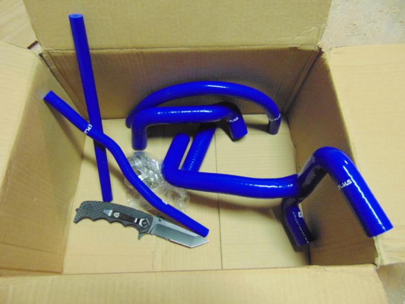

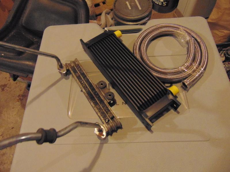

I think fedex is fu@#ing with me... not having my rads are holding up this build, it took 4 days to get the package from CT to MA the next state over, and they had the package at their facility yesterday and it didnt end up on a truck today... WTF
Anyways heres some eye candy of my obscenely big oil cooler and rad hose kit
OBSCENE!!!

Perhaps Crux got your rads by accident?
Where did the hose kit come from?
I'm a bit concerned you may not be able to get the front end up with that oil cooler mounted.

hose kit, cheapo ebay $60 kit... havent heard anything bad about them so I figured Id give it a try. plus it'll be easier to modify those hoses then spending hours in the hose section of the local parts store just to end up with a million and a half splices...
and dont worry about the front end

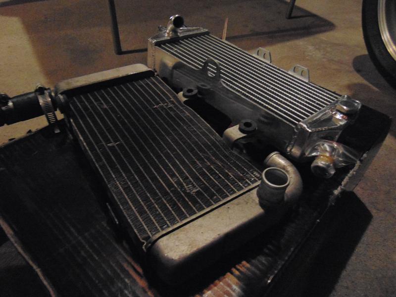

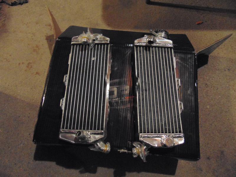

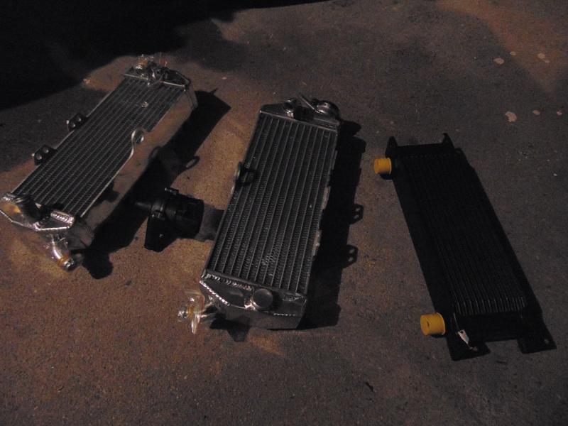

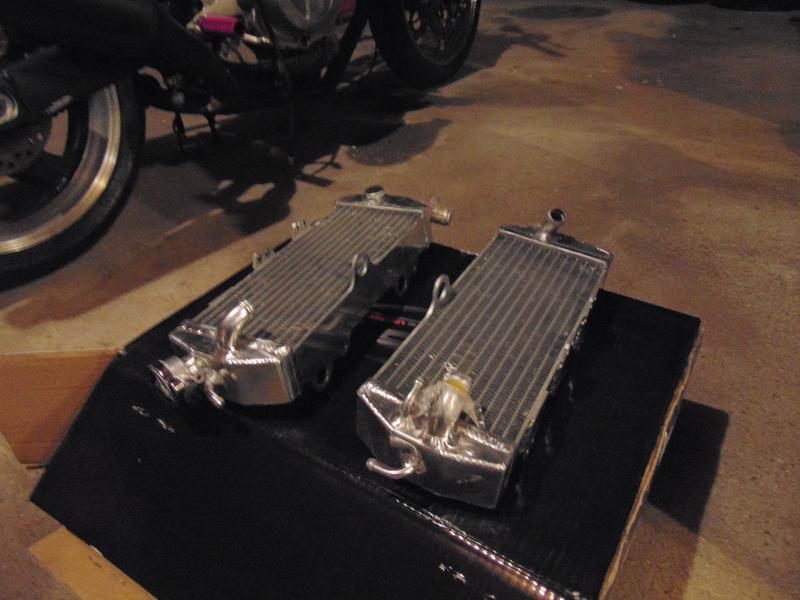

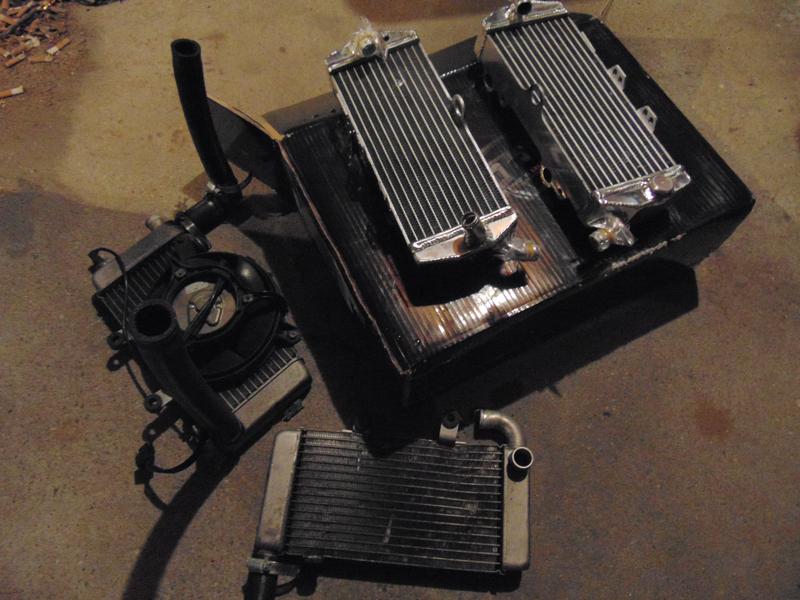

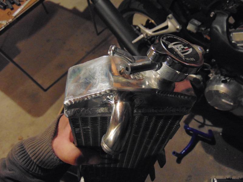

Finally got my rads in today these things are nice! Ive definitely seen better welding but its not horrible and as long as it functions I'm happy, they even came with a 1 year warranty.
Compared to my old beat up factory rads the immediate noticeable differences are as follows: they look better (no **** sherlock), they are about the same length, they are 11 rows wide where as the factory ones are 14 rows wide, they are 2 rows thick where as the factory ones are 1 row thick, and the main hose connections are smaller then factory...
So besides realizing I need like 10 sets of hands to figure this **** out, theres only one issue I see right now. If you look at the first and last picture theres a small hose connection(not the overflow connection) thats a small secondary line going to the other rad. the big connection in that picture goes to the other rad as well. Well due to the placement of the oil cooler that connection is going to point right at it with no room for an elbow to go around. I thing I'm going to have to plug this connection.

So it turns out I cant use this hose kit at all, I may be able to use 1 or 2 hoses but its not worth the $60 if I can return them. I still want to add some color to the bike with the hoses so I'll see what samco has for prices per foot, if its not stupid expensive I may go there but otherwise does anyone know any companies to look into?

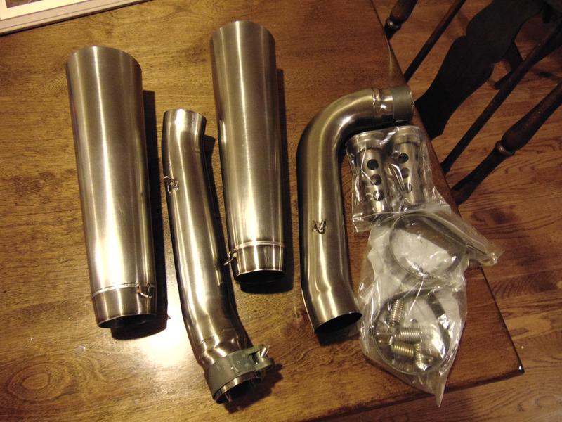

Recieved my new danmotos today from captainchaos, which was a great price for brand new pipes.... isss gon be loud!!!!!

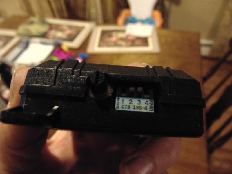

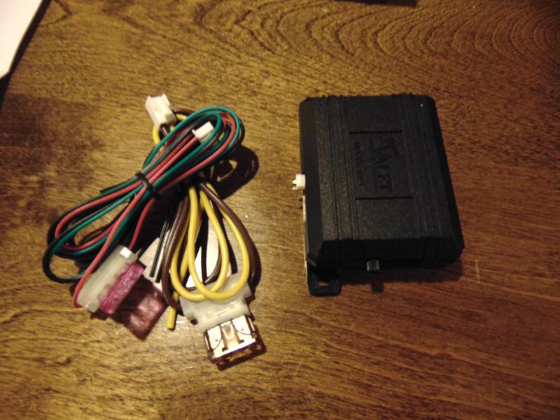

I also recieved this incredible latching relay for my RFID setup, gotta do some more research on how to set it up but it is more or less fully adjustable and can be delayed 1-100 seconds, I snapped a photo of the settings sheet so you guys can check it out...

Scottie, when you figure out how to wire the RFID and 611T to our bikes, let me know. I started a thread here with the same equipment, and kind of have it figured out. However, it would be nice to have another "electrical guy" take this on. I would love to install it this year. I got a guy who can insert a glass ampule under my skin. Not saying I will go this route, but it would be pretty neat starting my vehicles without a key and just a wave of my hand!
Now, I know you will be chopping up and making your own wiring harness, but the priciples are still the same.

What're those two round things with all the holes in the picture with the pipes? I think that's some sort of filler material. You can throw those out.
you are correct, useless filler

From what I have read on other forums, you are supposed to insert those round things inside your exhaust loosely. You then start the engine and as fast as you can, FLOOR IT! Next, take out a tape measure and see how far you got them to fly. Post your results for others to compare.

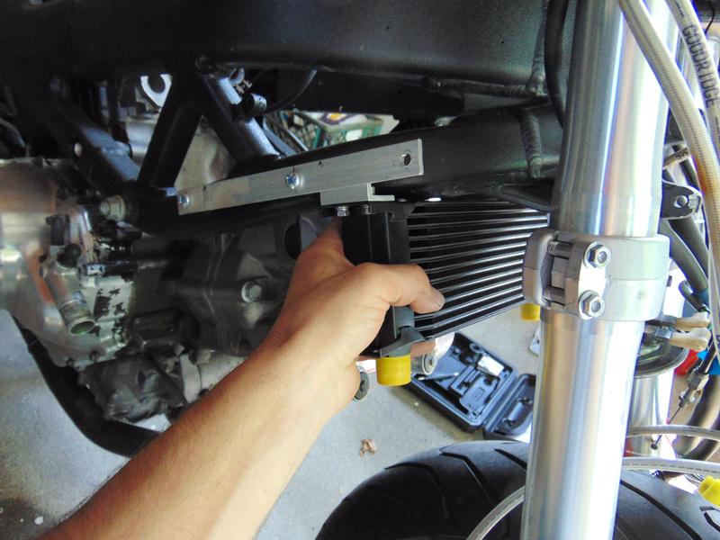

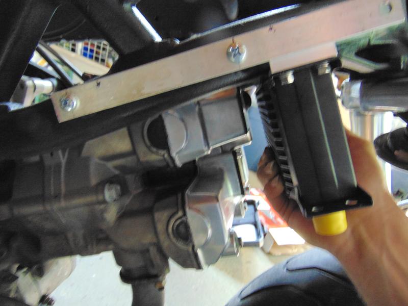

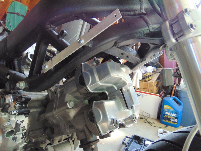

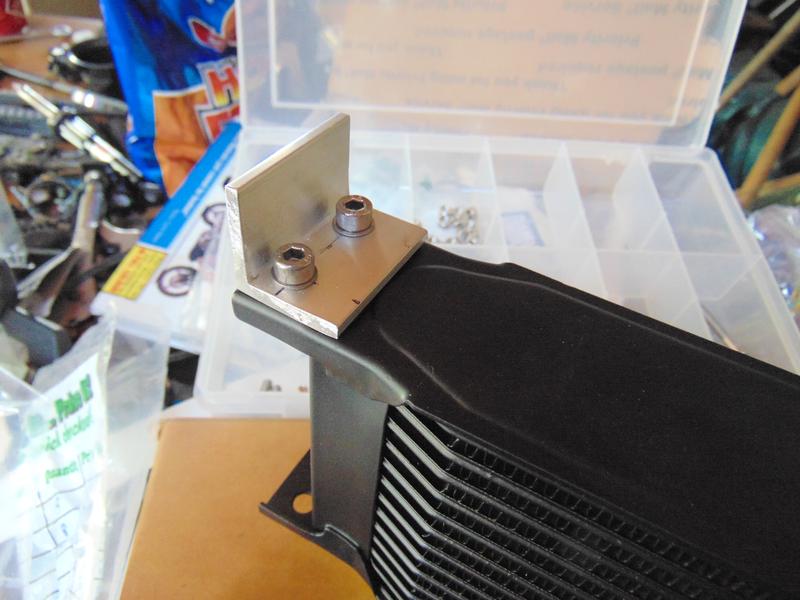

Alright, while my son was taking a nap I found some motivation to start working on the brackets for the cooling system. I drilled and mounted up extensions from the previous radiator mount points and made up the brackets that mount to the oil cooler. I didnt get a chance to mount those to each other but I will get the oil cooler mounted tonight. I tried to take some pictures of how its going to mount up but holding a full size camera with my left hand when the button is on the right so you have an idea, but like I said I'll have it mounted tonight and take some better pictures... in the end all the brackets will be cut of excess
"fat" cleaned up real good and anodized black(most likely black).
