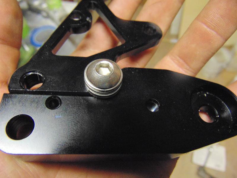

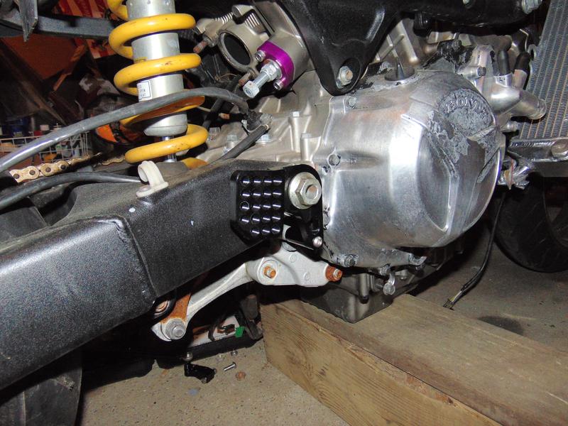

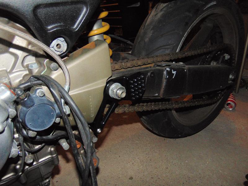

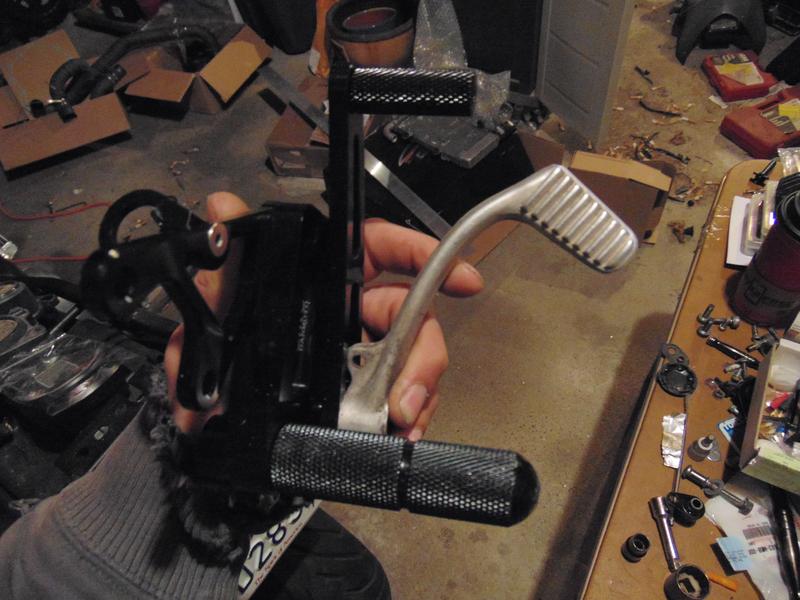

Tonight got my danmoto rearsets installed... well atleast the hard part

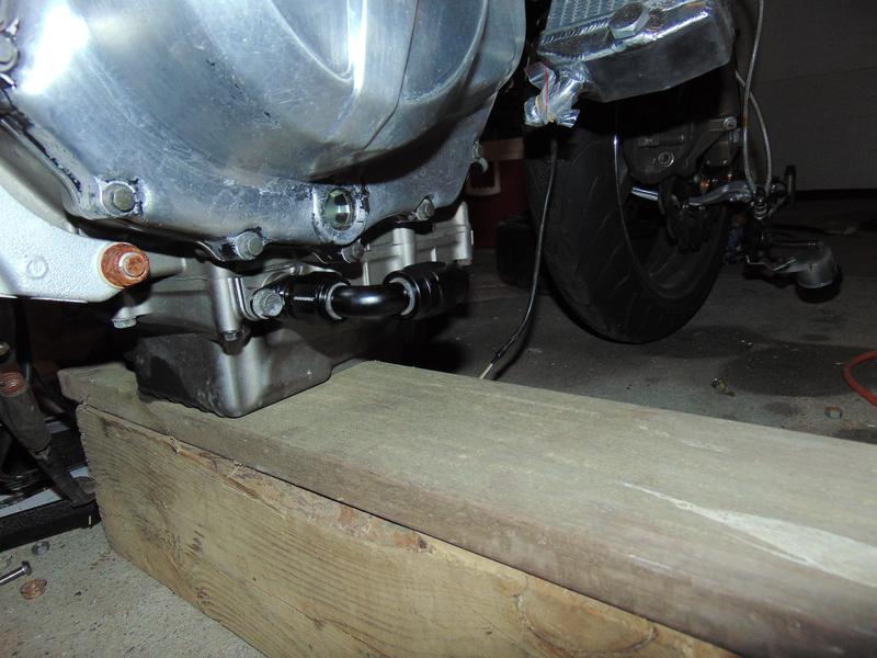

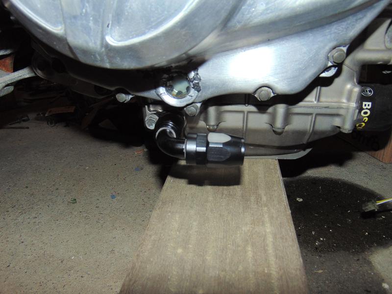

Also got my oil cooler fittings brazed, cleaned up and painted

Have fun with the Dan Moto rearsets.
There is a mod that you will need to do to the rear brake master to stop it from flexing.
I think I posted it on here.
If not I can post you some pics if you want, they have been good on my bike after the mod that I did.
Coming along nicely by the way. Oh, I think your radiators look the goods as well.
Always good to see someone try something different.

Ken - yea I'm aware of the mod but thanks for looking out. I have seen the thread and the different ways people have gone about fixing the issue.

James, been meaning to text you about the oil fittings but I see you found your way back to the thread...
both bikes look awesome and yea the RC looks like they just removed the fork cartridge and stuck a piece of straight steel tubing there.
as for my oil lines, I just ordered some 45 degree fittings for the cooler side and more hose (I was originally planning on a low mount so I only have a 3' section of hose)
hopefully by next week I'll have the oil cooler fully installed and ready to go

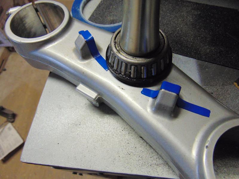

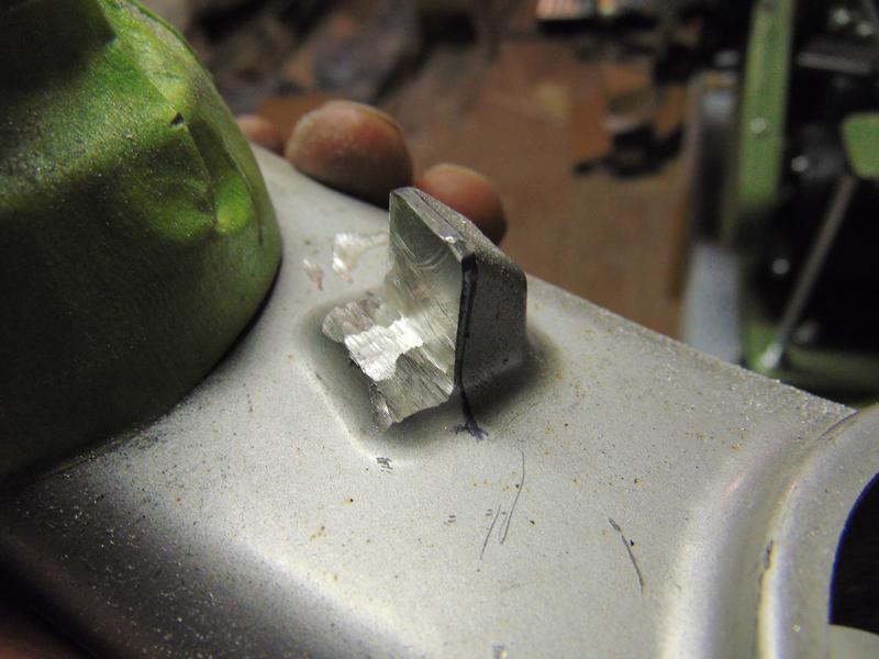

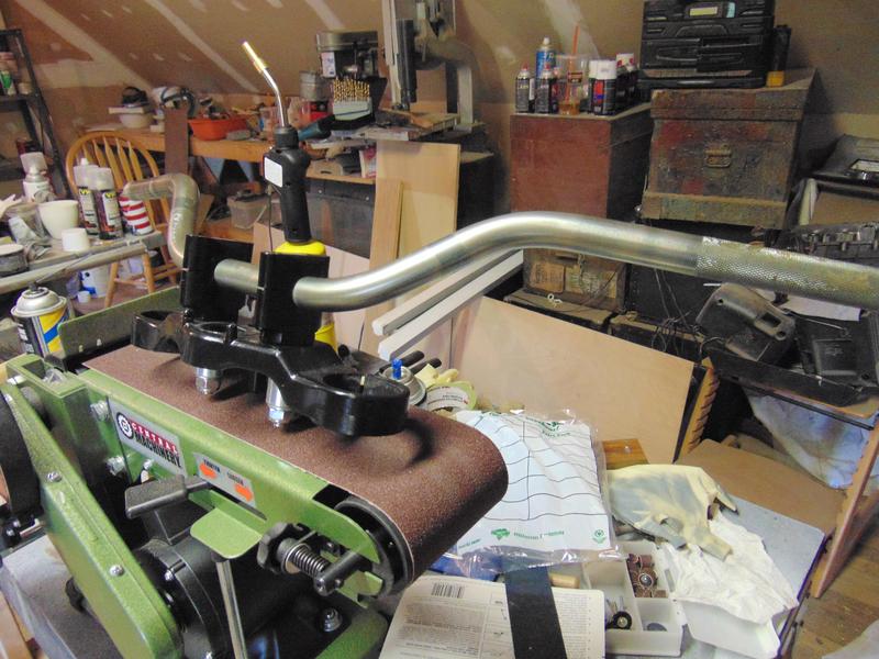

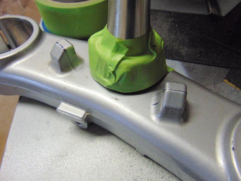

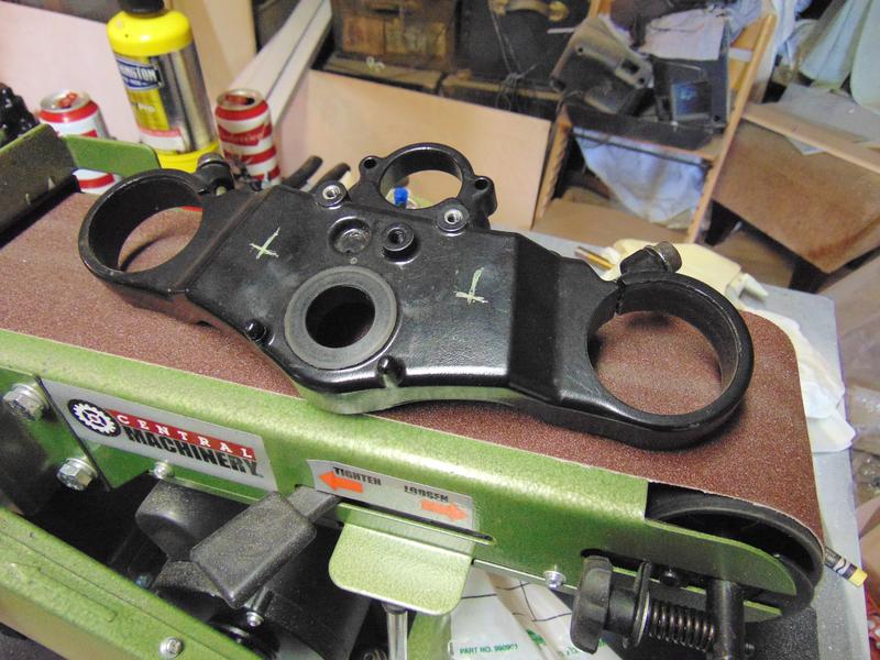

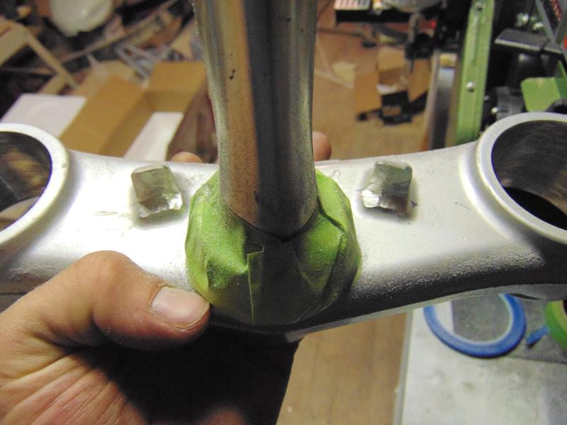

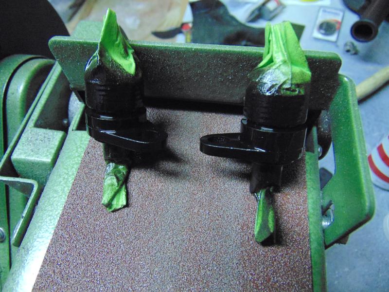

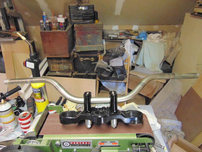

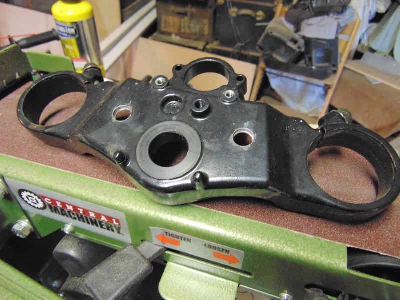

So did a ton of shopping this morning for little bits and bobs for the bike... Also spent about an hour in one of the local radioshack's because they are closing and everything is 50-80% off... still trying to figure out what I'm going to do about the 1" to 3/4" from the water pump cover to the electric water pump but I think I have a solution...
so far today got he upper triple drilled for handlebar risers and the steering stops ground down on the lower triple... time to start working on the rest of the radiator brackets

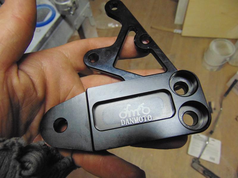

Just found out that my dad took his chop saw to the cape so I'm not working on the brackets tonight... guess scotties gotta get himself a chop saw
Just fixed the danmoto weak brake M/C bracket. Drilled it from the back and tapped it for an M8 bolt... I'm going to see if I can find a shorter bolt so I dont have so many washers on there but it will do its job for now...

Ya it was odd. I realized it was already drilled but had no bolt?
So i did the same mod. Drilled out and put a m8 with a lock thread bolt. I don't like how tight it is. Doesn't seem to "MOVE" freely. I find myself pulling up on the lever all the time after braking.

All I've done tonight is tighten down the oil cooler fittings on the engine side that I made up, and tighten down the coolant outputs on the cylinder heads... too bad I dont have a match or close to a match on the longer bolts for that one... gotta hit up the hardware store for some longer m6 bolts
