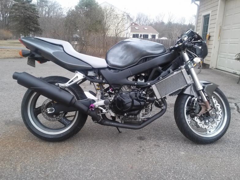

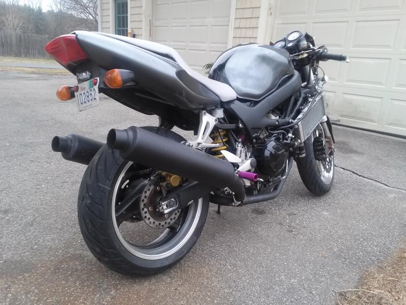

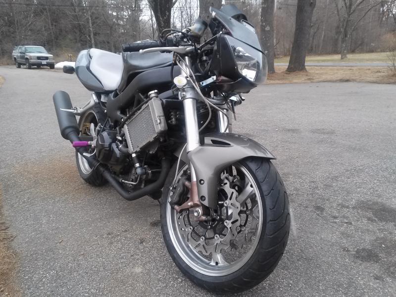

So here it sits at the moment... not pretty, not finished, but rideable for the first time in a year and a half...
I decided this will be my build thread as well, seeing as I have big plans, and if I actually start planning it and collecting parts this early in the season, I might actually be able to complete the mods by next season...
So the modifications I did while it was down...
04-06 CBR1000RR complete front end including the bigger throttle tube
15-42 gearing
swapped out my homemade MCCT's for proper machined MCCT's
a lot of maintenance
and a lot of paint

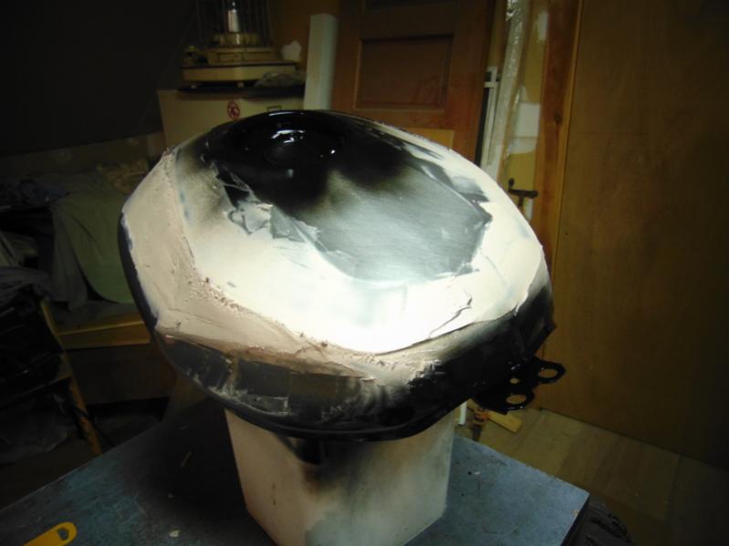

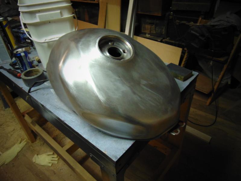

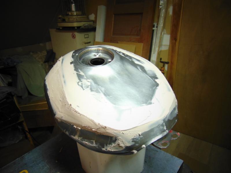

got a few pics of the paint progress... headlight bezel and tailsection need some help from sandable primer and more sanding before pre-paint primer and paint go on.
gas tank has been cleaned of all previous paint, seams and filler area have been coated with heavy duty epoxy paint to prevent rust and corrosion, two small dings have been bondo'd as well as the top outer edge so I can provide some sort sharper edge for cosmetic reasons... the vision I have for my custom bodywork (once I get around to it) will have sharper edges and lines then factory and may clash cosmetically with the overall roundedness of the gas tank.

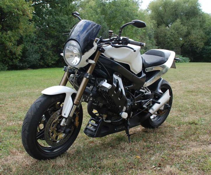

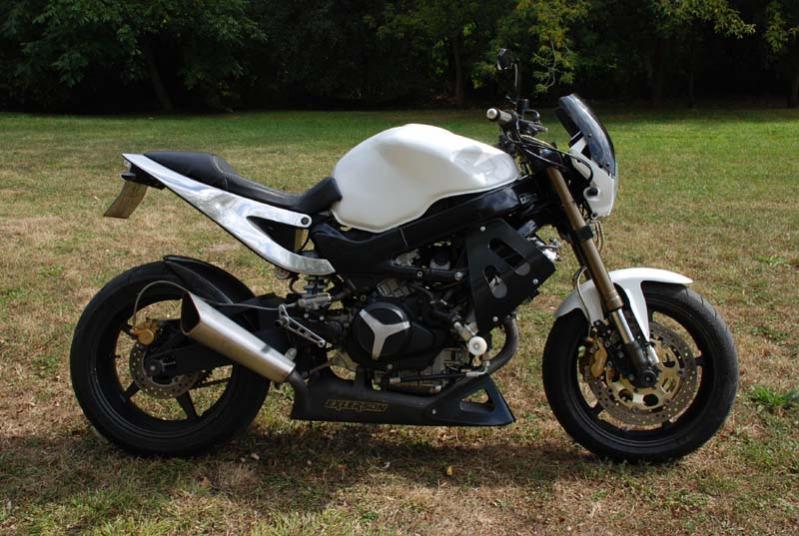

I agree. None with rads on the side really look right. This one comes the closest.
Undertail cosmetically seems to be the best option.

That is a lot of Bondo. I hope you don't have issues with cracking or lifting in the future. Did you apply Bondo to bare metal or did you use metal etching primer, then Bondo?
Old Apr 26, 2015 | 11:16 AM
scottiemann's Avatar
Posts: 1,252
From: boston
xeris, that is a pretty nice setup... the ideas running through my head at the moment are front mount SV rad or undertail but that is definitely an option there... Im leaning more towards the front mount because the undertail, although a single rad, would seem to me to be a lot of extra weight due to plumbing and more fluid capacity. how much I dont know but I know the front mount looks good and would be a lot easier to fit.
crux, lol, I know thats way too much bondo but the night I was working on it I had the heat cranked way up in the shop and literally didnt have time to scrap the excess off before it started hardening. I have a lot of sanding to do in my future on that one...
And I sanded the gas tank down with 80 grit and thoroughly cleaned it prior to application... I hope it doesnt lift or crack but there isnt going to be much bondo on there when Im done sanding, like I said I just didnt have enough time to work with it.
Attachment 18632
Attachment 18633
Wow I love that. Is there a thread on that bike?

just did a quick google search for the file name on the pictures and came up with this thread
VTR 1000 streetfighter... Cooling? - Honda Motorcycles - FireBlades.org
not from our forum, and aparently the rads came off a KTM

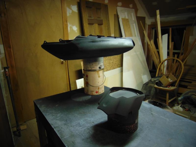

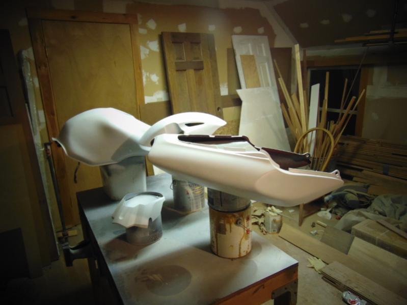

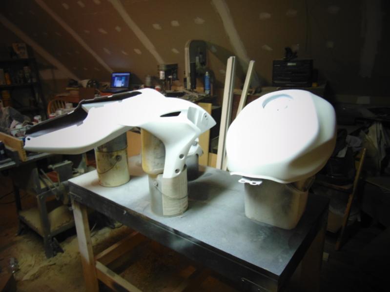

Alright had to take the day off of work for a dentist appointment so I was able to get some work done. Finished sanding everything and got a good coat of primer on everything. Have a little touch up sanding to do tomorrow and might have to give those areas a quick blast of primer tomorrow before moving on to paint.

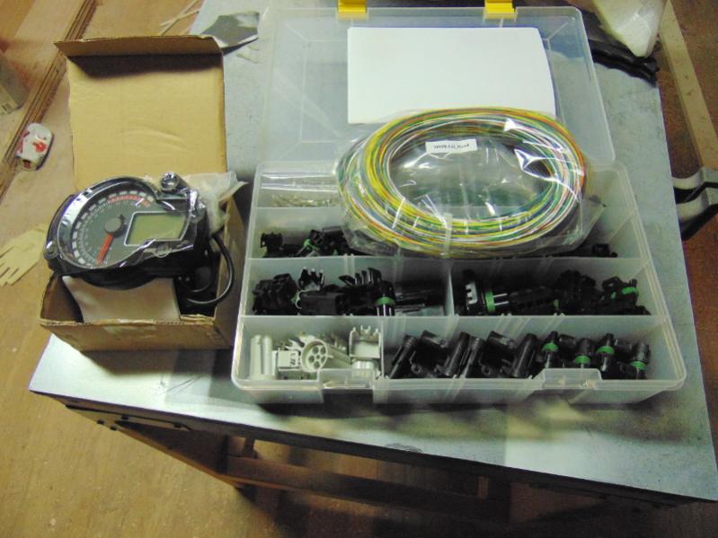

Alright Im still working on the paint but new parts came in today!!!
like I said, Im going to be rewiring the whole bike (for many reasons), The weatherpack connectors are very beefy compared to factory but at least I'll be able to trust them 100%... or atleast 99%... and I'll be hiding as much of the wiring as possible for a clean looking streetfighter.
The gauge is a cheap chinese knock off but I have seen people set these up to run perfectly so for $70 to my door its worth a go. And of course I have a lot of changes to be made in the electrical department so everything I plan on changing will be installed and tested prior to the rewire.
