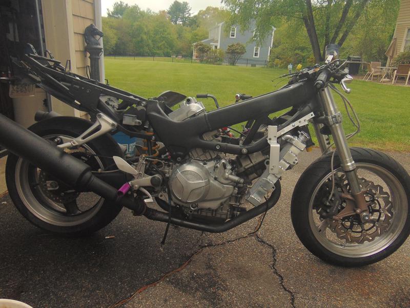

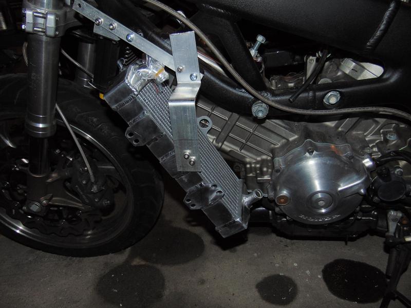

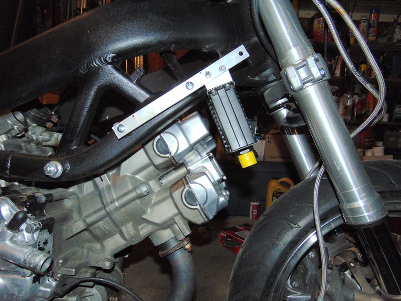

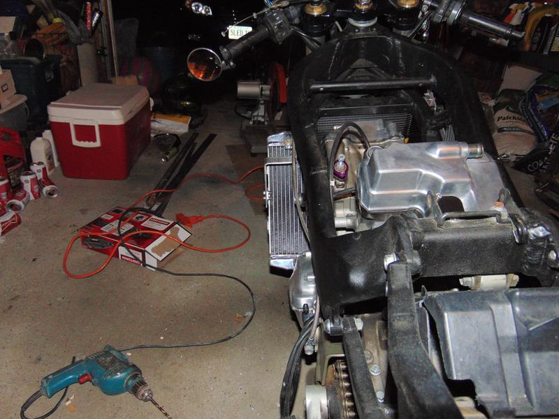

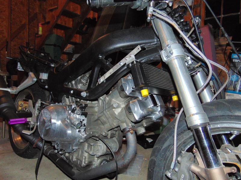

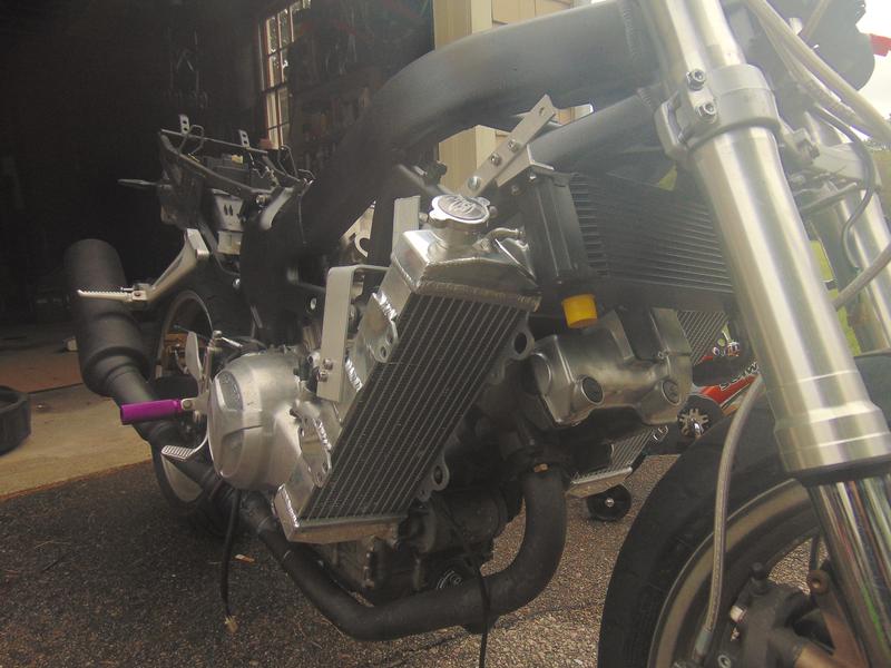

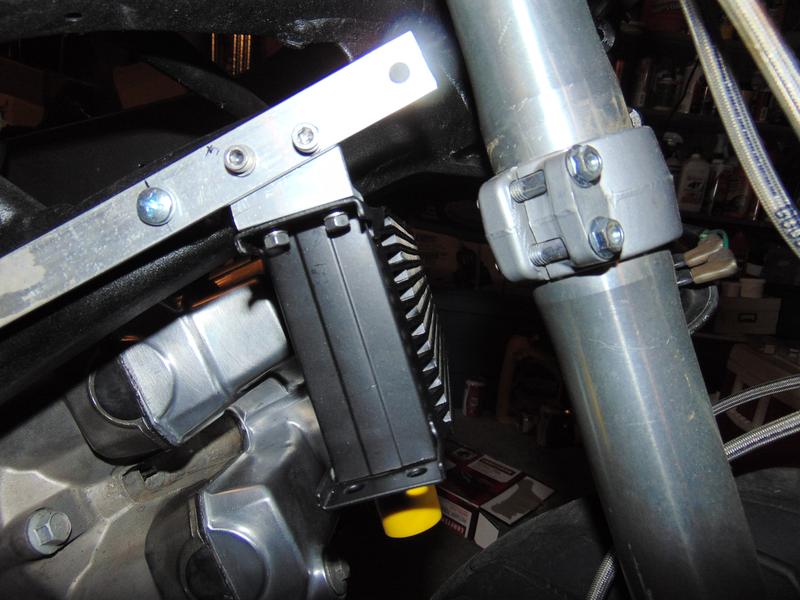

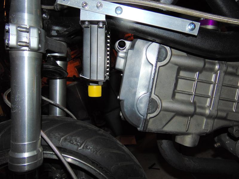

Got the oil cooler mounted up tonight, I still have to trim all the brackets but I gotta mount of the rads before I know what to trim and what not to trim. I'm also going to be cutting off the lower mount points from the oil cooler as I wont be needing them.

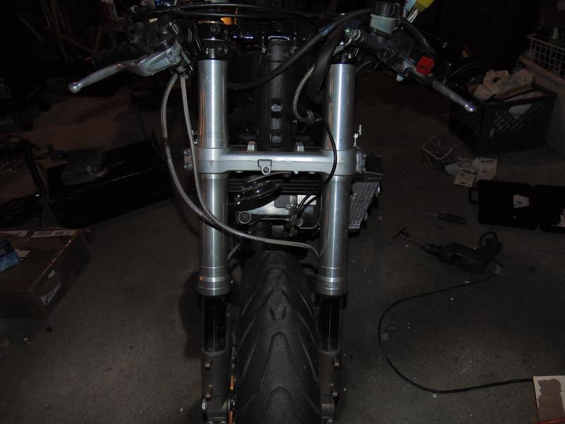

And theres still plenty of room at full lock but I still have to trim down the steering stops on the CBR triples atleast a little

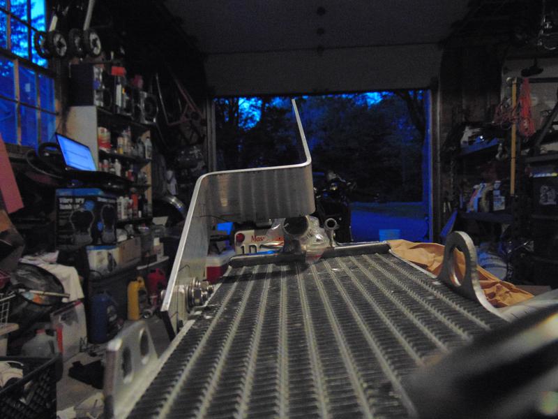

Alright I'm pretty much done roughing up the outer left side bracket. Dont worry about the massive amount of aluminum bracketry thats going on right now, When I'm all set and happy with all the bracketry the space beteen mount points will be a lot less wide and everything will look all nice and clean for obvious reasons(see pics). Heres a bunch of pics from different angles so you guys can see how far they stick out and what they look like, and by they I mean the left side... lol

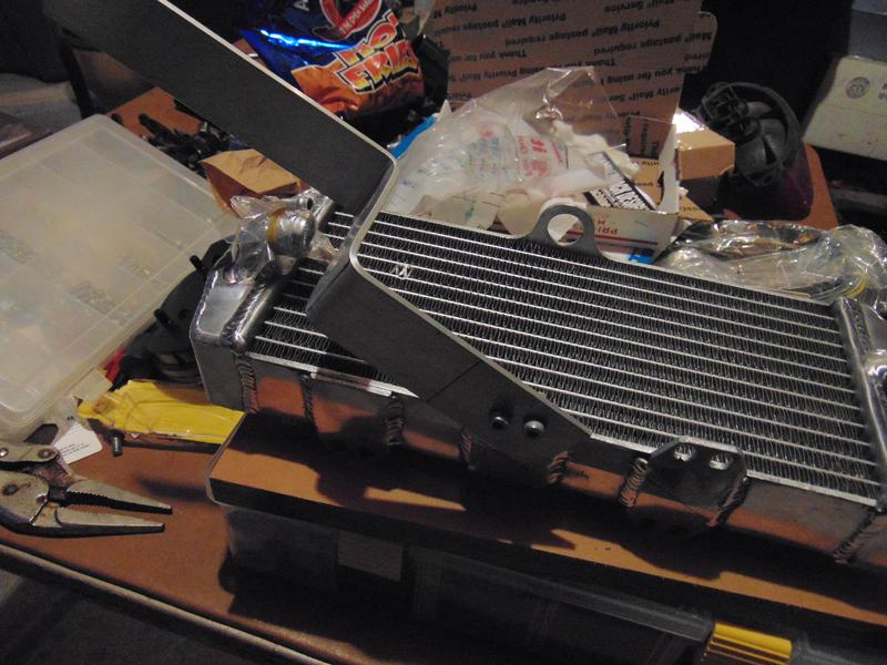

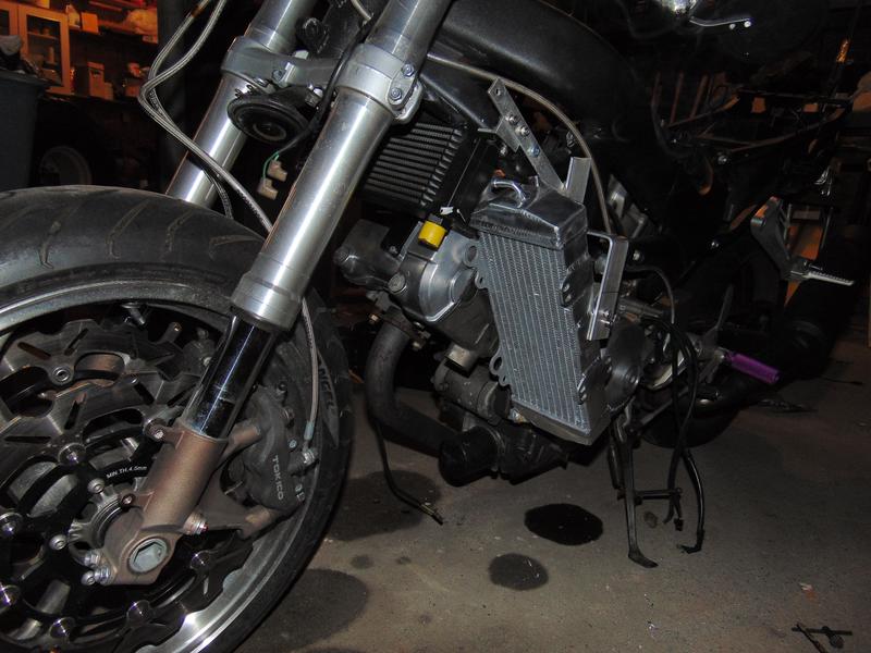

Got the right side mounted up, ran into a small issue with the upper hose connection which was hitting the frame so I took both off and bent the brackets a little bit so theres enough room for that hose. I have a solution for the inside brackets but I have to go to the hardware store to get some things for it...
Did a bunch of research earlier today on how I'm going to hook up the oil cooler lines so I ordered up some "weld on" bungs and I'm going to hack up the factory connections.
So more parts ordered, more parts shipped and more parts arrived today...

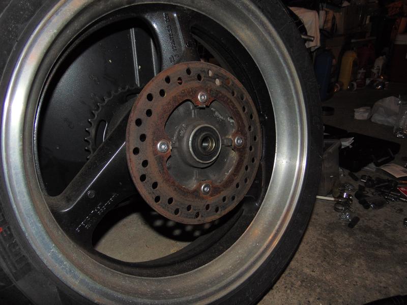

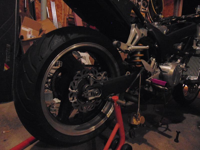

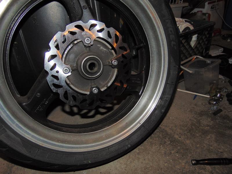

The old rear rotor was a cheap chinese ebay peice-o-*****... no pads could get a hold of it and all it was good for was rusting. I can tell you that I really know how to use my front brake
now that I have a good rear rotor its time for rebuilding my master, flushing the system, and swapping out the factory res for one of James' HRC style deletes. thanks James

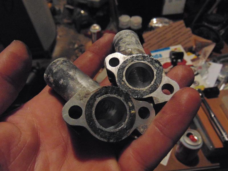

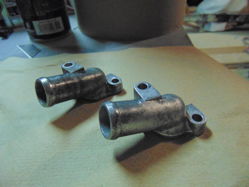

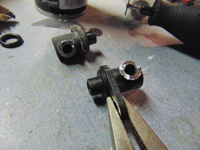

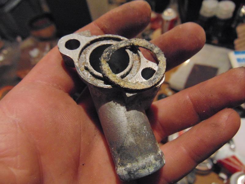

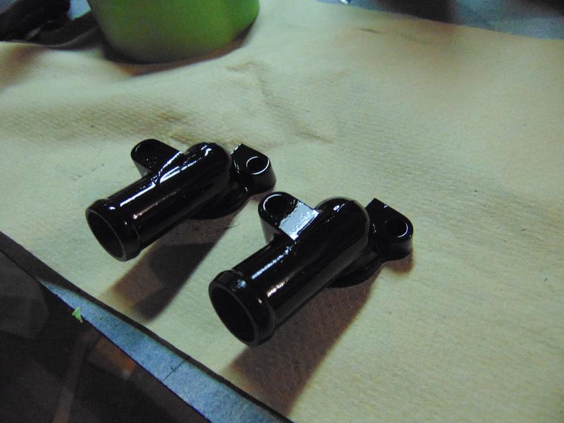

Alright got the cylinder head coolant outputs cleaned and painted. heavy corrosion again, atleast aluminum's white oxidation is easier to clean up then rust...
and BTW is this supposed to be an O-ring?!?!?!?! **** specialty O-rings (square rings?), I'm going to the hardware store and buying a beefy *** O-ring for a quarter of the price

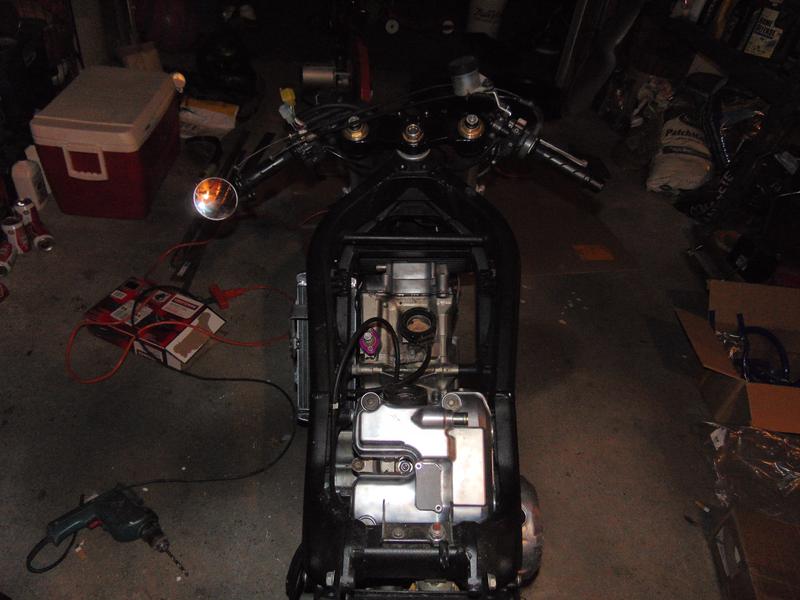

FML... exhaust is off ready for wrap, clipons are stripped read for fork removal, top triple needs to be drilled for bar risers, lower triple needs steering stops ground down. Rear peg mounts removed ready for sanding/paint....
I'm too sober/exhausted for this ****...

Alright so the other day I started hacking up my factory oil cooler connections until the last of my 3 cheapo grinding wheels wore out/shattered for my rotary tool. As my dad took his angle grinder and belt sander to the Cape, I was done with that for the moment...
Spent most of this morning hardware/tool shopping. bought myself an angle grinder and belt sander from harbor freight... I know its cheap but for $30 and $80 respectively with a 2 year warranty, they will pay for themselves by the end of 2 years. Also got some spacer bushings I need for the handlebar risers, grinding wheels for the rotary tool, silver solder for brazing so hopefully I will be done making the oil cooler connections by tonight.
I also wrapped the headers today and went to the dentist... shes such a nice lady but I dont like her right now...

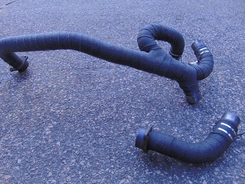

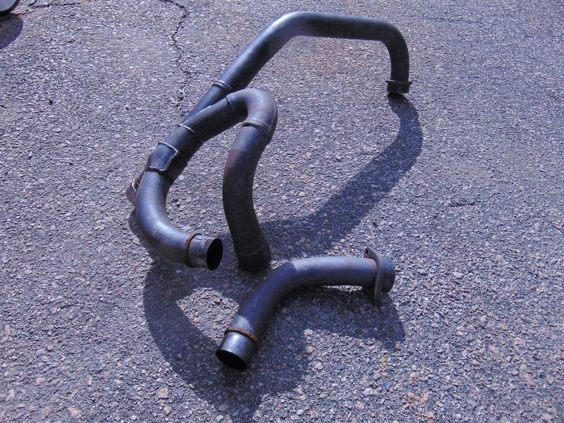

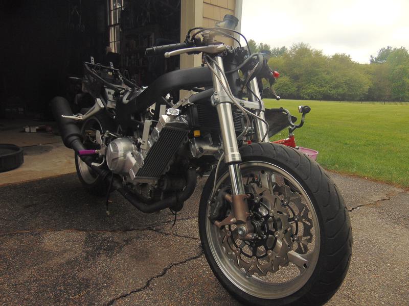

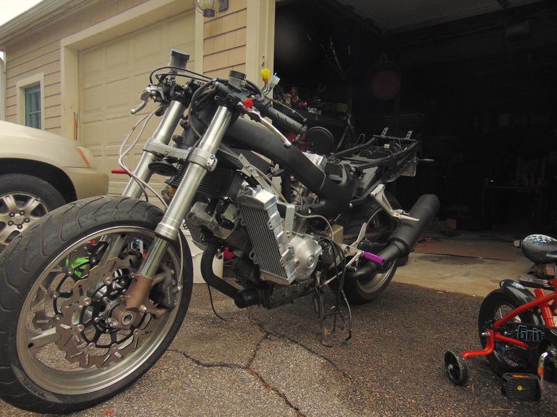

Got my headers wrapped up, I know their pretty rusted/paint/***** but at some point will be doing a custom exhaust so as long as they are functional for now whatever...

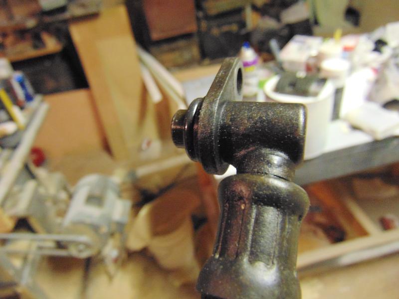

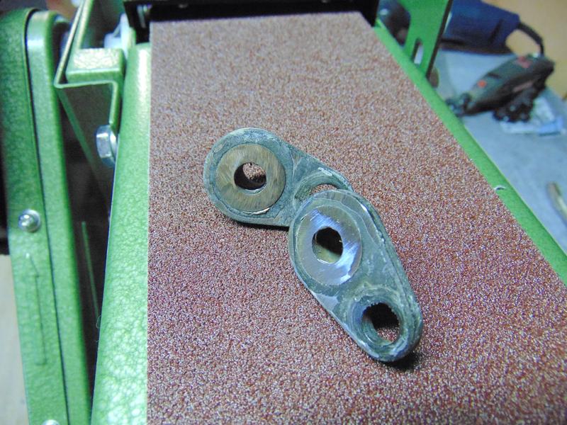

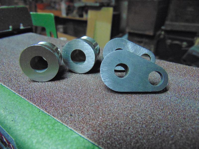

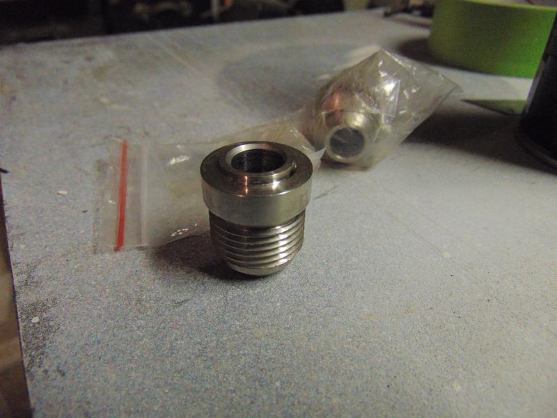

Also working on finishing up my oil cooler connections on the engine side, they are all but brazed and painted.
weld-on/braze-on AN fittings
factory connections
stage 1 of cut down
stage 2 of cutdown
grind down the excess almost flush ready for the belt sander
factory fittings and AN fittings ready for brazing then paint
wish I had a countersink drill bit to match the diameters but hopefully dont run into problems... only time will tell

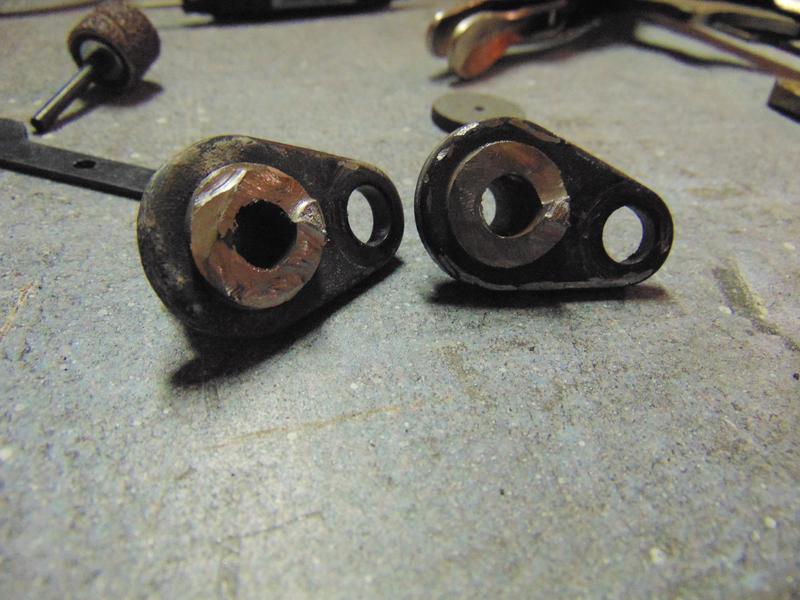

Old May 31, 2015 | 06:43 PM

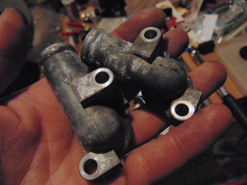

I'm painting my engine and pulled these off to make it easier to get all the corrosion off of them. I had some 20x3 mm o-rings and even though there really seemed to be enough room for these to fit inside. About 15 minutes ago, I was lightly tightening one down on the head and it cracked in half. They're very brittle.
Get the OEM o-rings. They are only a couple bucks each.
Old May 31, 2015 | 06:58 PM
  #148
scottiemann's Avatar
Posts: 1,252
From: boston
hmmm... how far did you have left to go because I was just about to put mine back in and after seeing this checked the thickness of my O-rings and they are 2.38mm
Old May 31, 2015 | 07:06 PM
  #149
There was maybe...half the thickness of paper left to go when it broke. You might be okay with 2.38mm.
Your call man.
Partzilla doesn't let you buy just one "water joint" either. You have to buy two. Two water joints & two gaskets = $26.87 (w/shipping)
