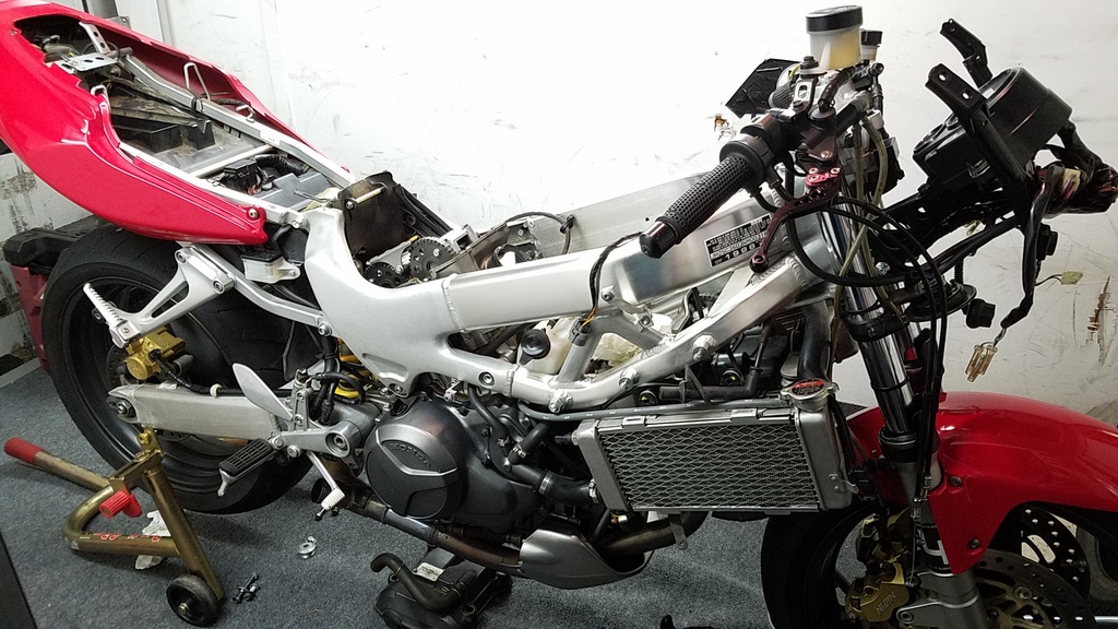

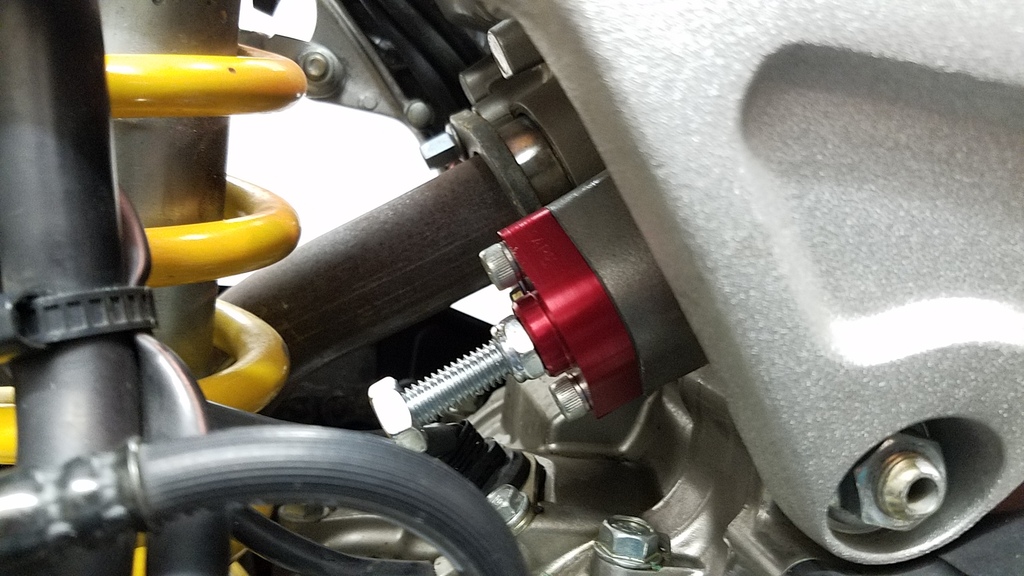

Anyone know where that one hose went? The one in the middle.

Sorry Ion, I can't tell which hose you're referring to. Here is a link to the service manual that you can download, lots of good diagrams for hose and wire runs near the front.
https://www.dropbox.com/s/wnh696qph5...1000F.pdf?dl=0

That one goes to the "gushes", IIRC

My SOP is trolling for laughs, BTW. I know where the hoses go.
And factory service manuals look so much better with dirty fingerprints in them. I don't think the one that came with this lovely machine had ever been opened.
How do you think this bike would perform with a 200 cm swingarm mod?

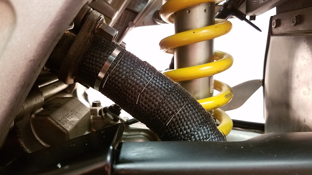

And don't let your mom catch you looking at this one:

That makes my formerly clean and tidy VTR look filthy by comparison. Beautiful workmanship on the pipe wrap Ion.

Thanks! It was my first time wrapping and getting it uniform in that small space with my big hands produced cursing and bleeding. Not to mention I forgot to wear gloves so my hands swelled in reaction to all the embedded fiber glass. I may try again since it will be up on the stand for a few more days. Also, apparently there is a silicone sealant one is supposed to apply to the wrap, but it only comes in a spray can, and well, that looks like it would be a mess.
Has anyone applied the sealant before wrapping?

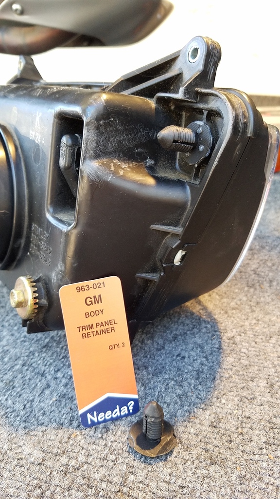

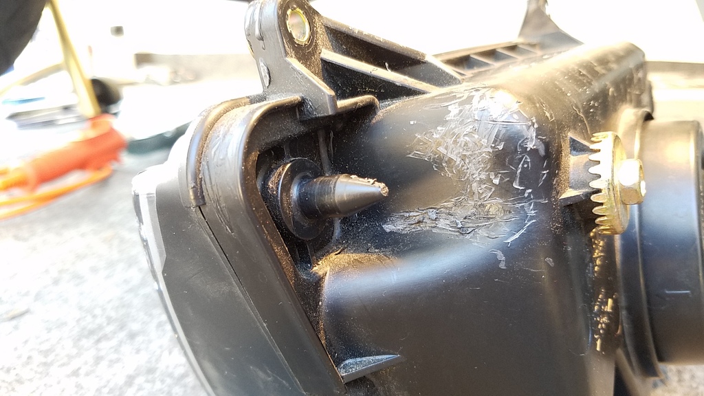

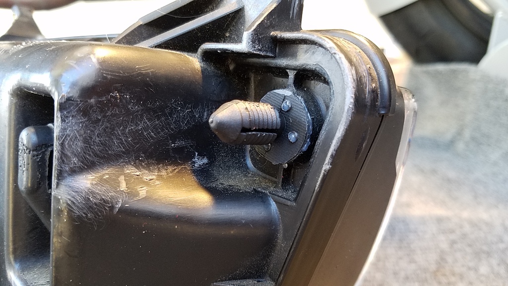

Fabricated a new location/support post that previous owner broke off of rear headlight assembly. I hope it holds up! Materials are off the shelf nylon trim panel retainer re-purposed by using a hand drill to lathe, mill, and drill to specs, and plastic adhesive. Prep was with tungsten carbide milling/shaping tool on Dremel.
Good but molested side for reference:
Restored side:
