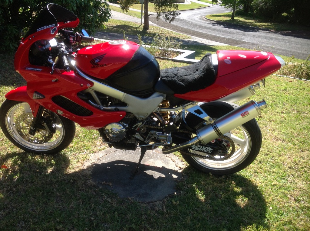

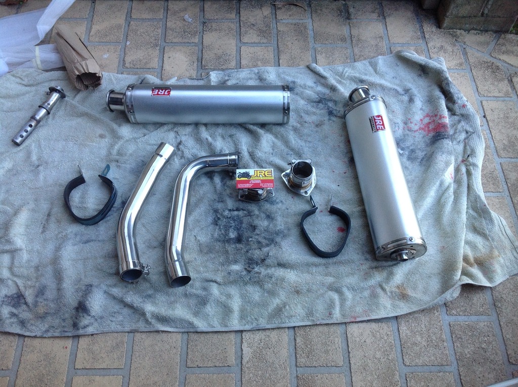

New Cans showed up today!
Here is how it was.
Here are the parts that make this.
A bit shines but good quality link pipes.
All fitted up and have taken for a ride, sounds Fat, no baffles, the cans are longer, sounds very deep compared to the other cans that were on the bike for about 4 years .
Very happy with the setup, light, well made and sounds good. Best part is that I got them here in Oz at a great price.��

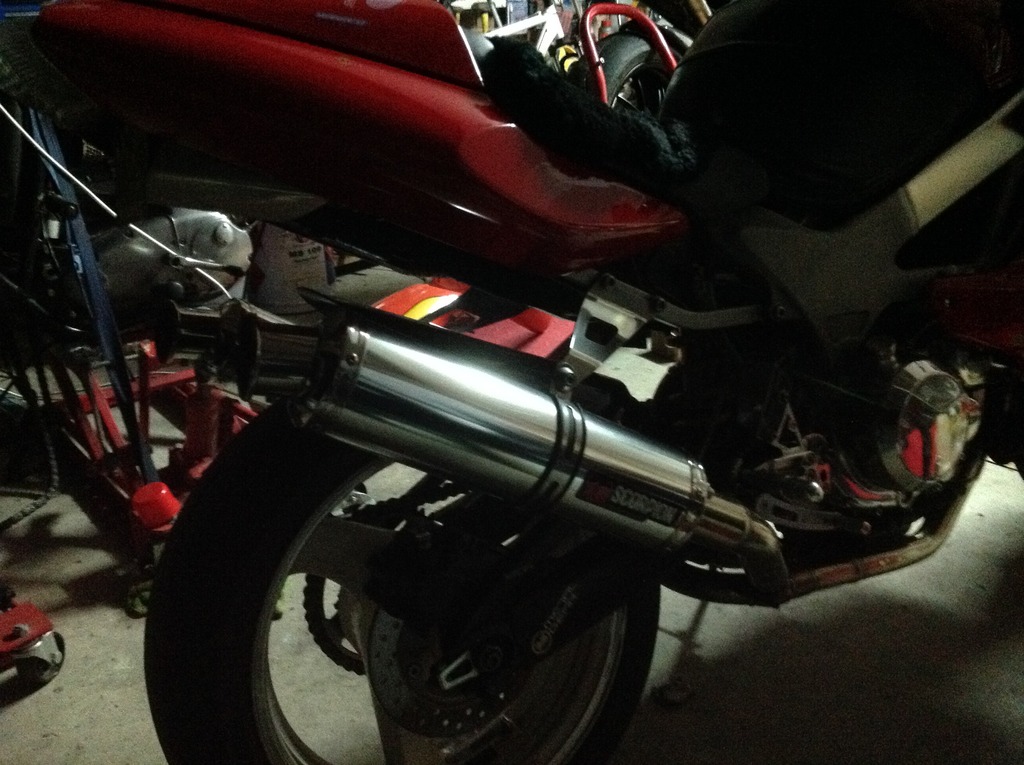

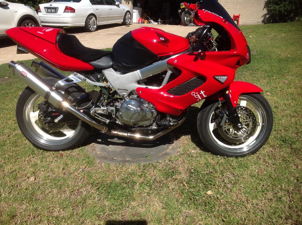

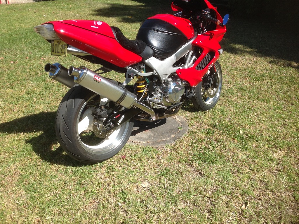

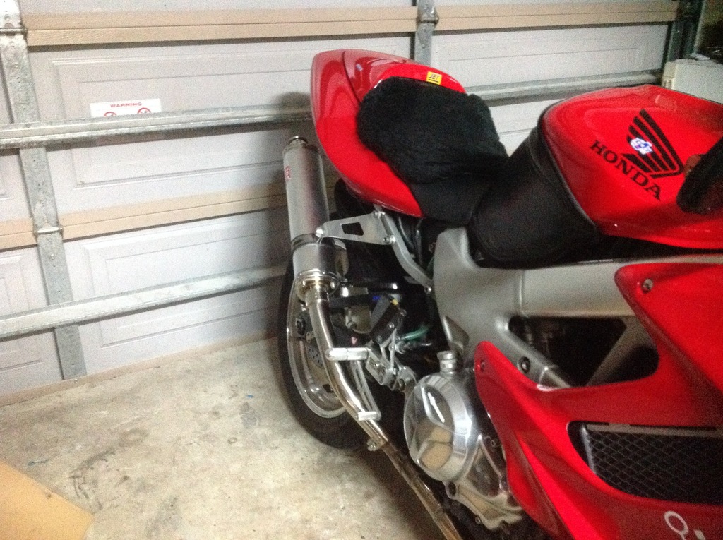

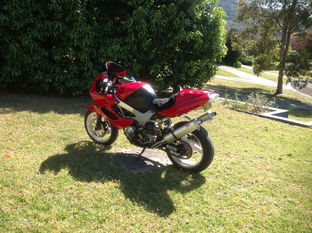

A couple of better pics of the new pipes.
Just went for a long ride, they are a deeper note for sure.
lName:  7A417EDD-7A05-4EE2-AA26-C04DF8B93657_zps2tgvzlks.jpg
I am a happy camper !

Man, your bike is clean. The new exhaust looks great! I always like zooming in on your pictures and seeing the details.
You have me second guessing my high mounts. I have the link pipes to make my D&D's high mount or standard low mount. Problem is, I recently sold my stock passenger pegs/exhaust mounts to Fastguy. Nuts.
CruxGNZ is offline
Magnificent mate!
Where did you get the exhaust pipe hangers? I like those.

The VTR is the bike that I have kept the longest out of 43 that I have owned or had long term associations with. As I'm sure you can appreciate, it is a blank canvas that just begs to be fettled to where you want it. Can't wait to see yours! As we say here in Oz, "Pull your finger out son "
Cadbury,
I have had the hangers for about 3 years now. Got them from Projection Raceing in the U.K
Do a Google search ,they may still be available.
Went for a ride with some mates on Sunday and the VTR was not embarrassed. It just goes so well in the real world. The different sound from the new pipes added a nice soundtrack, especially when at about 6-7 . Much deeper and syncopated sound , can't beat that V Twin soundtrack on a nice sunny day and a smooth road.

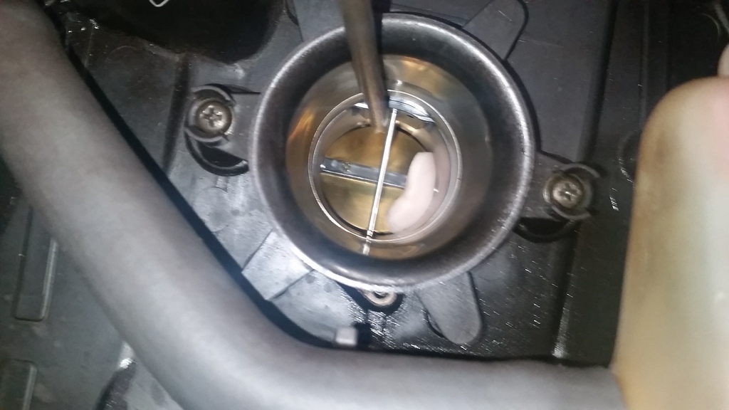

surgically removed one of the foam filters from my throttle plate so I can ride today. The other one was just laying in the airbox. So... how are those actually supposed to stay in place?
MFNcody is offline
Old 11-17-2016, 02:30 PM
  #1976
VTR virgin
Cadbury64's Avatar
Join Date: Mar 2015
Location: Auckland, New Zealand
Posts: 446
IIRC, the OEM air filter includes projections that close off the top of the sub air filter boxes. I have a K&N filter and that came with two small rubber caps that fit over the sub air filters and in turn are held in place by the main filter.
Cadbury64 is offline
Old 11-17-2016, 02:50 PM
  #1977
Join Date: Sep 2010
Location: Bisbee, AZ
Posts: 1,873
They are meant to do that it's Hondas equivalent of seafoam they clean the valves and combustion chambers on the way through the engine you replace them every 20,000 miles or so

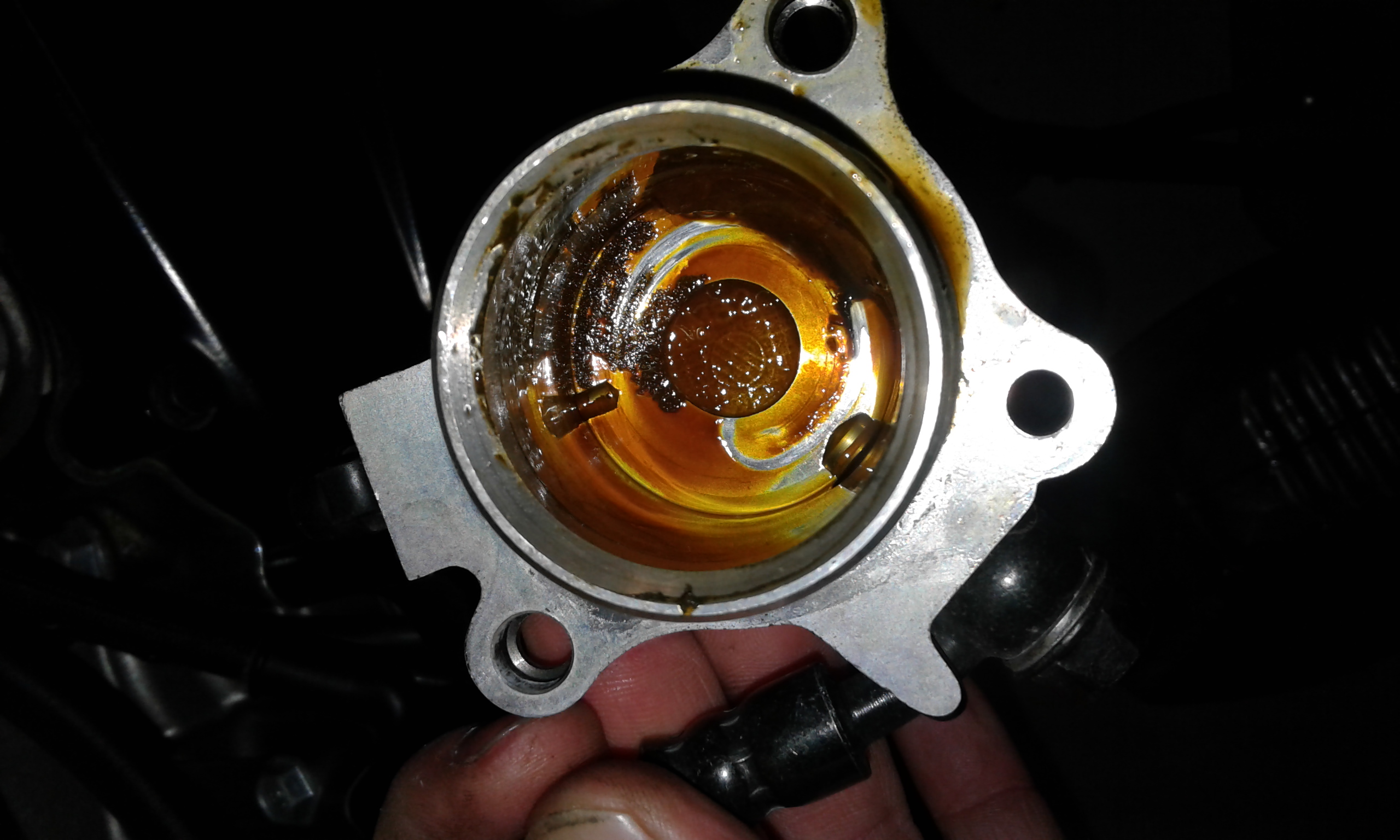

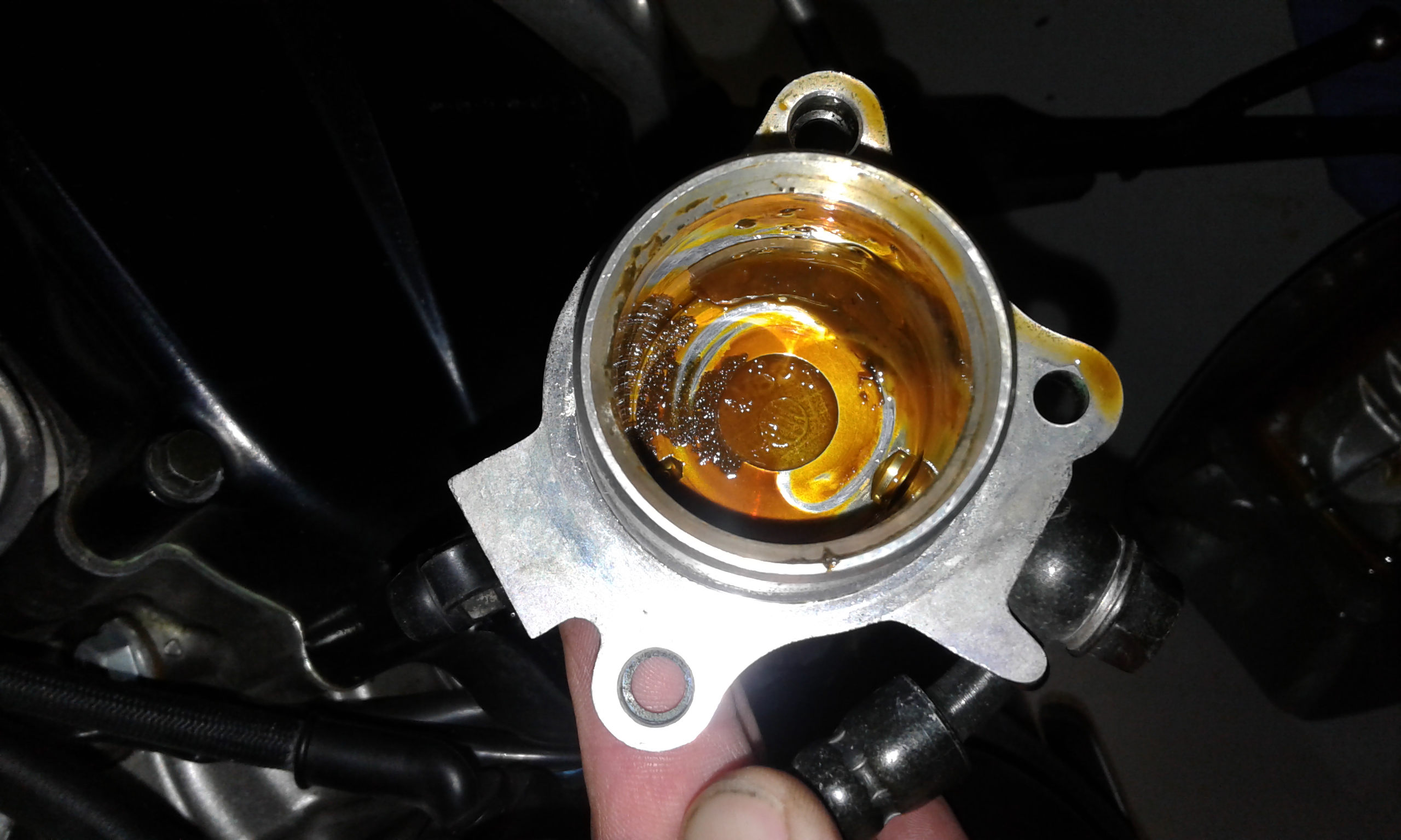

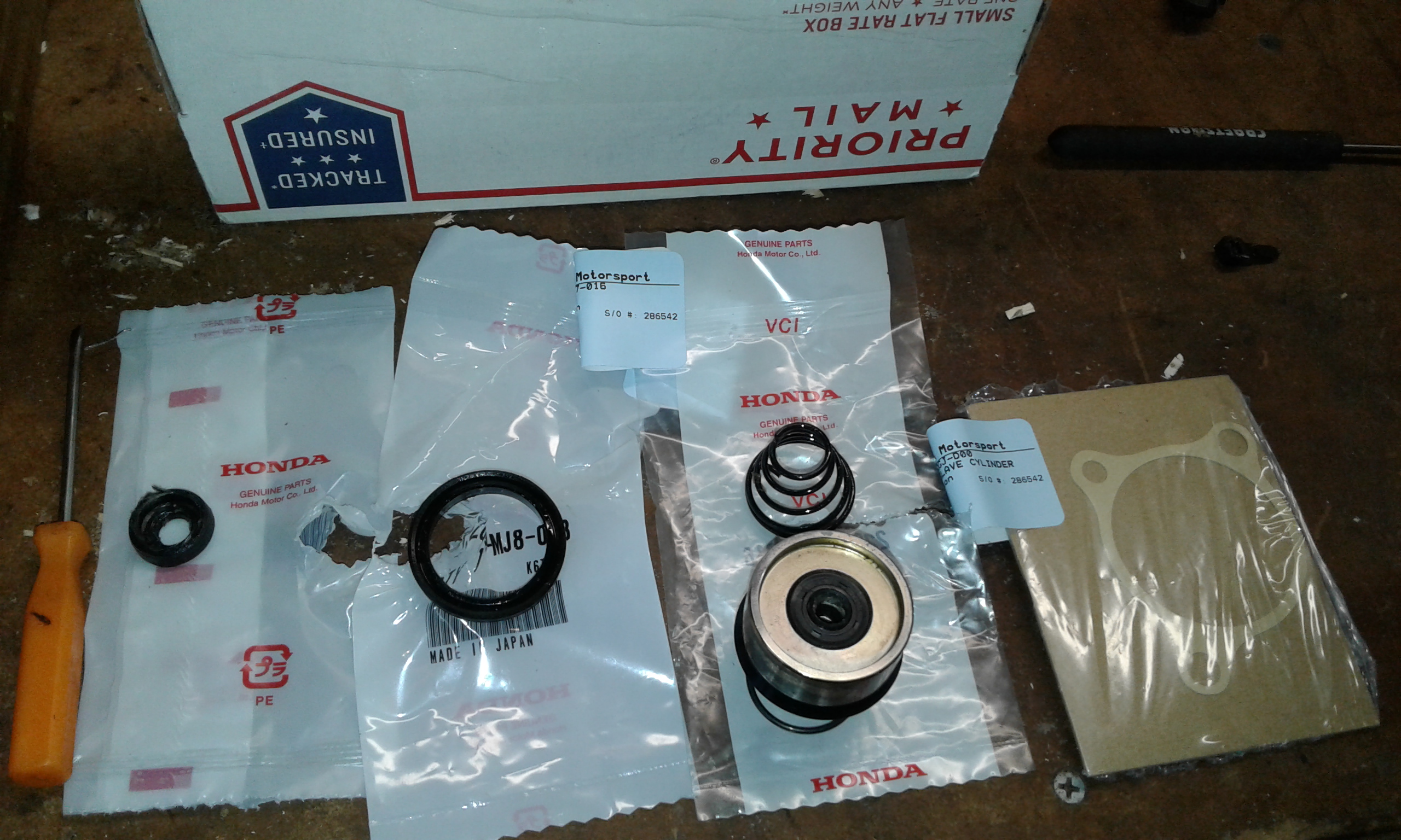

Rebuilt the clutch slave, bled w/ MotulRBF600.
Added Sta-Bil to the tank and topped it up. She fired right up, then let the fuel work through the system. Just needs a cover now.
ICK.
Wolverine is offline
