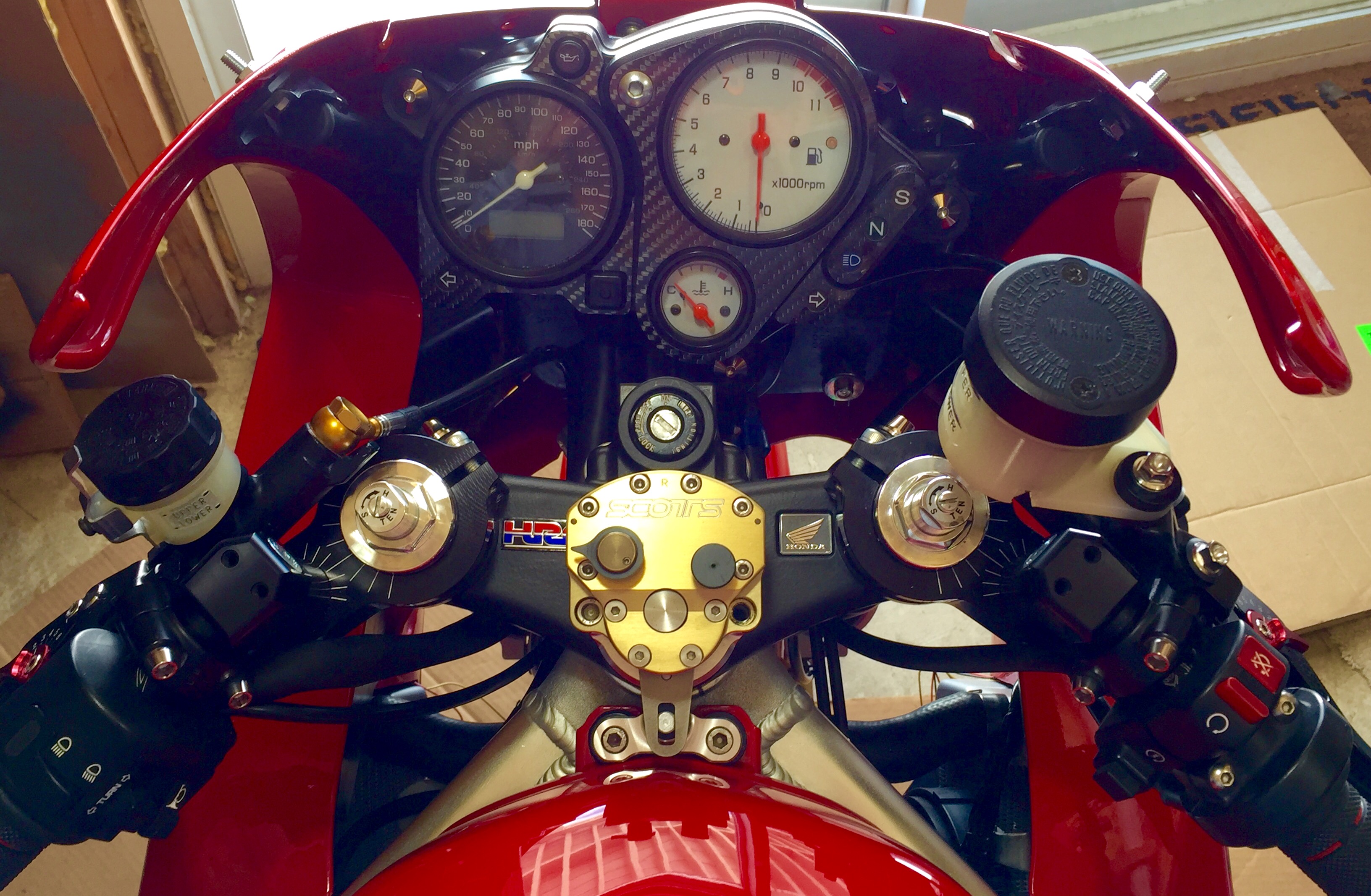

I've been working on the cockpit details almost done!

Very neat and tidy.

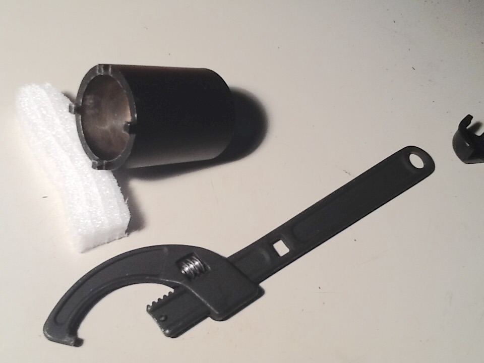

you need a steering stem socket and a adjustable pin spanner
is this procedure in the manual? I don't get what the pin spanner is for.
Old Feb 12, 2017 | 09:24 PM
  #2052
The spanner is used to adjust the bearings.
When I did mine I fitted tapered bearings and adjusted them after about 300 Klms to get them right as they were a bit loose after riding a couple of times.
No problems since.
Also be aware that you best adjust the bearings with the wheel off the ground and you are aiming for no movement when you grab the forks and that the bars fall easily to the right and left.
The tapered bearings made a huge difference to my bike.
What make are the bars? How does the angle off horizontal feel? Is it more than second gen stock bars? Inquiring minds want to know.
BTW the detail on your build is inspiring.

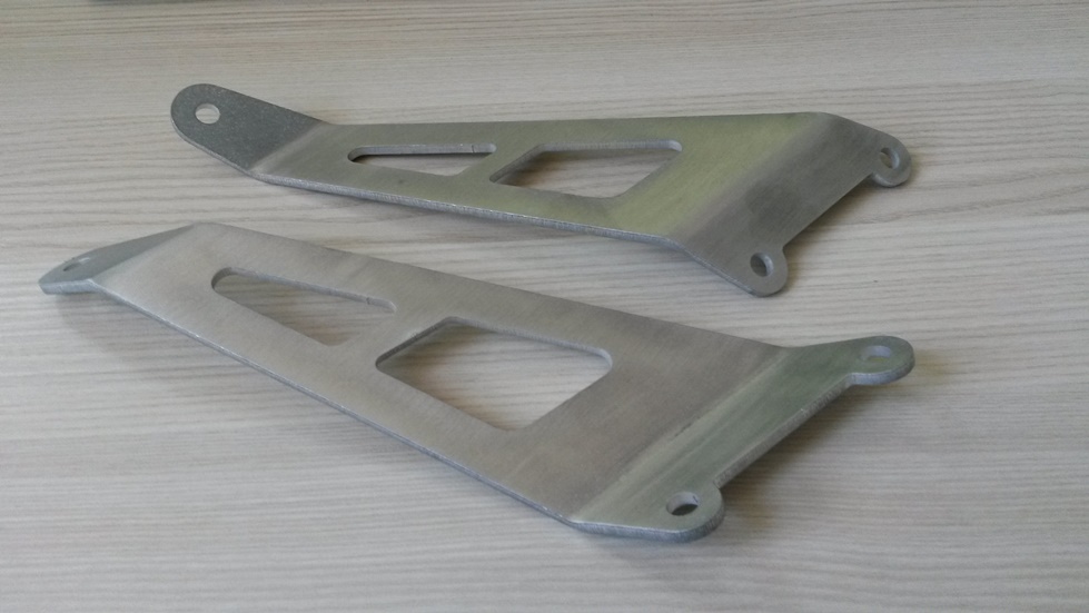

delivered quite fast. Hope it will fit with your nice angle of pipes :-) I am sure there will be nice weight saving too.

Old Feb 16, 2017 | 03:01 AM
  #2057
Thems the ones.
Can you do me a favour and measure how long they are ?
Just curious !
Post some pics when fitted .

Originally Posted by Silverfoxslash
yes I was doing it with a hammer and a drift front lifted up.
I didn't use a special tool either, not 100% necessary. The book says:
STEERING BEARING PRELOAD
Remove the front fairing (page 2-3).
Support the motorcycle securely using safety
stands or a hoist and raise the front wheel off the
ground.
Position the steering stem to the straight ahead position.
Hook a spring scale to the fork tube between the
fork top and bottom bridges.
Make sure that there is no cable, wire harness or
hose interference.
Pull the spring scale keeping it right angle to the
steering stem.
Read the scale at the point where the steering stem
just starts to move.
STEERING BEARING PRELOAD:
1.0-1.6 kgf(2.2-3.5Ibf)
If the readings do not fall within the limits, readjust
the steering bearing adjustment.
Follow up with a recheck after some hours ride time.

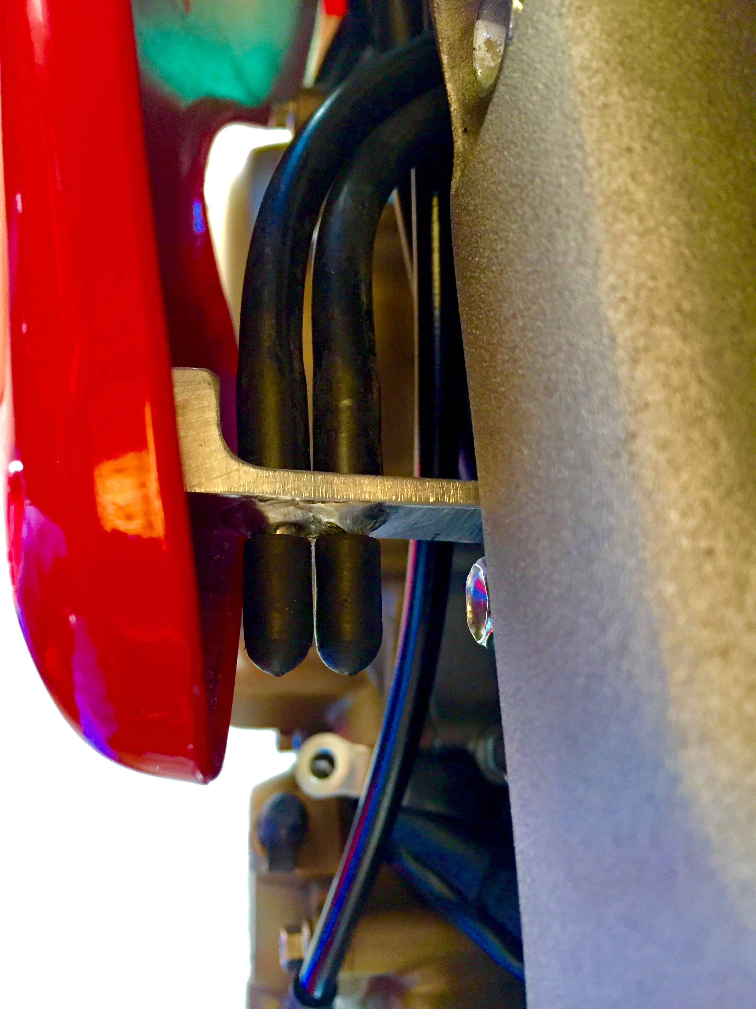

Remote mount vacuum lines for carb balance are sorted out!
Welded into the stay. Nice
Old Feb 17, 2017 | 10:55 AM
  #2061
Fastguy,
That's a great solution .
Your attention to detail is to be admired. At the moment my remotes just lie in the V between the cylinders, but not for long after seeing this.
Old Feb 17, 2017 | 12:00 PM

Originally Posted by kenmoore
Fastguy,
So just a couple of notes: I used 3/16" thinwall aluminum hobby tubing for the two thru tubes. They are soldered (with Eastwood Co. Aluminum Solder) into two 3/16" holes drilled through the lower fairing stay. Be warned you must have the frame side bolt/fastener inserted into the fairing support bracket BEFORE you solder the tubes in, no clearance afterwards... Don't ask me how I know...

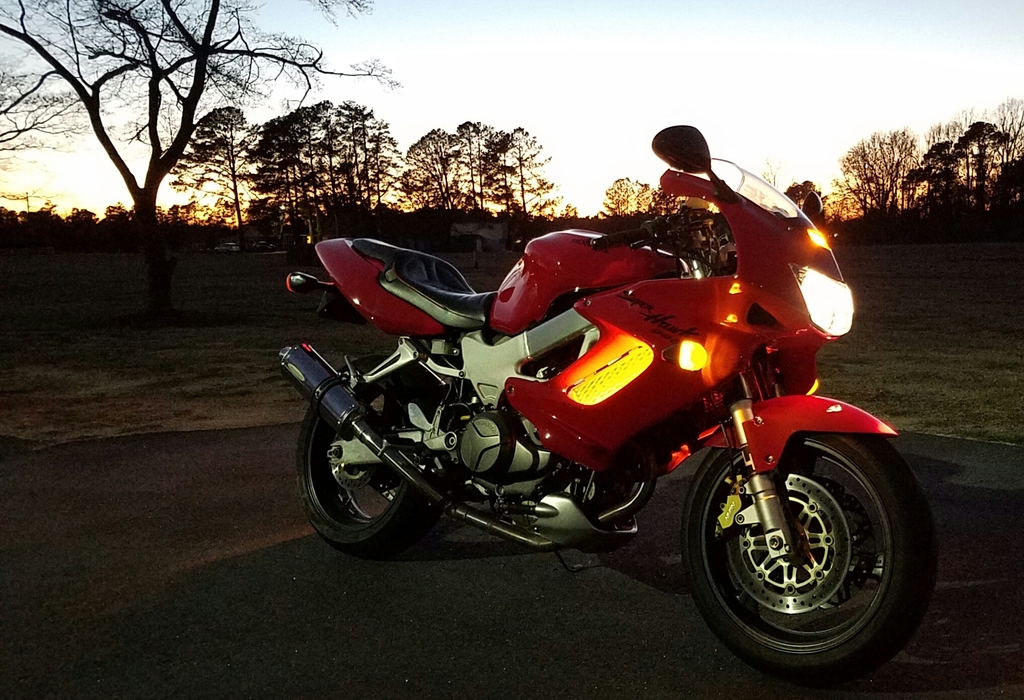

ion is on a distinguished road
Amber LEDs light up the radiators to make them cool looking side markers:
Old Feb 19, 2017 | 07:17 PM
  #2064
Interesting look with the rads but where did you put the lights? Will they survive the hellish temps that happen in there? The fan can barely survive in there.
They're just inside the lower lip of the opening, and they may or may not survive very long. I'm an experimenter!

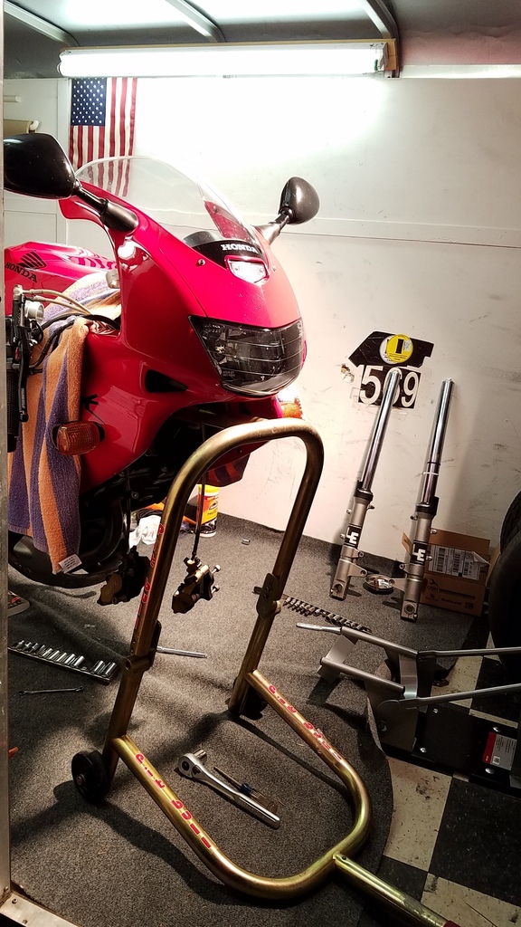

I think they'll hold up fine. Until they don't.
In other news, Imma sort out the suspension now. May be like this for a bit:
