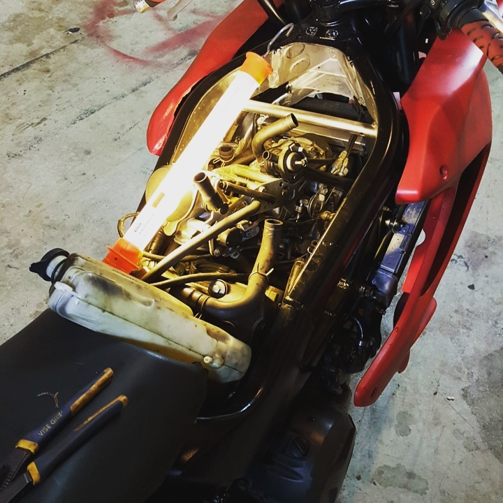

My coolant resivoir was cracked, so I replaced it tonight.Name:  IMG_20151211_205518_zpsinihg3dg.jpg

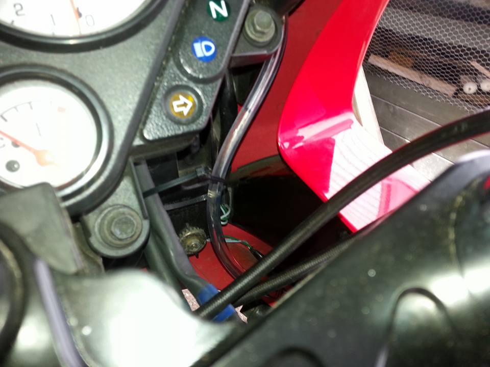

Made a functional fuel gauge for my 98.
This morning i will get some bits to make it look better.

Was looking for a fuel gauge idea for my trail bike. Always worried on the trail Im going to run out. Found out how to make a sight gauge. Stupidly simple.
So decided to try it on my VTR first. So wont like the idea but I do.
So you cut one of the fuel lines to the carbs. Insert a T joint for a third outlet. Run clear tube from the joint clear of any hot bits through the fairing to go up by the clocks. I run it over the clocks and back down the other side of the fairing. I put a restriction in the end to slow down the motion of it.
It really works a treat. When I get more time I will drain the tank to get a low point. It only works when the engine is running as thats when the petcock is open. If the bike falls over it can only leak what is in the pipe.

All it is is a 3/8 T piece and 2 meters of 6mm clear tube.

Yeah ok, That needs some work. Works fine until you boot it and lay hard into turns. Then fuel runs out the end.
The fuel moves way to fast. So have put a restriction in the hose by the T piece with a 2mm hole to slow the flow.

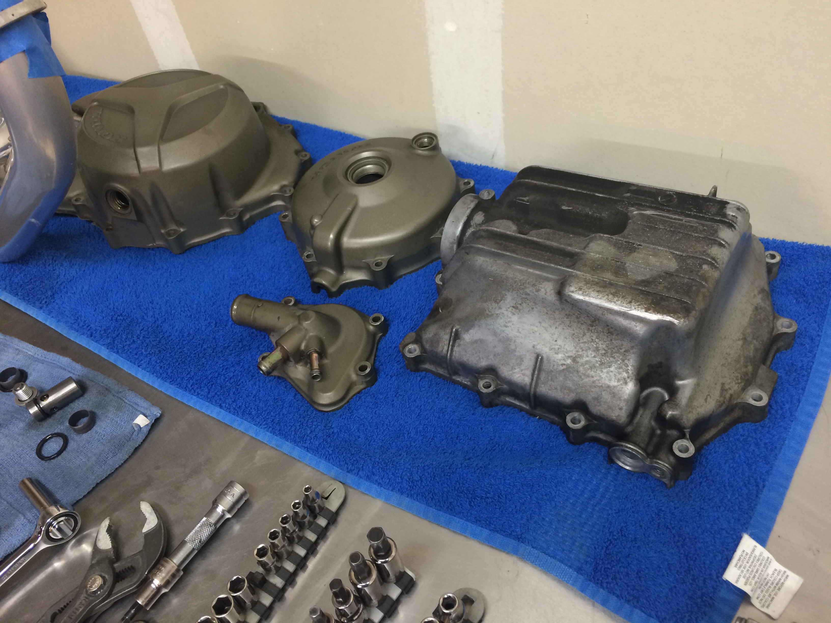

Last night i started the parts removal for winter powdercoating...
James

What colour are you doing the parts in James?

Flat black for all these engine pieces, same as the frame and swingarm.
The only thing gloss black will be the wheels.
This will get rid of the weird goldish color and continue the red/black scheme.
