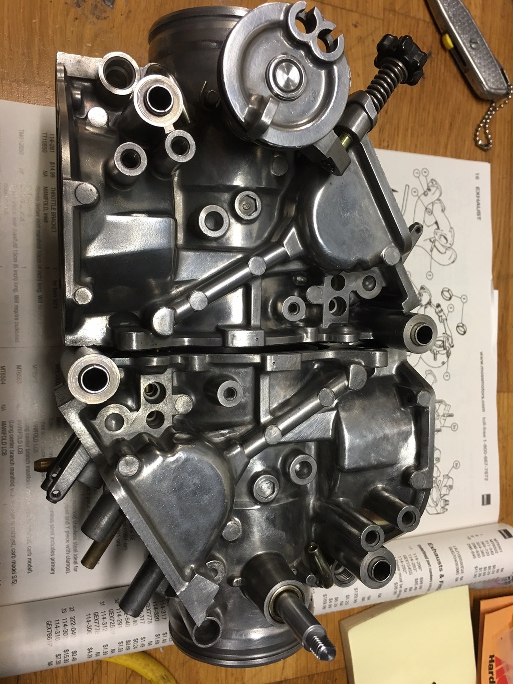

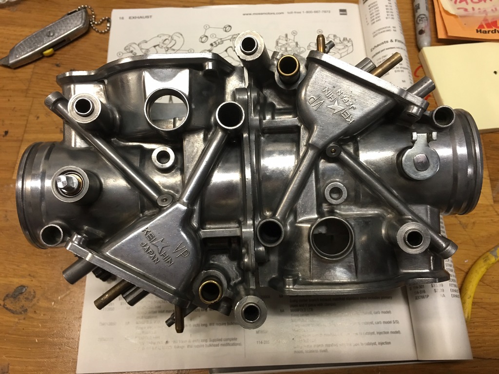

Spare Carbs
3)began overhauling spare carbs
Same here. But I'm getting a little carried away with external cleaning. A dremel tool with a micro wire brush works well.

OK now I have carb envy 'cause mine aren't that shiny. Dang! another item on the list. I am going backwards...

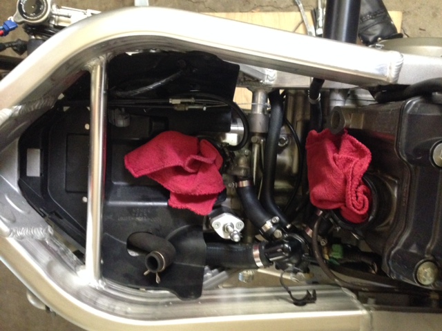

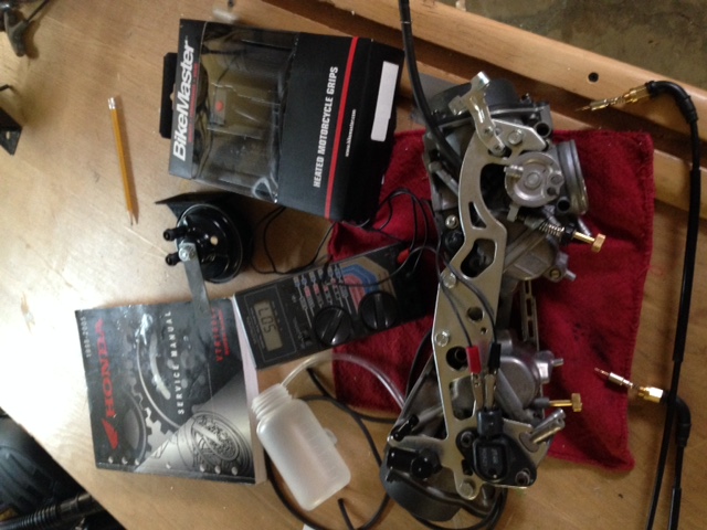

Continuing on with winter mods...
1) Finally got front suspension down to Post Office for shipment to Jamie
2) Finished OEM carb mods with Jack Flash extended idle screws and brass choke fittings. Re-cal'd TPS closer to 500 ohms.
3) Admired all the space for my big hands now that the stock coolant overflow container is removed!
4) Started scheming install of heated grips.
Attached Thumbnails What did you do with your SuperHawk today?-img_1810.jpg   What did you do with your SuperHawk today?-img_1809.jpg

Those carb assemblies look pretty damn shiny to me.
Besides the cool "Jack Screws", what set up did you use on those?
What kind of heaters are you looking at? I'm going to try some that go under my existing grips, because I like them.
Old Feb 9, 2016 | 02:28 PM
  #1696
CrankenFine's Avatar
Posts: 1,481
Besides the cool "Jack Screws", what set up did you use on those? ]
No setup - completely stock except for the screws. I have another set I have been using with a setup recommended elsewhere on the forum (https://www.superhawkforum.com/forum...-set-up-24769/) Performance wise that setup is very satisfying to ride with Dr Honda stacks, but fuel economy is lacking. So I am going back to stock carbs to see if fuel economy can be improved. With easy access to thumb screws experimentation should be much easier.
If you look above the pic of my carbs you can see them in the box. Bought from Amazon on the recommendation of a fellow local rider who recommended them. They are a complete replacement of existing grips.

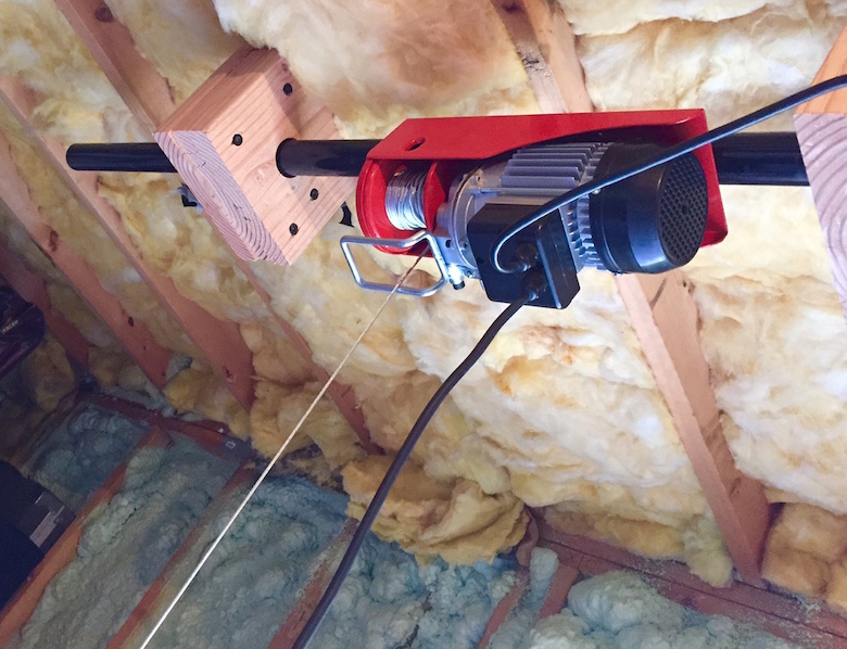

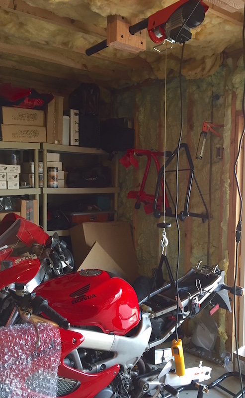

Today I'm building a ceiling mounted rig to hoist up the rear, so I can remove the stock shock, which will be replaced with an Ohlins. While I'm in there I am going to R&R all the shock linkage to check the bearings and relube them if they are OK. While it's airborne I'm also going to remove the stock exhaust, clean the entire rear of the engine, then replace it with the SS TBR exhaust I purchased from Captain Chaos. Hopefully everything will be done by next Sunday! Then it's on to the engine, valve adjustment, manual CCT's, plugs and a coolant change out.... I need this done by May 1st, but the list just keeps getting longer, sigh...
Attached Thumbnails What did you do with your SuperHawk today?-hoist-only.jpeg   What did you do with your SuperHawk today?-sh-hoist.jpeg
