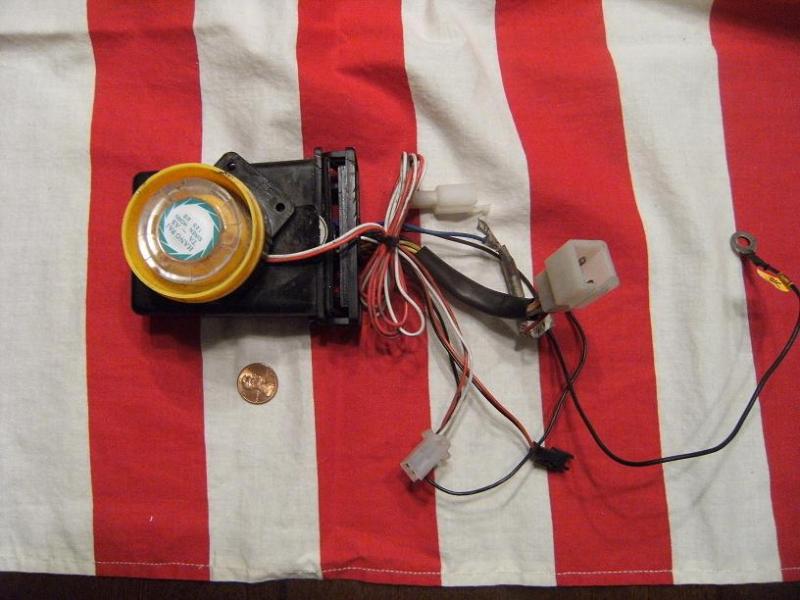

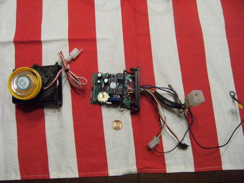

Effin Co-worker!!!!
Thinking back on what changed from my bike running great on the way to work,to running like **** on the way home,I remembered someone telling me that a co-worker kept kicking the underside of my rear fender with his steel toe boot to trip the alarm.
I will confront him about this tomorrow.
He rides a Harley and there has been some minor joking between both of us about our taste in bikes,but I never touch a bike that is not mine ....let alone kick it!! WTF!
So while cranking the ignition I tapped on what I think is the ICM with a screwdriver, which happens to be right at the rear fender where the douche bag was kicking, and lo and behold I get intermittent spark.
So i think I need a new ICM as I do not see any loose connections or solder joints. I bet a relay or something is toast now!
Question#1 Do I make him pay for the new part?
Question #2 Can someone tell me the actual part name/number?
The manual is a little confusing as the picture shows nothing for a 2002 where this part is located (right under the seat locking mechanism)
Attached Thumbnails Lost Spark in Rear Cylinder-dscf2833.jpg   Lost Spark in Rear Cylinder-dscf2834.jpg
