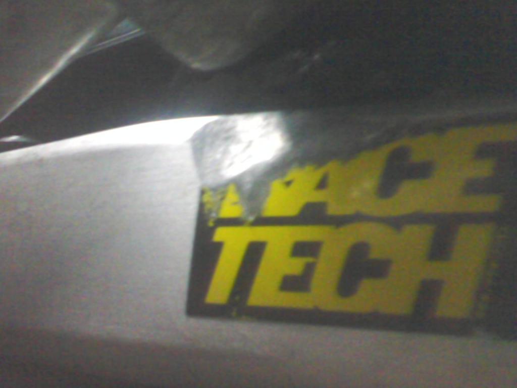

I tackled the job today. I set that shock in to find out that the spring hits the swing arm. I had the upper bolt not come out completely. Is this the normal? Put in the stock shock. I also found that the exhaust cans have been rubbing the swing arm for a long time. I may want to change it out and get the high pipes on it. I hope that the swing arm comes out easily.
That is only because the shock you are trying to install is not even close to being able to work. If it was modified to be correct for your VTR it would be just fine.
