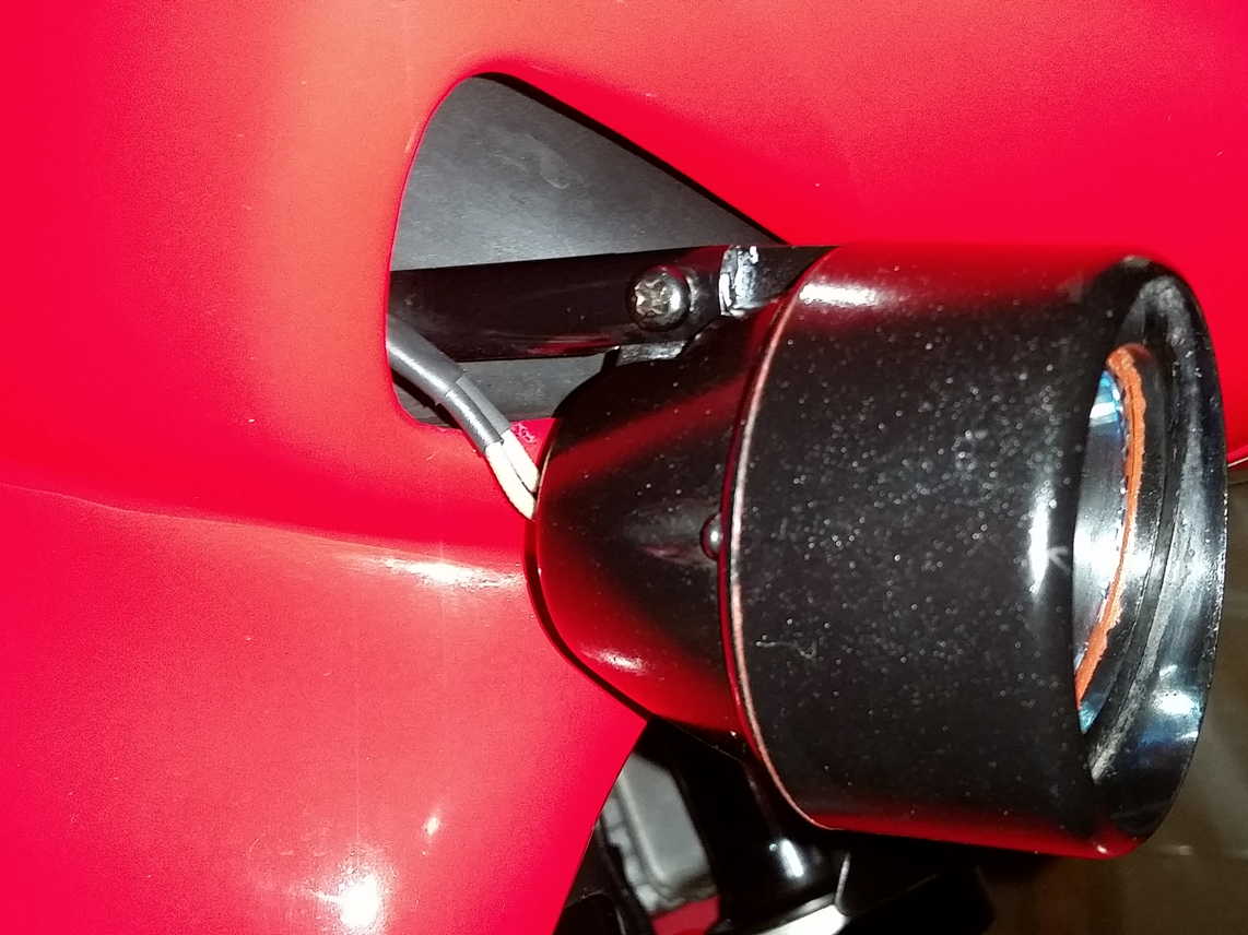

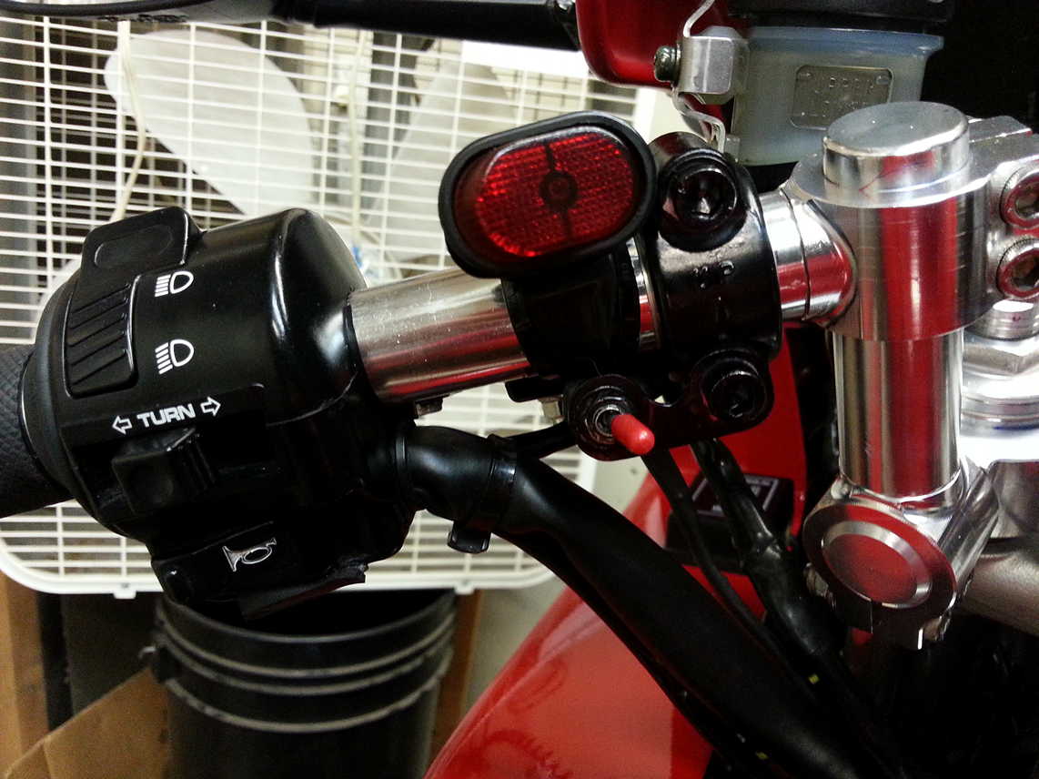

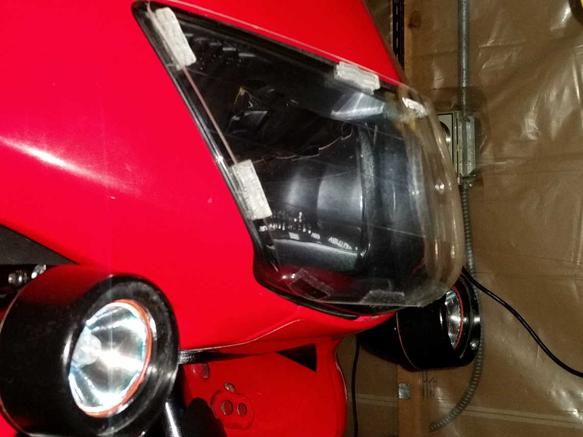

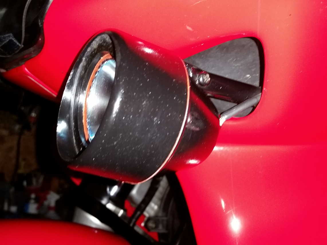

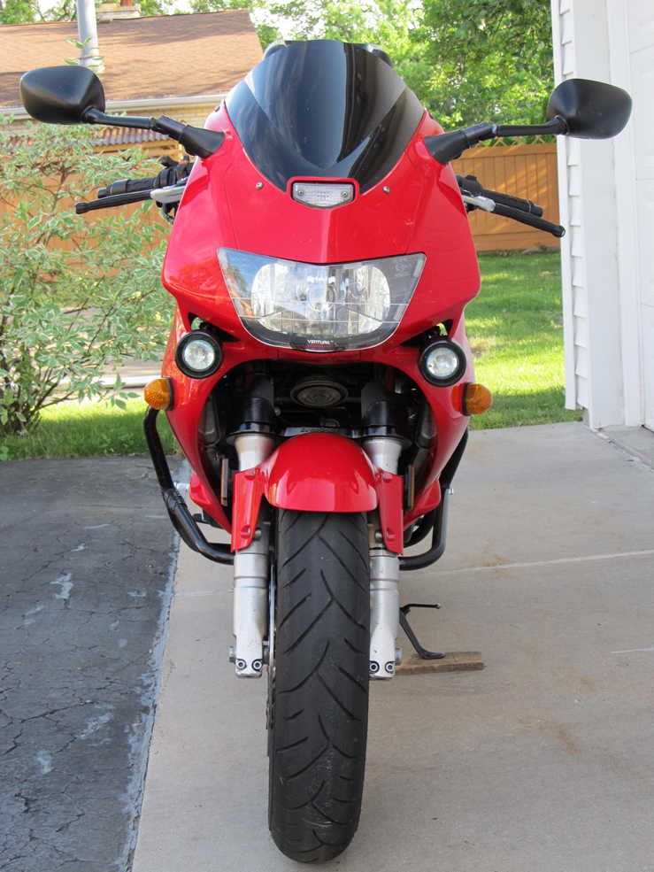

Driving Light Mounting Design
I installed twin 50w halogens a dozen or more years ago but the way I mounted them is what I'm sharing. I want to replace the lights themselves with LED units but have not found any as small, light weight or with a beam comparable to the halogens that will adapt easily to my mounting tubes, and have evaluated many including the Clearwater offerings and am still searching.
Im not seeing the issue?? Most any of the lights I have installed (more than a dozen brands or models) would install using the mount you have, or a slight adaptation.
Waiting for a Direct bolt replacement light onto a custom mount you made for what is a non industry standard fitment...might be a long wait.
Every light I found was either too big and/or too heavy and Clevis system they used was not adaptable to the very compact slotted tube with a single through-bolt that I have which is right into the nostril of the fairing everything else hangs down too far or projects out too far and was not adaptable to date

The way you have mounted the lights is what I was thinking.
I have nothing against halogen lights.
I wonder if LEDs are really that much better.
Thanks once again. Your pictures have been a great help in so far as I now know that I can mount them through the air inlets.

Maybe you can see these sketches better
Check out these incandescent DL which use a standard H2 bulb but IMO are too heavy to cantilever out the fairing nostrils without a secondary support for the strut...
