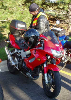

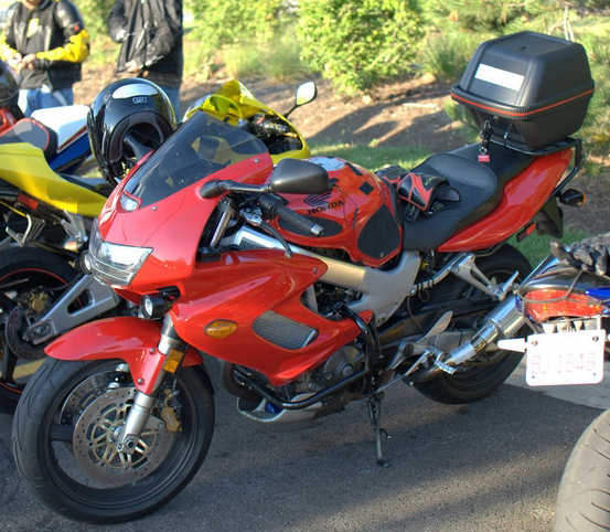

Check my VTR out. I added these years ago along with a Sylvania BriteStar H$ in the head ligt. The tinzies are switched by an aluminated rocker inboard of the highbeam/horn pod. Everyone who has commented thoght they were neato & well done. Even with my tailtrunk I still don't get mistaken for a Wing.

Actually yes...very nice.
Any pix of mounting....brand

I frabricated the mounts & wiring loom myself. The lights themselves I bought for like $20 at Pep Boys or JCW many moons ago. The key is finding lights with a "female" clevis. PM me & I'll send you a sketch of the installation. MoonLights aatch to the forks & other mfgrs sell better lights with the femail clevis, you just have to look around.

skokie... I can't believe I'm saying this ... but those light actually look pretty cool the way you mounted them on the 'Hawk
