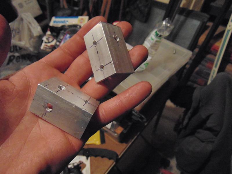

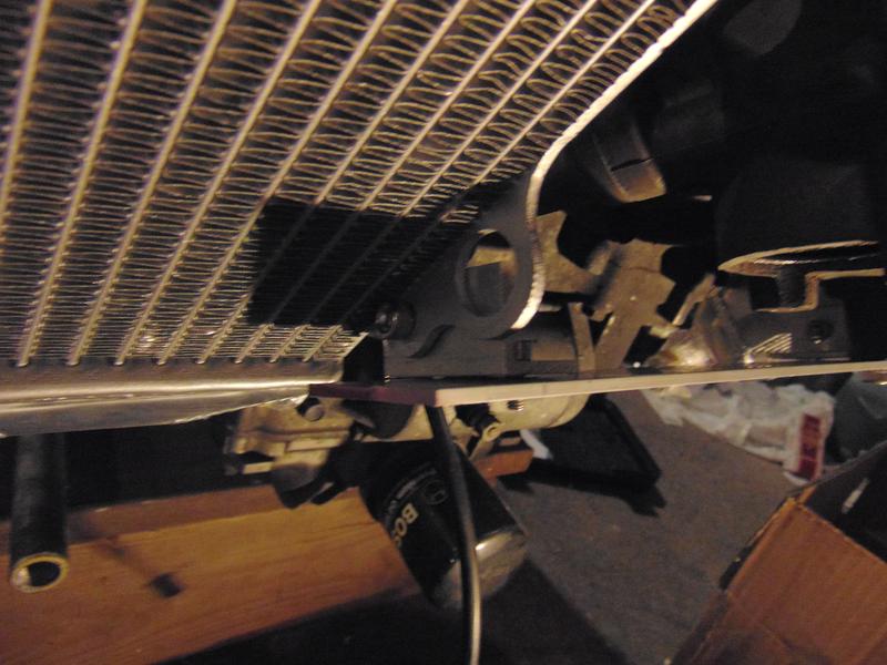

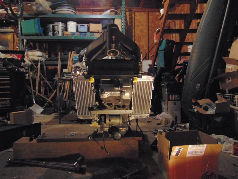

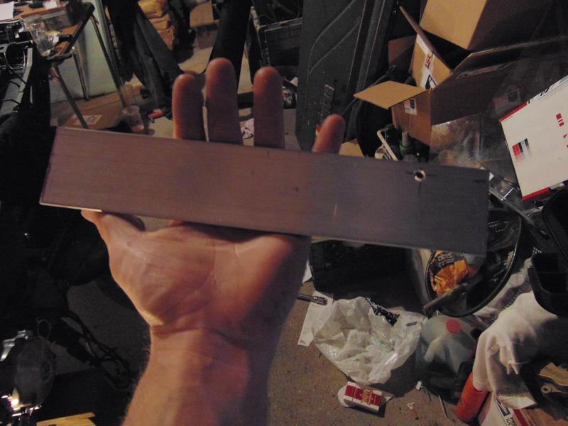

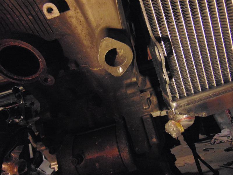

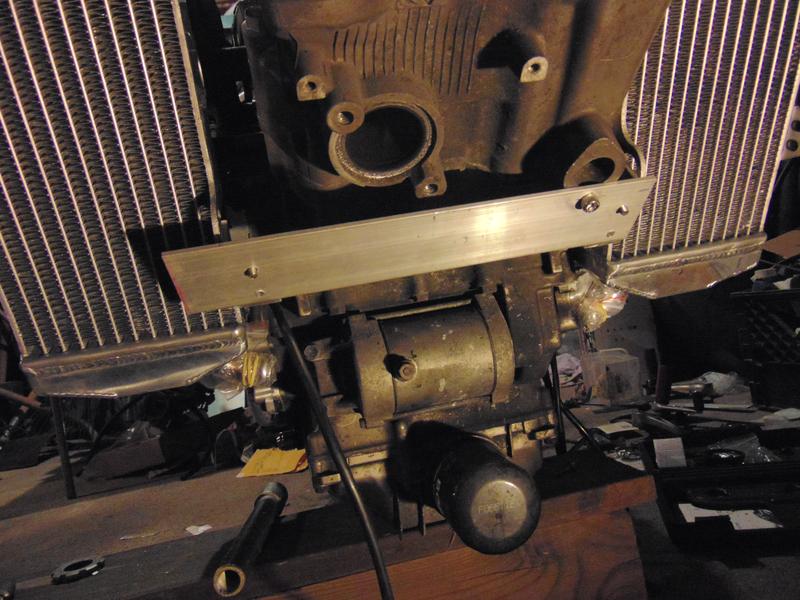

Tonight I finished up the lower radiator bracket. Had to drill and tap the head for an M6 bolt, made up a cross brace, positioned the rads where I wanted them, made up angle brackets for each side and I am now sufficiently satisfied with the sturdiness of the rads.
Next step is to cut down, remove excess and clean up all the cooling system brackets as well as cut down the lower oil cooler mounting tabs. I have thrusday off of work so I should be abkle to get that done by thursday.
All I'm waiting on now for the oil cooler is 2 45 degree AN fittings then I can finallize that project. As for the coolant system, I'm waiting on my hoses, and still need to figure out how I'm going to reduce the 2 1" outputs of the mechanical water pump and thermostat housing. I also need to find a suitable reservoir and fit that up... I gots ideas

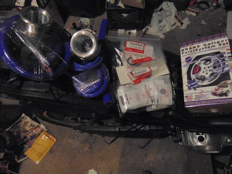

I also recieved today and yesterday, my Vstacks and caliper paint... I should haven all my rebuild kits for the brake and clutch systems tomorrow so hopefully soon I will have those done as well
So I gotta get my *** in gear and finalize these rad brackets, hoses a waitin...
Also the biggest bag of OEM seals and parts I have ever seen,
I have tomorrow off so hopefully I can get my lazy *** out of bed early because I got a ton to get done and I'm not waiting on parts right now, parts are waiting on me

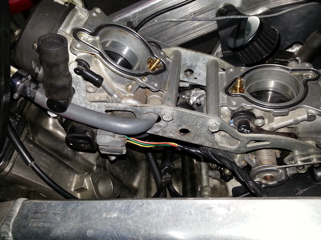

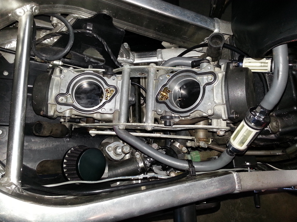

Like this?
I was planning on a catch can, but 8541Hawk, who has done the same thing as the pictures below, hasn't had any problems, besides wiping off a little oil mist now and then near the filters.

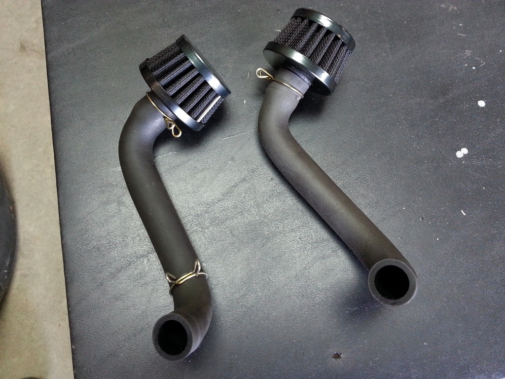

yea I was originally planning on using pod filters but seeing as I'm still trying to figure out what I'm going to use for my coolant overflow, the idea of using an oil catch can seems like a good idea so maybe running 2 for symetry, one for oil one for coolant might look cool...
Old Jun 10, 2015 | 09:34 PM
  #200
scottiemann's Avatar
Posts: 1,252
From: boston
do those pods have check valves in them or are they just standard pods?

or scratch the symetry plan... run a mini catch can where the PAIR valve used to be...
Old Jun 10, 2015 | 09:50 PM
  #202
Just standard filter pods and in the last 800-900 miles, I have honestly seen zero oil mist or drips to clean up. I really think an oil catch can is not needed. That saves you some space. I know a lot of you see some oil inside your airbox, but remember, there is no filter media preventing this.
FYI, the stock coolant system only displaces 4 ounces of fluid.
Old Jun 10, 2015 | 10:24 PM
  #203
I tend to agree with you on that, also, the air box is in a state of constant vacuum sucking air into the motor, which means it will also help to suck out some of the oil vapors out of the motor, kinda like a carburetor getting the fuel, to put in simple words.
That will build up oil in the air box.

What are all the genuine Honda parts for?
I run a remote coolant bottle in the tail of my bike, it's a HRC unit and it works well.
Like this?
This is the exact setup im running on my bike.

And the bag of parts is all the seals and rebuild kits for the 3 calipers, 3 master cylinders and clutch slave... rebuilding the front brakes isnt completely necessary but they are still 10 years old. The rear brakes havent been used in 3+ years and are hurting for attention, even though I flush the system and use fresh fluid almost every year, the rear master had gunky milky fluid in it when I cleaned it up and I'm sure i'll see the same in the clutch system being 18 years old... I am also going to be trying out low viscosity brake fluid, normally used in racing vehicles and vehicles with ABS and I feel confident with a fully rebuilt system I wont have any leaks due to the thinner fluid. And if I find I dont like it I can always flush it and run standard viscosity.
