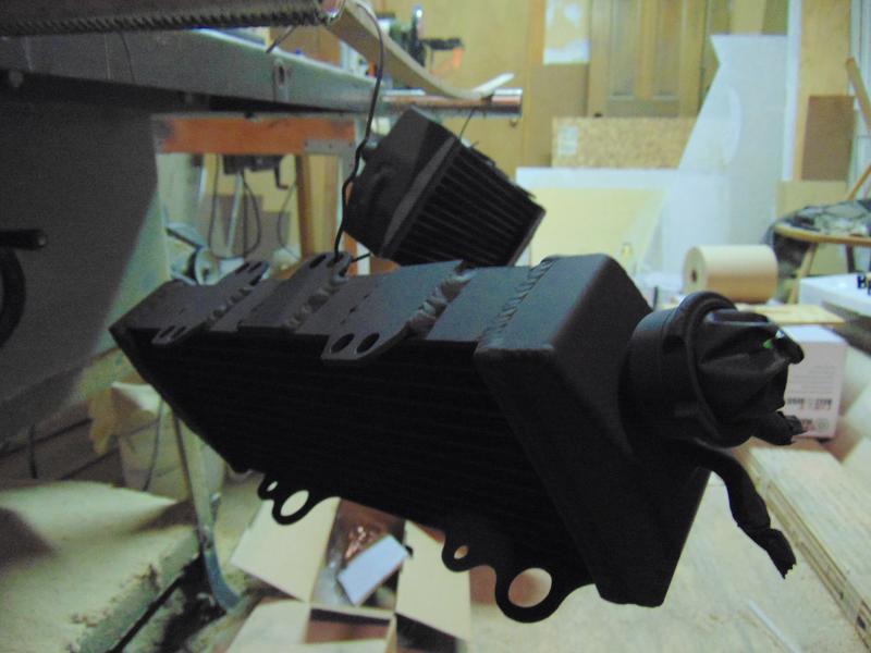

First off I found 1 of the reducer hoses I need, its not cut to length yet but I took a pic of it mounted to show you what limited space I'm working with here and why I cant use anything else for the most part. And Ken this is why I need to mount the pump higher, not lower. I'm still trying to find the other reducer hose as I believe the fitting doesnt exist which would be:
1" T3/4"
3/4"

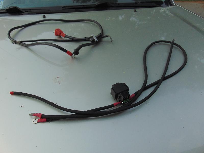

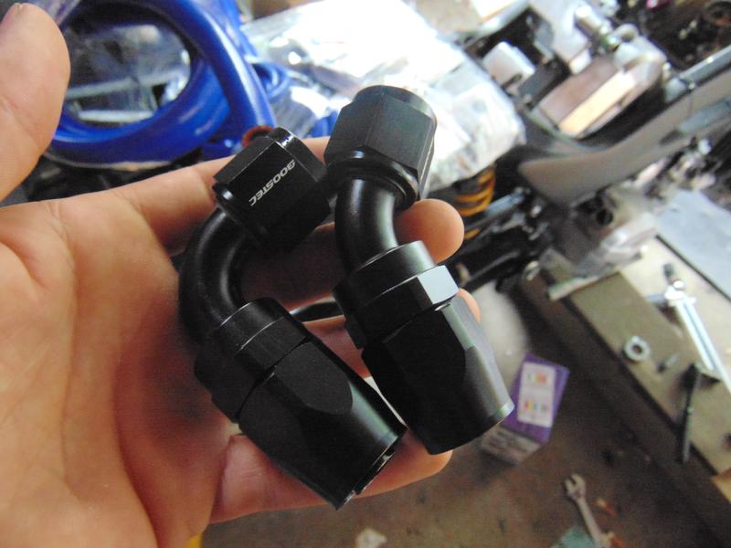

Next up is the 2 45 degree AN fittings I need for the oil cooler side so I'm not hitting the rads with SS braided hose...

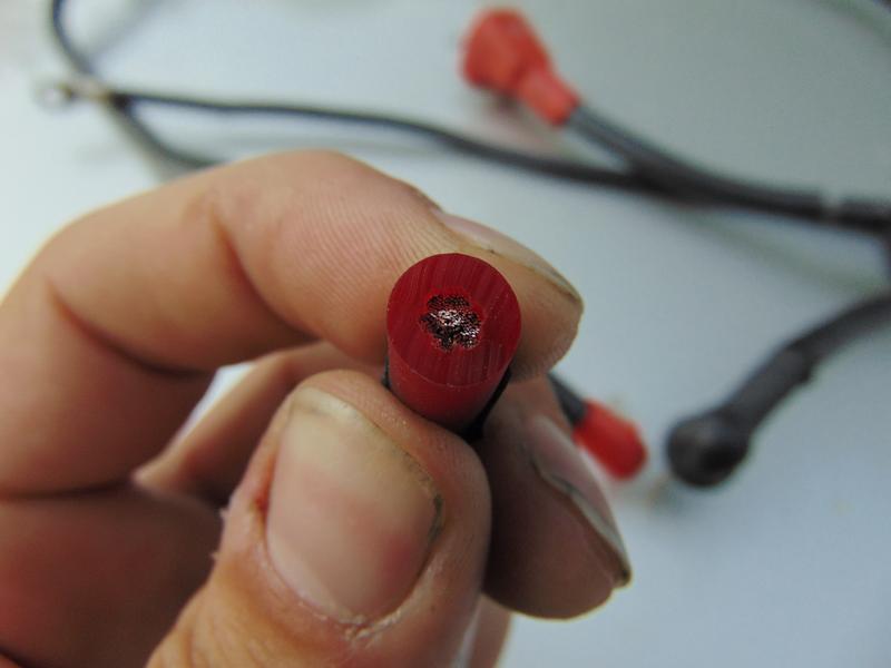

And lastly had my guys at the local car audio place make me up new power and ground cables. High end car audio 8AWG and super conductive, these have atleast 20x the strand count of factory if not way more and the wire is wrapped in high heat protective tape. The high strand count creates an incredible amount of surface area for better conductivity and flexibility. The pic looking down the sheath doesnt show what I can see but I took the best pic I could...
If your wondering why the ground cable is so long and doesnt have a connector at one end, its because I will be relocating the chassis ground and running some type of bus bar for individual component battery grounds. I'm not saying this electrical system will be fail proof but it will definitely be as efficient as it can be...

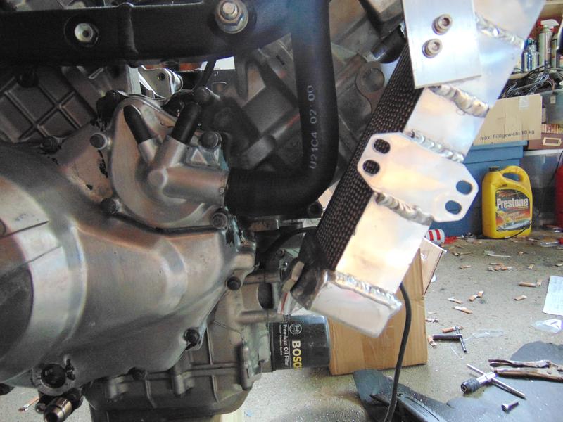

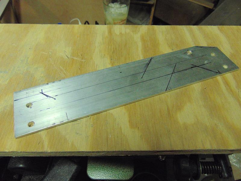

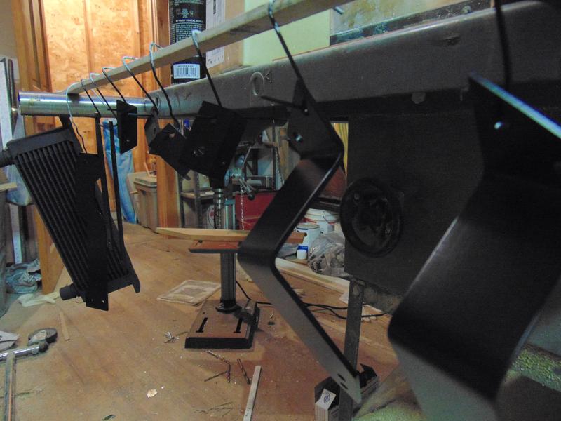

Got some work done tonight...

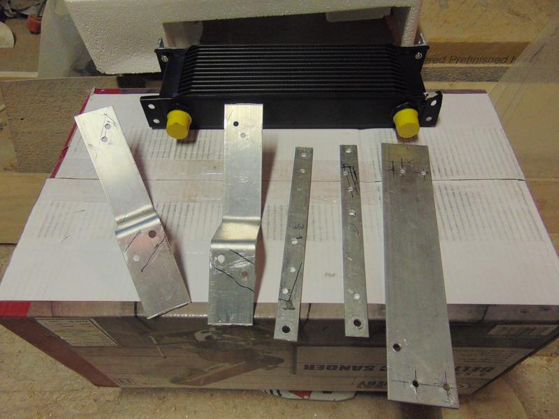

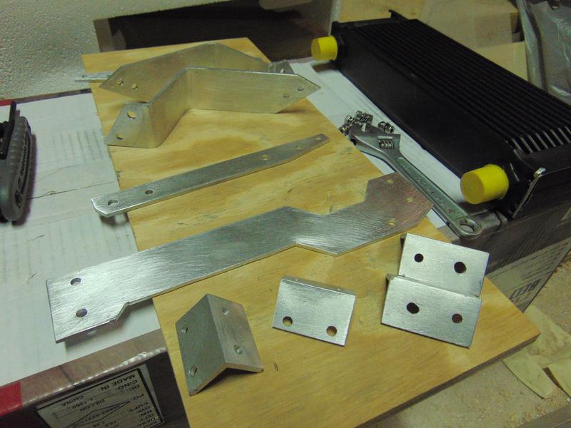

Cut off the lower mounting tabs on the oil cooler. Cut to size all of the brackets for the cooling system. The upper cross bars are almost complete, outer brackets need more cleaning up and the lower bracket needs a lot of clean up. will post pics tomorrow as things get done.

VtwinFr33k is on a distinguished road
I'm going to need your help this winter when I go through this engine, You do impeccable work scottiemann..! Everything is so precise and well thought out, I went through 3 different plans with just my taillights today... LOL
Great job with both the wiring and those A-N fittings.

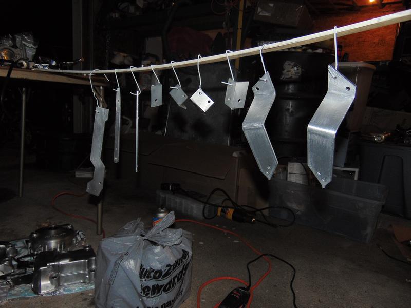

So as usal this weekend was spent with the little man and the lady friend but its sunday night and its back to work on the bike. Funny story... I need to get a new helmet for the lady friend, its going to be white because she is going to bedazzle it anyways, she literally sat next to me for about an hour while wearing my helmet and jacket looking at helmets for her lol
So I tore down the rads and oil cooler in order to trim down and clean up all the brackets and prep them for paint. Just finished that, hopefully I can grab the paint for that tomorrow. I also cut off the lower mounting brackets on the oil cooler as i wont be using them and need to get the paint for that as well.

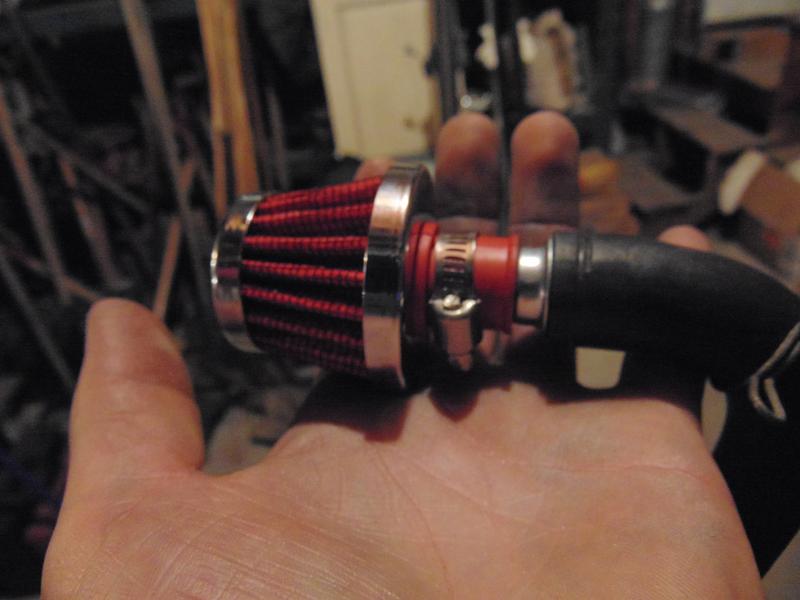

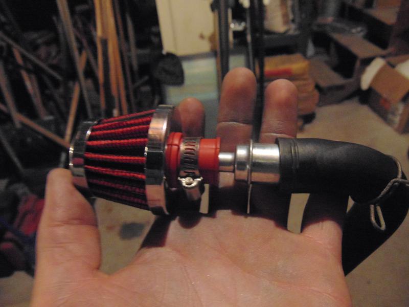

i have also decided I will be running external pod filters for my PCV system, however I live in new england and I will inevitably be caught in a downpour at some point and dont feel comfortable risking the possibility of sucking water into my heads so I went to the parts store grabbed a pair of cheap pod filters and found suitable PCV valves to make me feel more comfortable with that setup...
until I can start reassembling the cooling system I am working on my carbs, brackets are getting cleaned up and painted, blue silicone vacuum hoses, rejetting...etc

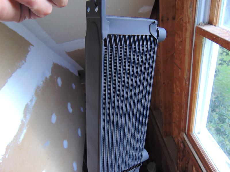

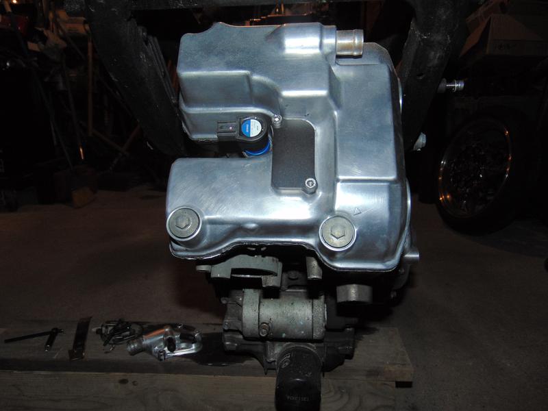

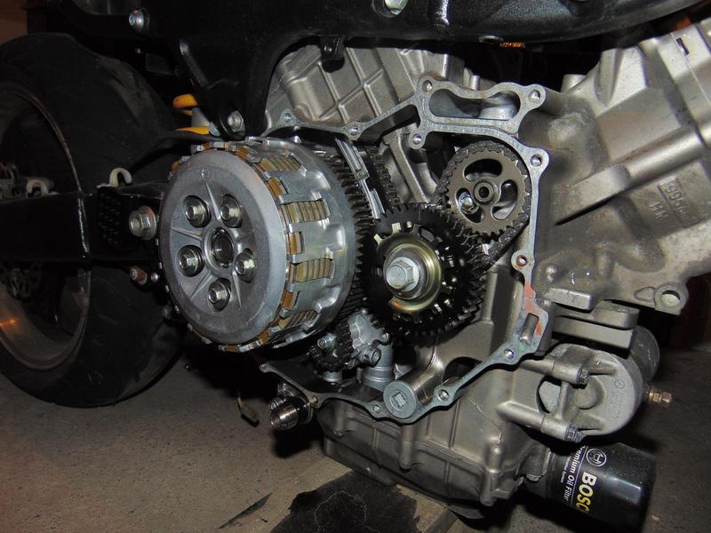

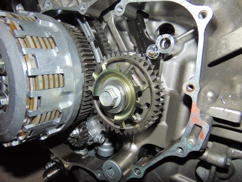

So because I worked late tonight (thank god UPS pays me enough to not care ) I wasnt able to get to the parts store to grab paint for my rads and brackets I have been picking away at other things that need to be done...
Seperated my carbs, brackets are getting paint, waiting on pretty blue vacuum hose, second slide hole is filled and filed smooth.
installed new spark plugs and coils, wont be able to get to the front plug and coil once the oil cooler is installed...
removed water pump cover and clutch cover. for once in my life the clutch cover gasket came off in one piece... I'm amazed I dont have to scrape my life away on the crank case lol
Removed the sub-gear (anti-rattle gear), removed the water pump gear/chain. still have to strip the rest of the paint off both covers, clean them up, brush them up and throw some polish on them... I'm contemplating painting them again as I just remembered I have a bucket of etcher that I completely forgot I had last time I painted these. not sure what to do there...

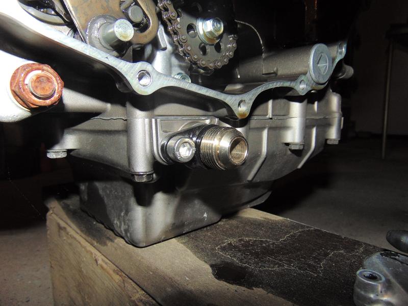

And a lil pic of the oil cooler engine side connections...

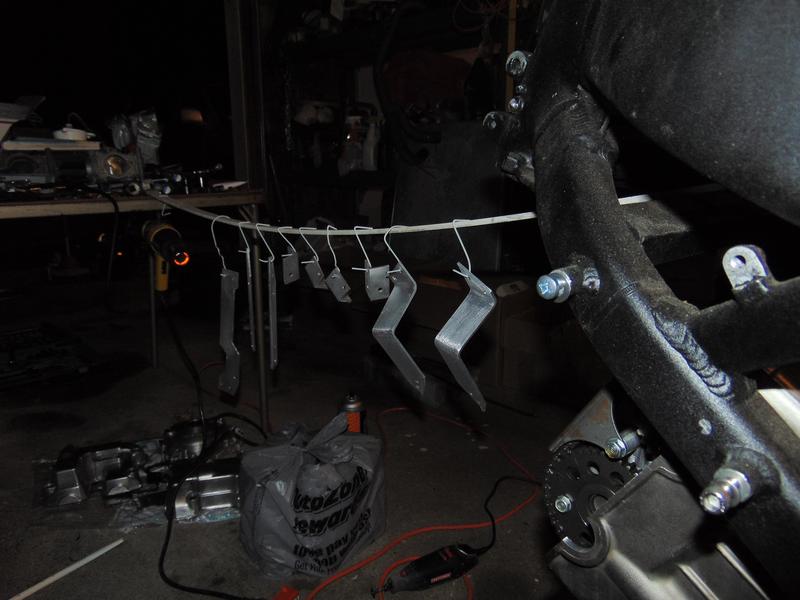

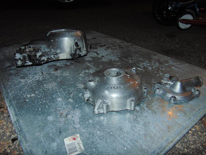

From: boston

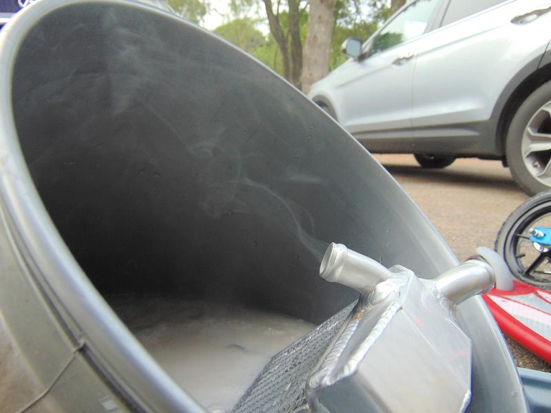

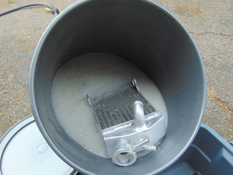

Didnt make as much progress as I though I would tonight but did get some things done...
removed all the engine covers. Broke out the tub of etching solution. Washed the cooling system brackets, etched them, painted them. cleaned up the oil cooler and painted that. fixed all the dented rad fins, etched it. I think it needs more time in the etcher because it is highly polished...

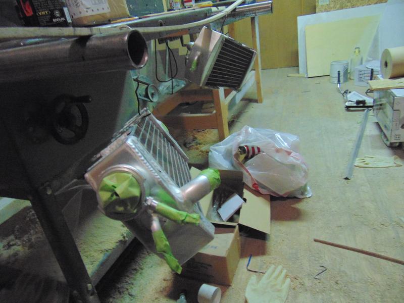

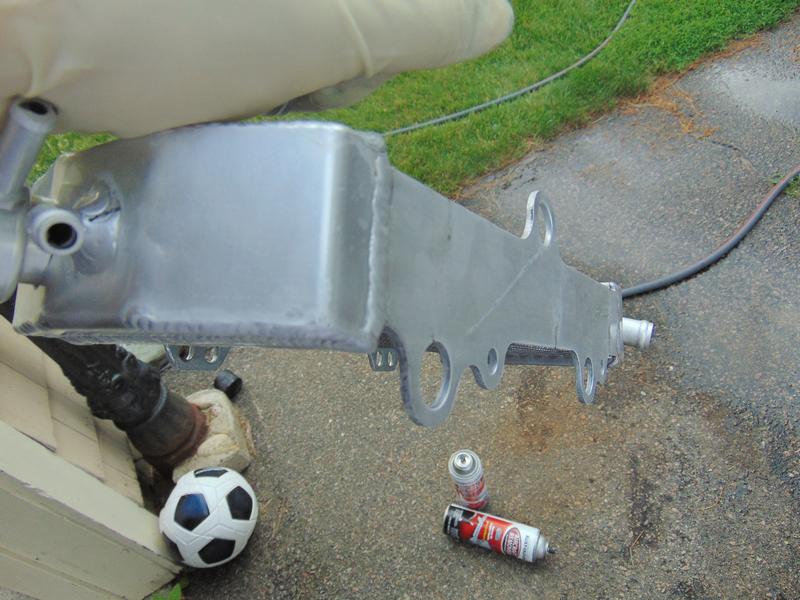

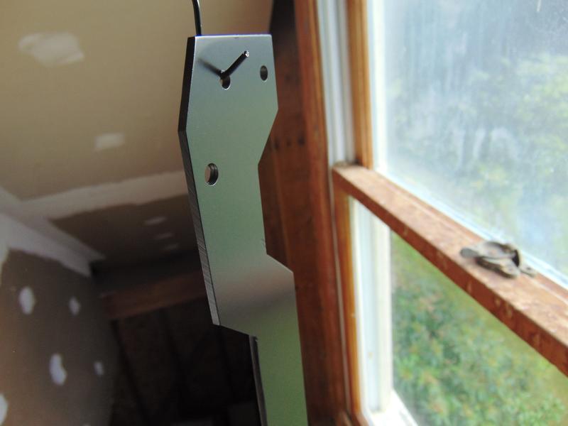

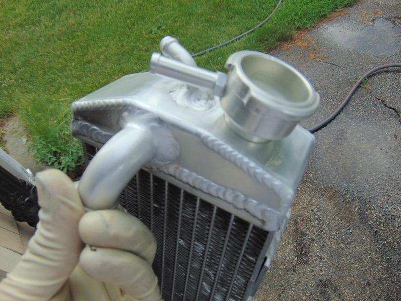

so I took a closeup picture of one of the rad brackets now that its dry to show the satin black, also the oil cooler in flat black...
I also took some "in-progress" pics of etching the rads, now that they are etched I need to dry them as much as possible, tape up the openings and spray them down with some flat black to match the oil cooler.
