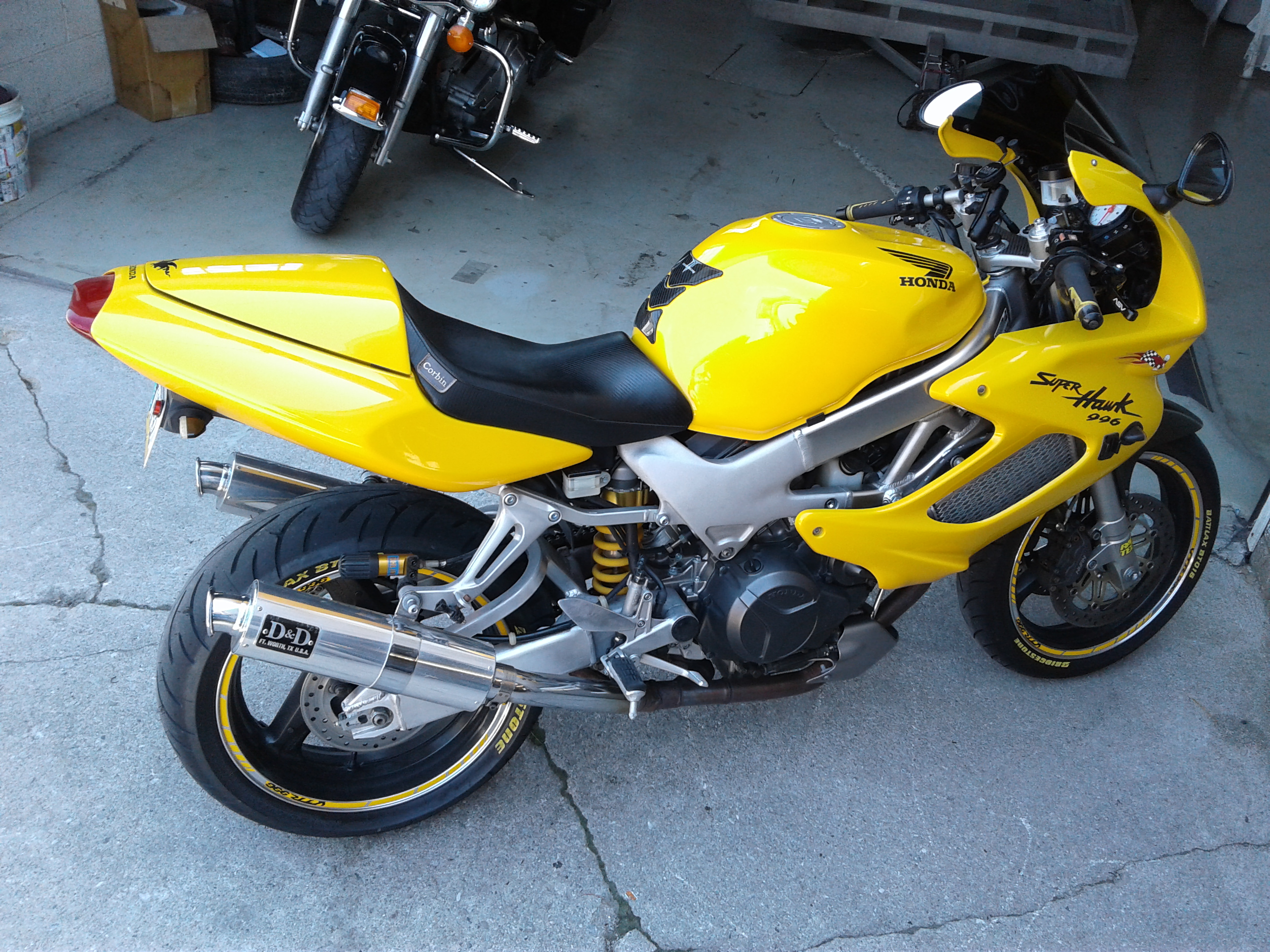

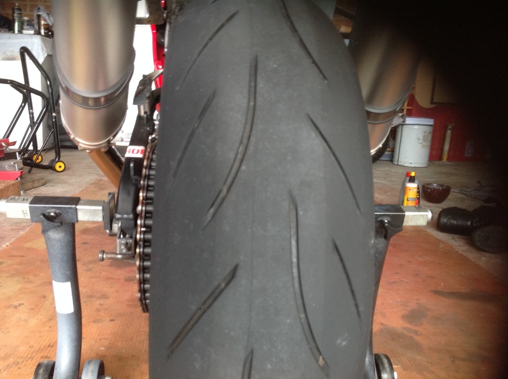

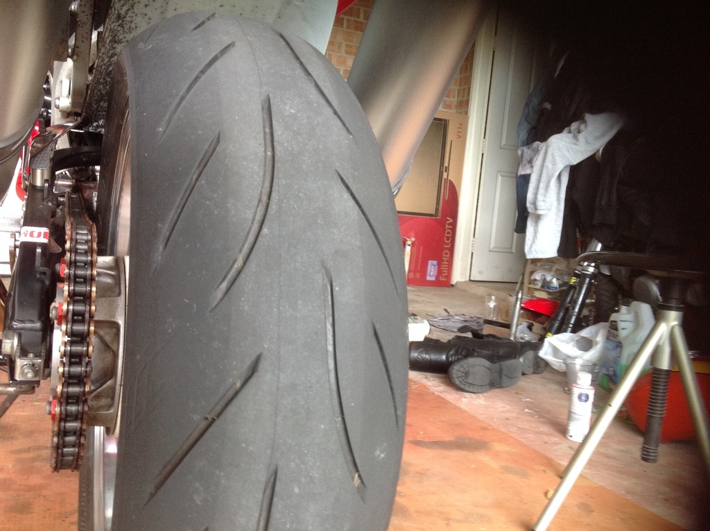

Went for a spirited ride over some close by mountain roads.
The front end and brakes just get better and better. I can now accelerate in places wher I used to have to back off.
Back tyre is now almost right to the edge , only a bees dick in it.
Testimony to the influence of the new setup.

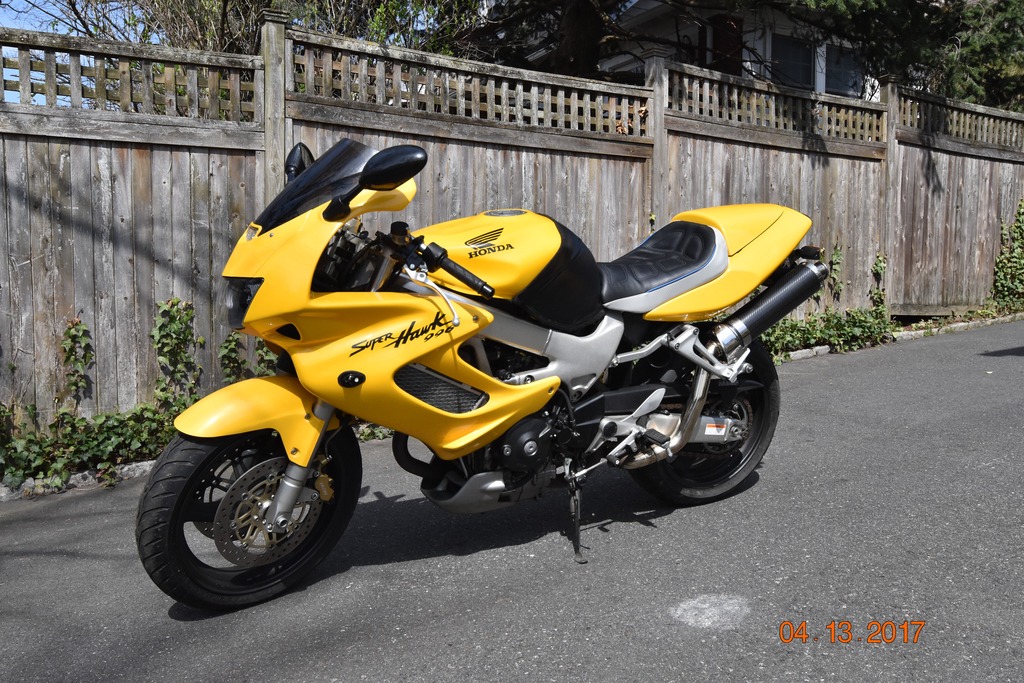

Took it for its last ride with me yesterday
Just put it up for sale in the classifieds section...awaiting for admin approval.
Hoping she goes to someone on here that will appreciate her.

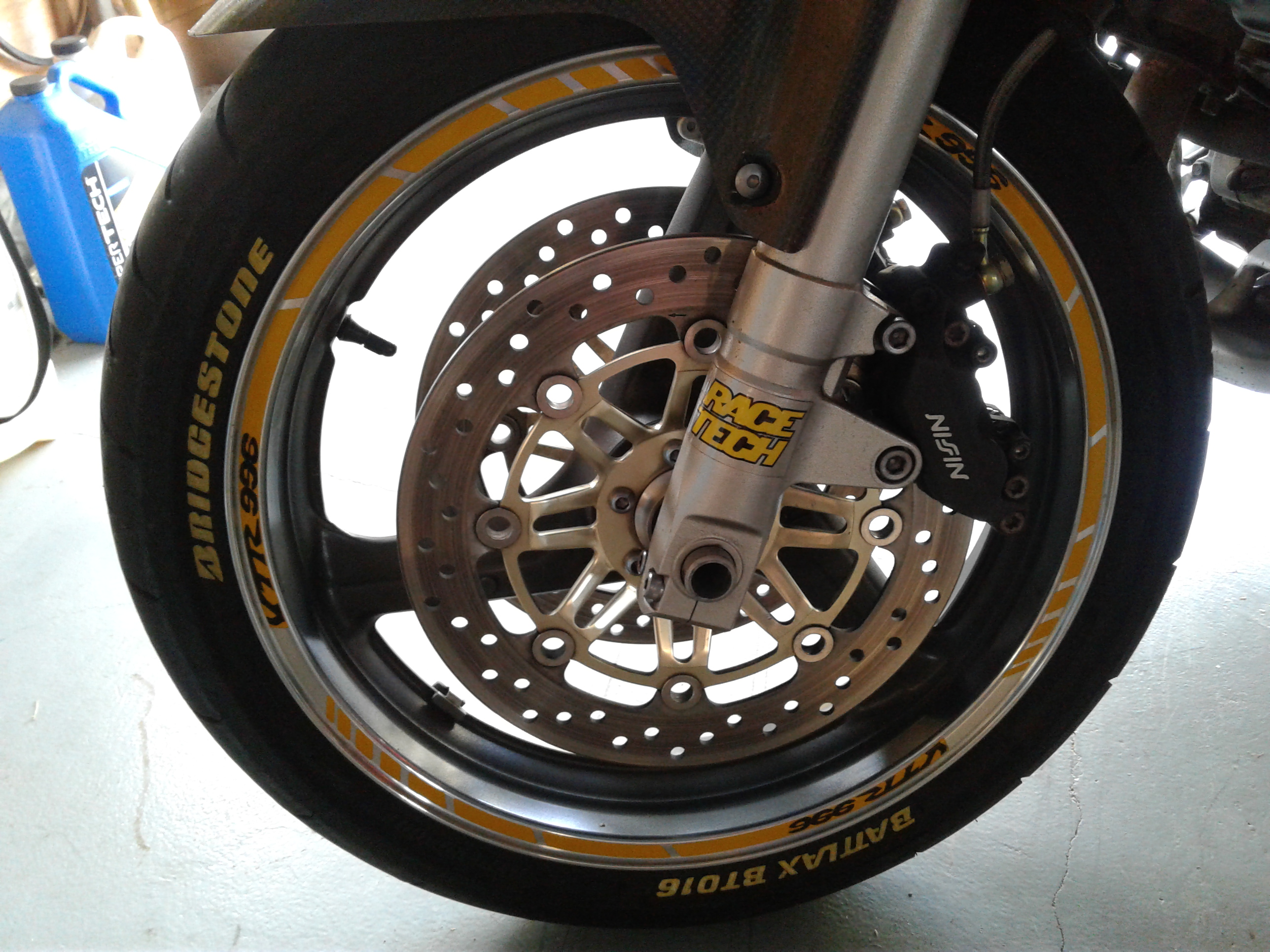

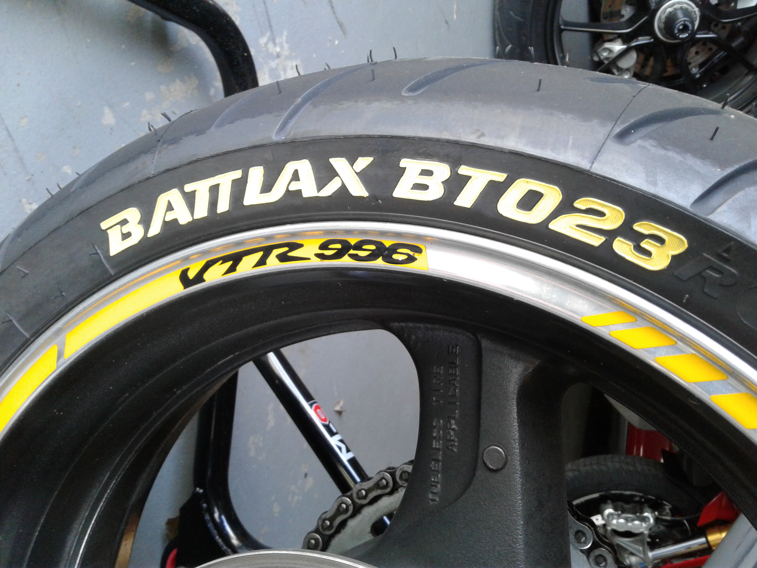

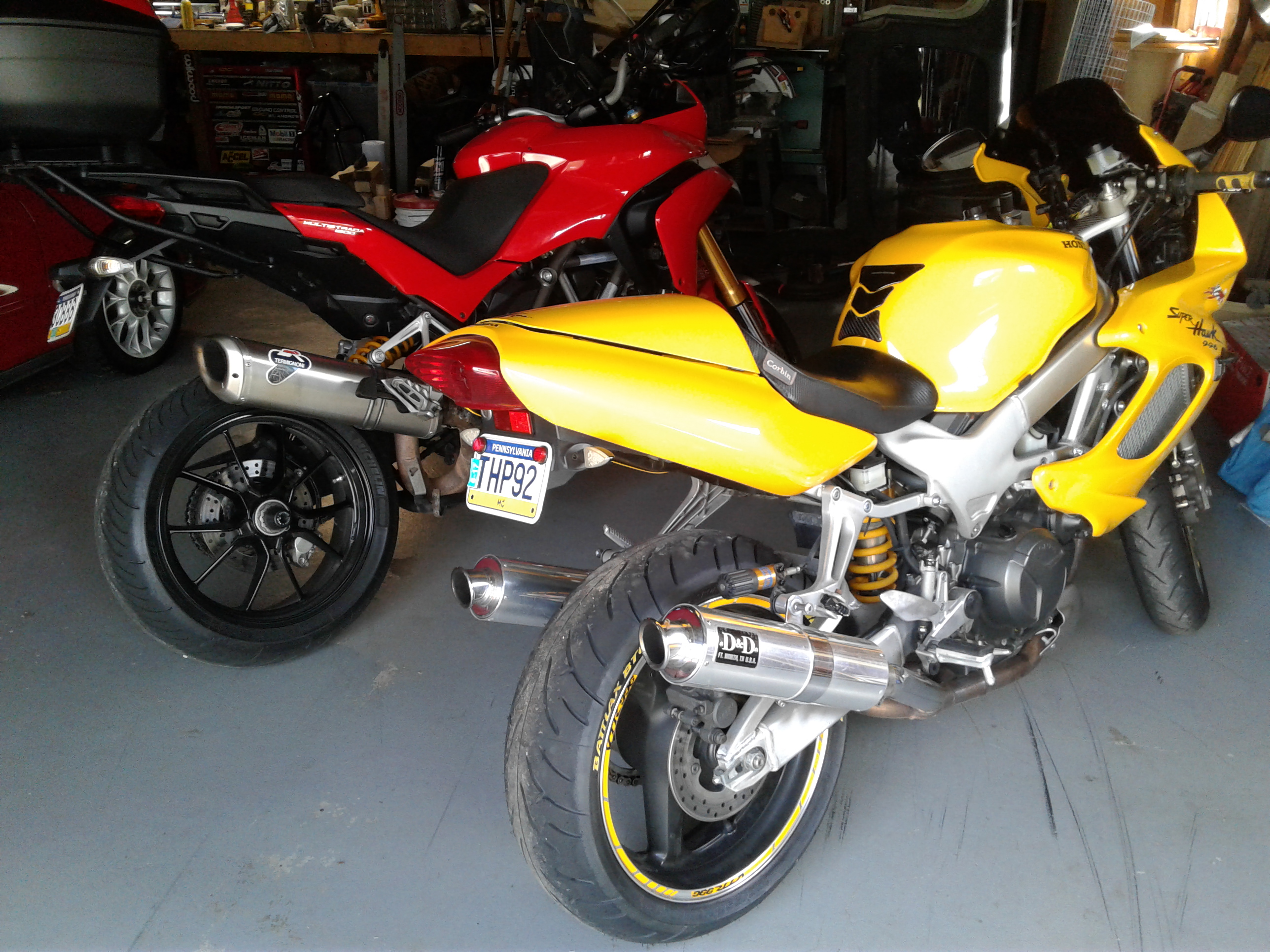

Little yellow action on the new back and a refresher on the front. T'was a lazy day...

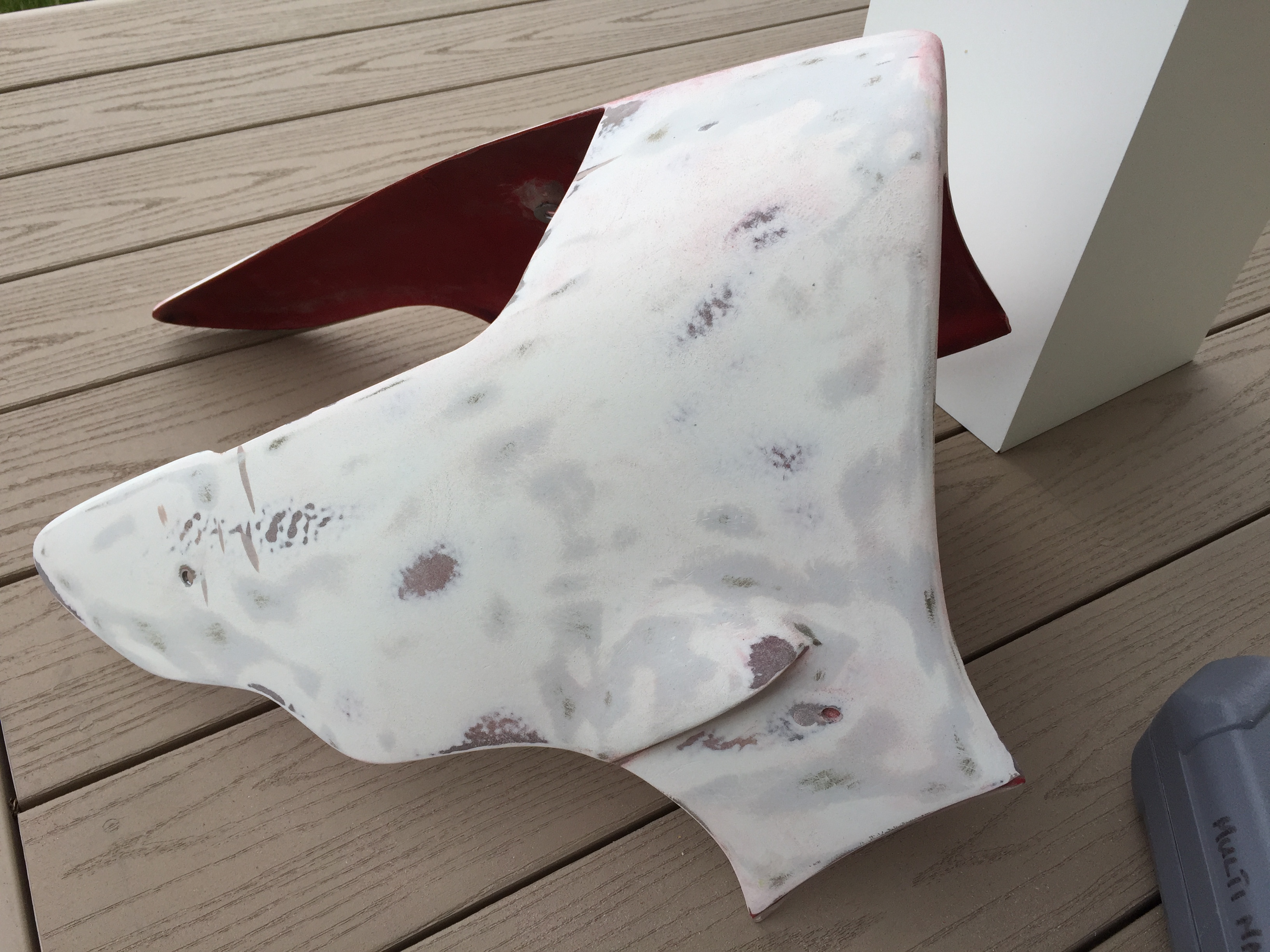

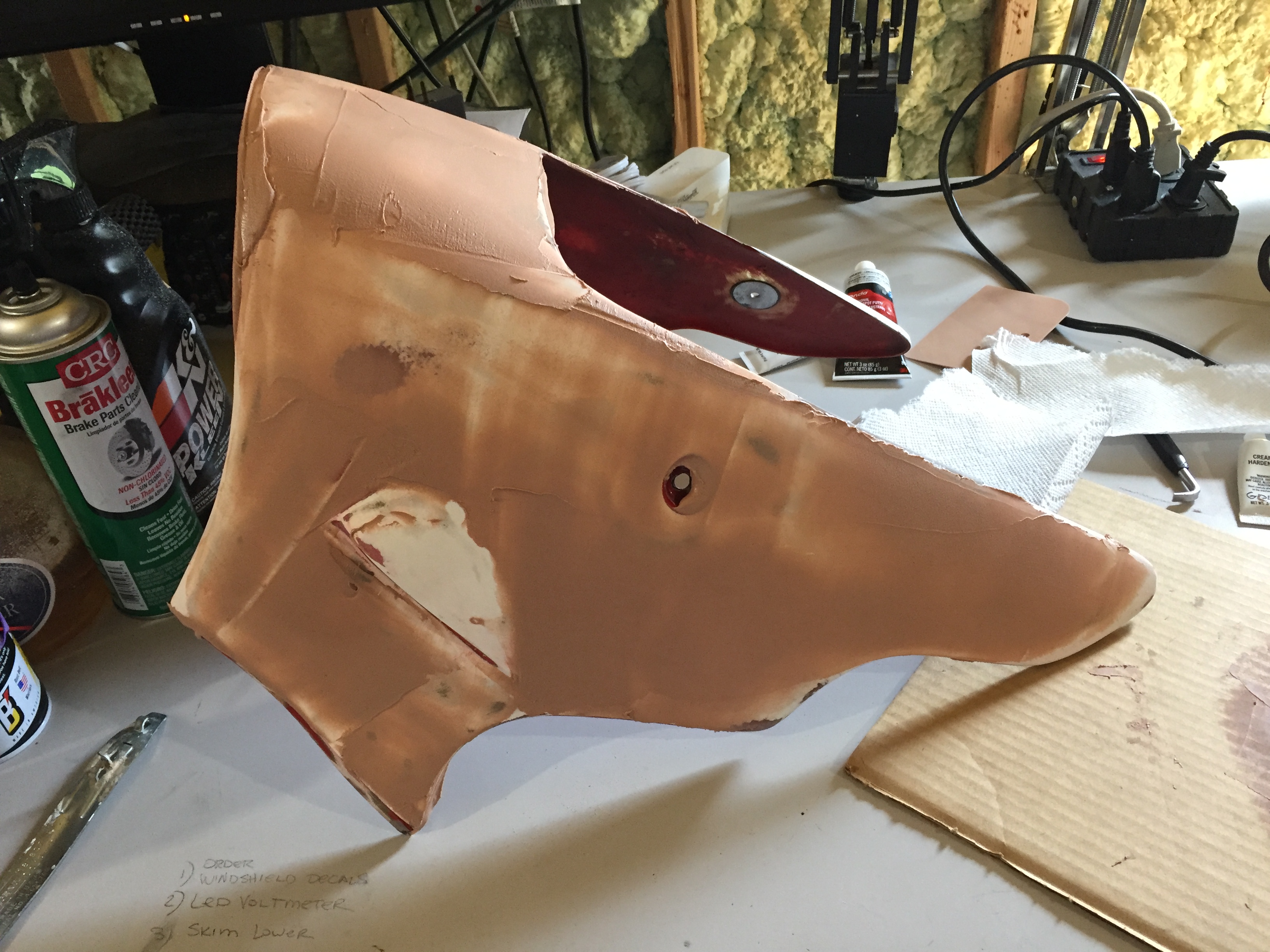

I started the bodywork on my lower. I epoxy bonded fender washers on the inside of the glass to prevent spiderweb cracks from forming when it's fastened down. I then sanded it down to the base primer/gel coat as the old paint was crap and not a good base for a fresh spray job. I then skim coated the whole thing in Bondo so I could sand it out to a flat surface. Unfortunately my allergies are in full attack mode, so no sanding today...
