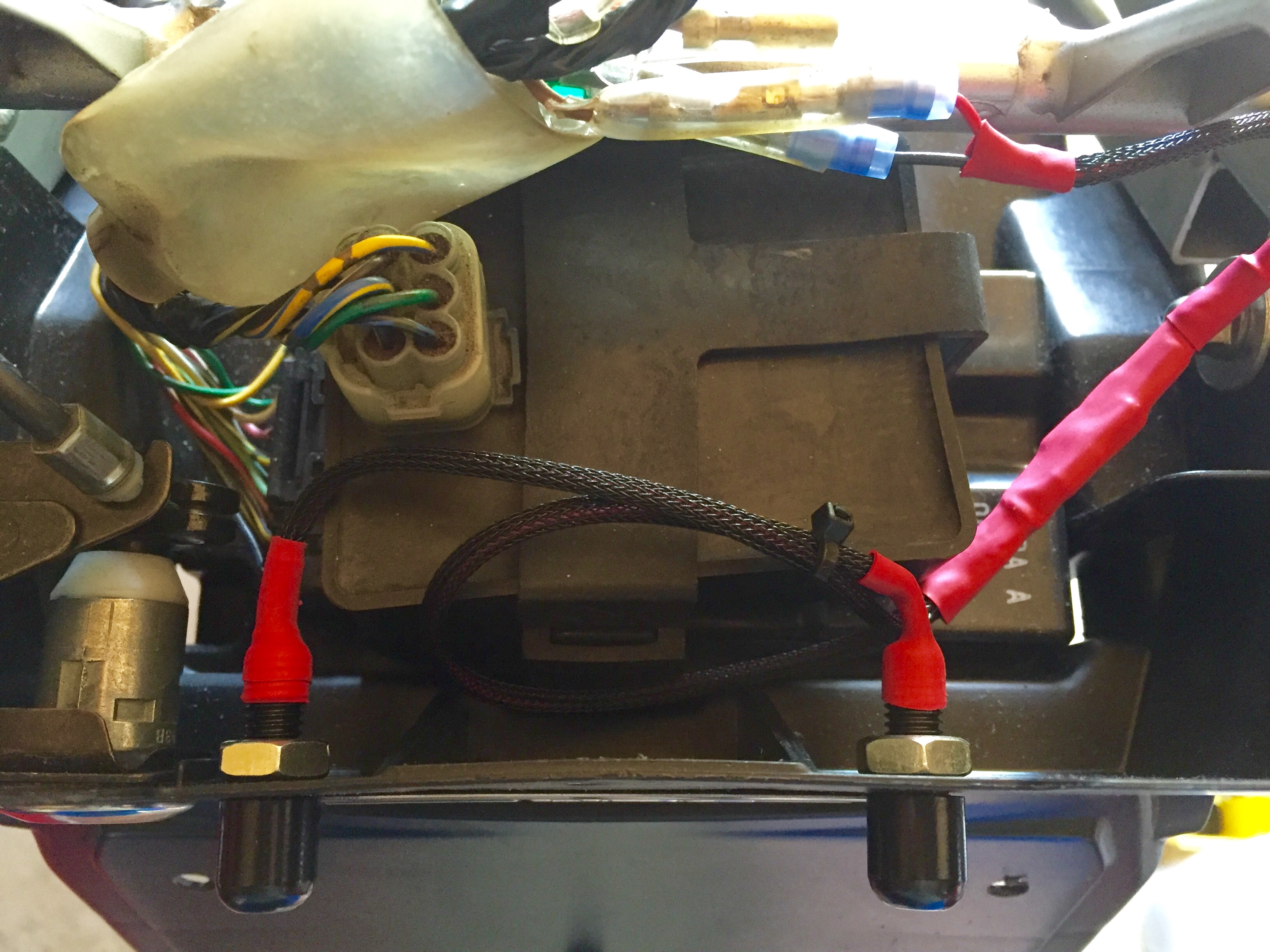

Just got done installing my new Oznium led side light bolts. Using them for license plate lights. I installed them above and slightly outboard of the spot the rear reflector used to inhabit. Plenty bright, delivery was super quick with company CS direct emails for delivery tracking, cool peeps to deal with.

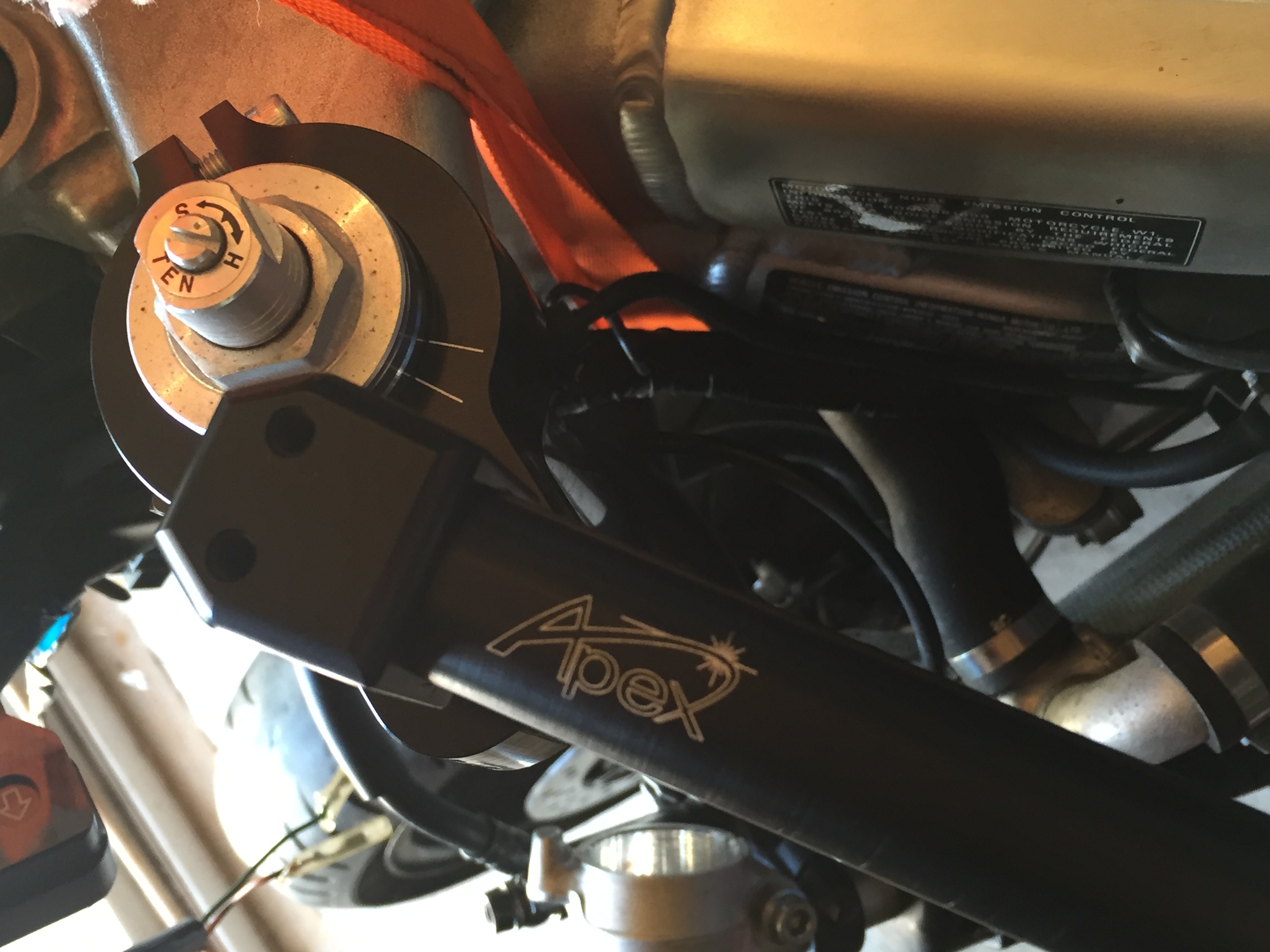

Happy dance day! Mailman just delivered my Apex adjustable clip-ons. Very nice craftsmanship!

Those look pretty nice! I got a quick question for you. I installed DanMoto adjustable clipons and am just now installing the switches, brake/clutch master, and throttle. The stock parts have a little nub that locates and keeps the parts from moving. What did you do with that little nub? Just grind it off? Or, are you drilling a hole in the handle?
I was curious if you grind that nub off, if the parts had enough clamping force to keep them from moving.

Plenty of clamping force is available without the nub. The nub is there for Honda's lawyers! My general procedure when fitting bars is to always wipe down the inside of the bar clamp and the fork tube with alcohol (no not Bourbon!) to make sure the mating surfaces are clean and offer maximum grip. Other than that torque to spec and you are ready to rock!

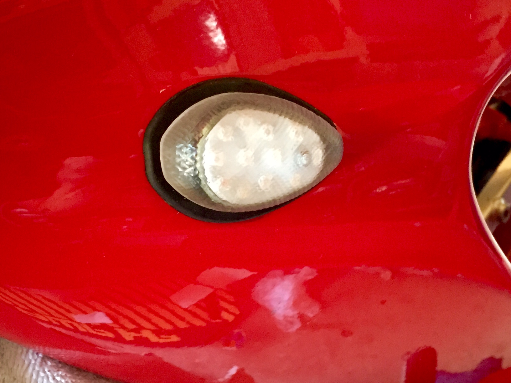

After being chained to the gas grille for Fathers Day I had some down time this morning which I used to get my front brake calipers ready to rock!

That's what I thought. Thanks Bobby!

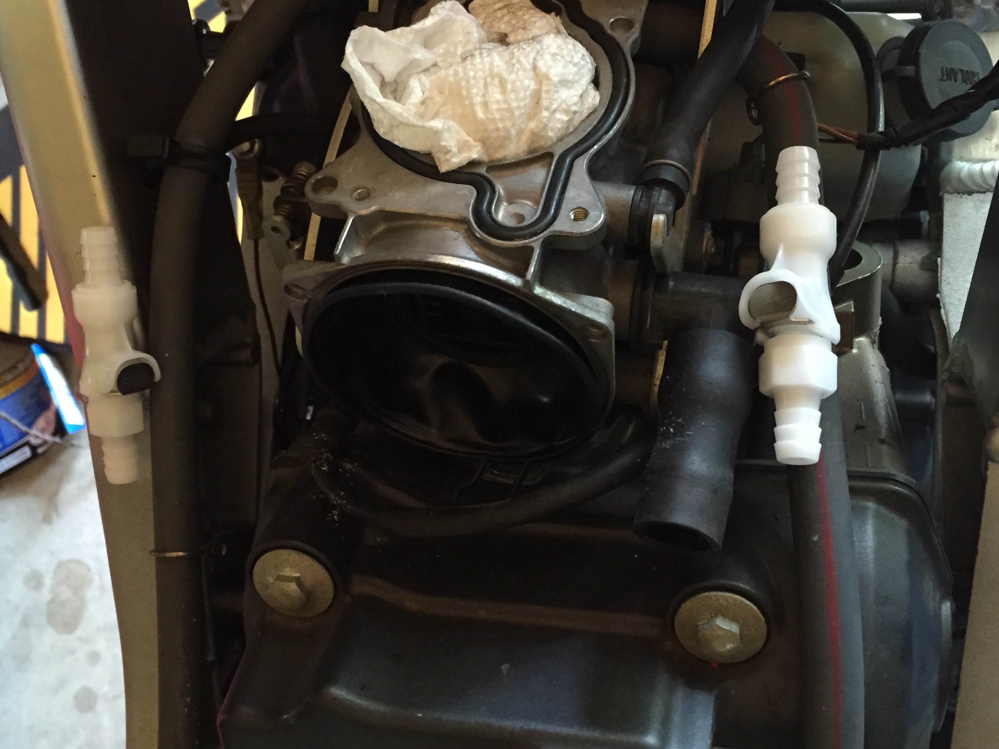

My latest evil plan
Boy oh boy pulling the fuel tank off the SH is a pain in the butt! Getting all the lines off the tank is a job for tiny fingered elves. So no more will I have to deal with that!
I bought two 3/8" dry break, double shutoff quick disconnect fittings for the fuel line, and a 1/4" and 5/16" non-shutoff for the fuel tank vent and drain line. I am putting a double needed house barb fitting in the petcock vacuum line. So removal will now be: 1. Remove front hold down capsrews. 2. Tilt up tank. 3. Clic, clic, clic, clic, pop. Tank off! More pix when done!

Fastguy, I have those same disconnects, while you are in there save yourself a world of toil and effort by putting some inline fuel filters in the lines.
Cant imagine how much this protects the carbs from bad stuff coming from your tank that isnt getting any younger.

That's why I hang around with you guys... Good ideas abound!

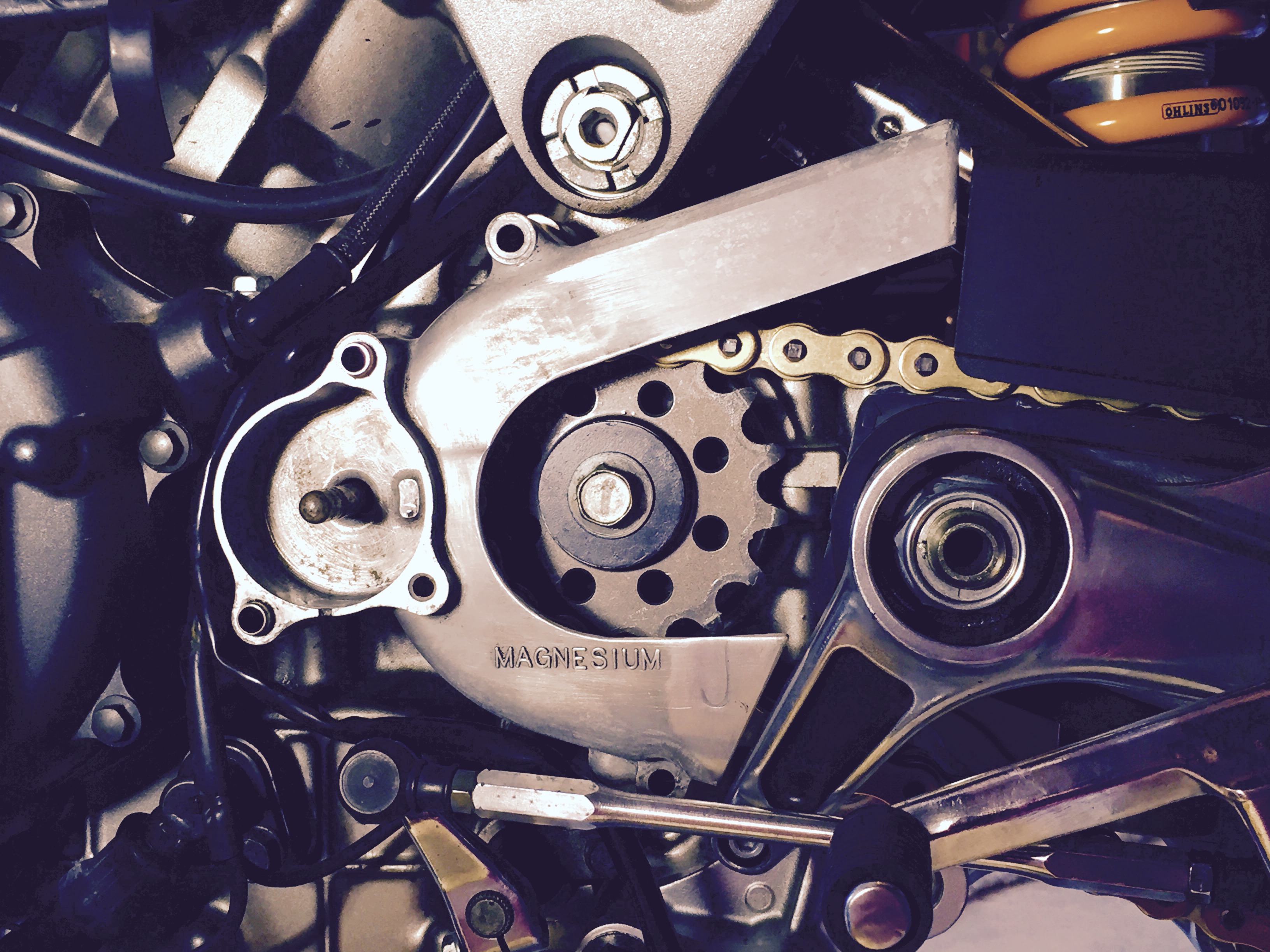

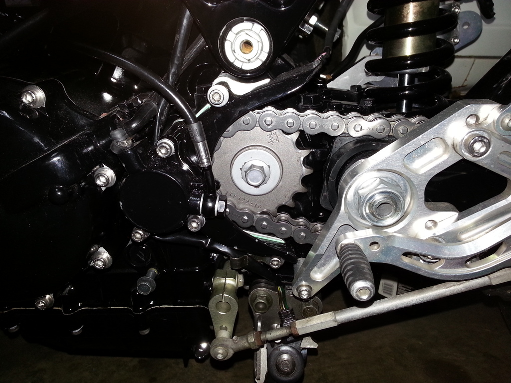

With no work table and no kneeling on my freshly tweaked knee, I decided to modify my spare countershaft sprocket cover... After stripping all the factory paint, I used a laser to locate the center of the countershaft and then placed the cover back on and then center punched the laser dot. One 2.5" hole saw later and a cutoff tool with a thin wheel on it I'm left with this. Reasonably happy, although I wish I had carried the chain guard bottom edge forward to meet the upward incline of the cutout... Live and learn. Next off to the powdercoater with all the engine covers!
I've done the same thing, but took a little more off than you. There is a thread on here with pictures of a couple others that have done this. I think it was called Nicky Mod or something.
EDIT: Here's the thread:
https://www.superhawkforum.com/forum...cky-mod-32186/
Dangit, on the picture I just posted, I noticed rust on my frame bolt. Looks like that's coming back out to get cleaned up.
Crux I left a bit more on the cover on purpose. I hate it when the toes of my boots get chain qack all over them!
As far as your rusty bolt is concerned get some long handled foam detailing swabs and apply black or silver paint to the inside of the bolt as needed... Shhhh trade secret....

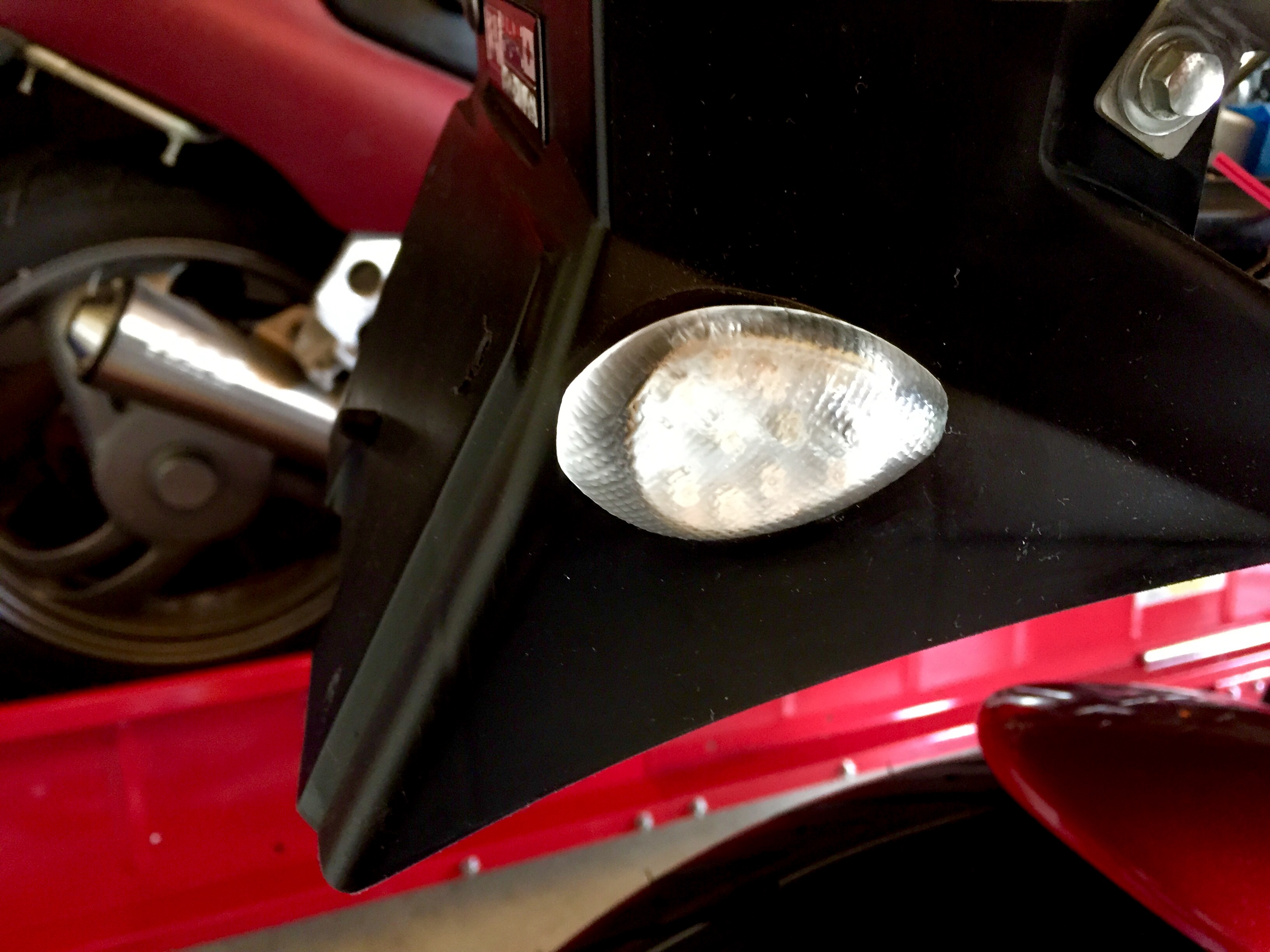

Built a couple of plastic plates today to facilitate mounting up my Proton blinkers, used them to sandwich the blinkers to the fairings rubber grommets.

Fast, I also hated getting chain goop all over the bike and possibly my shoes or pants. I started using Maxima Chain Wax https://www.amazon.com/Maxima-74920-...BRYAX56M45VB35
This stuff works awesome! It does not fling off chain goop. The inside of my front sprocket cover had very little debris inside of it after almost 800 miles after applying the chain wax. I'll never go back to using chain lube.
Good idea for making the rusty bolt look better. Thanks!

I too have used Maxima chain wax for the last 18 or so years with no fling.
The Nicky mod looks REALLY good when you install a Renthal front sprocket. It has a nice bevel around it and lightening holes so it looks trick.
