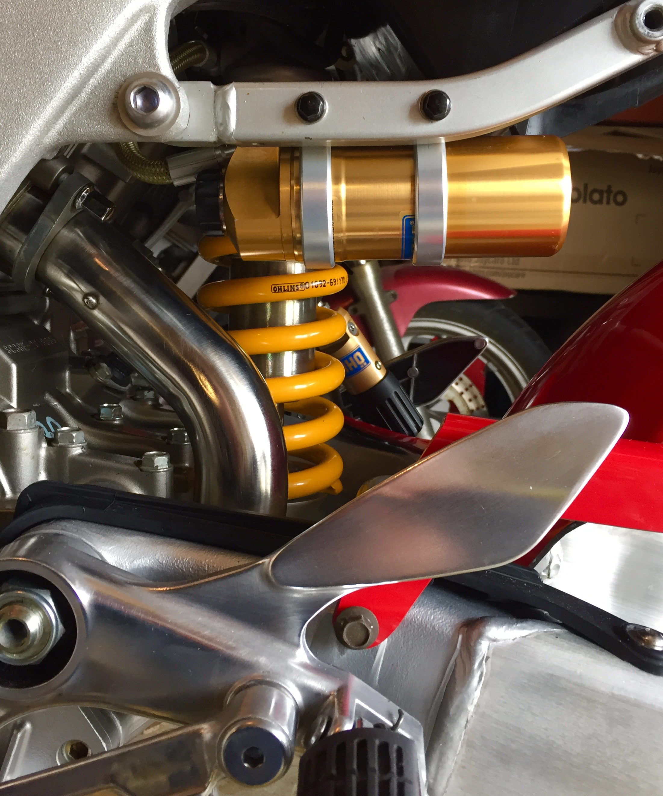

Fastguy59's Avatar
Joined: Nov 2014
Posts: 416
From: Middletown, CT
Baby Bottle Carrier done
Finished mounting up the Ohlins reservoir, test fitted the pyramid rear hugger, ordered up the rest of my fasteners, cleaned up some existing fasteners. Mounted up the Ohlins remote preload adjuster. General busy work! Zen!

Nice reservoir mounts. Those custom made?
Old Apr 24, 2016 | 12:03 PM
  #1752
Fastguy59's Avatar
Joined: Nov 2014
Posts: 416
CruxGNZ, I am shooting to have it rideable by by the end of May... 100% done is a different story. I have had to start prioritizing OCD detail, vs. actually riding it.. So it will be nice this year, but nicer spring of 2017, providing i don't bin it between now and then!

VTR1000F, glad you like them. I am copying in an abridged version of my reply to CruxGNZ's inquiry regarding the mount.
The mount clamps came from Kartek they sell off road parts. Kartek Off-Road Parts And Accessories
The clamps are a 2" roll bar strap clamps, part number AXA-MODCL200C. They are also available in black anodized. The ones I got are listed as clear anodized, but that was inaccurate as they are silver anodized.
I got lazy and just through drilled the lower subframe rail and used M6 x 80mm small head capscrews and the provided M6 nylock nuts. I plan on replacing the 80mm with 65mm and then building some aluminum tube spacers to hide the capscrews where they traverse the clamps just for aesthetics. The clamps have very good holding power with very minimal tightening of the 6 x 65 capscrews. Next winter one of my projects is to re-powdercoat the subframe. When I do I will have my fabricator fill holes on the outside of the tube and then I will put thin-sheet nutserts on the inside so it will look cleaner when blind fastened. For now I have ordered the m6 x 65mm button head stainless allens.
Old Apr 25, 2016 | 05:15 PM

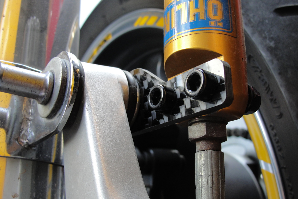

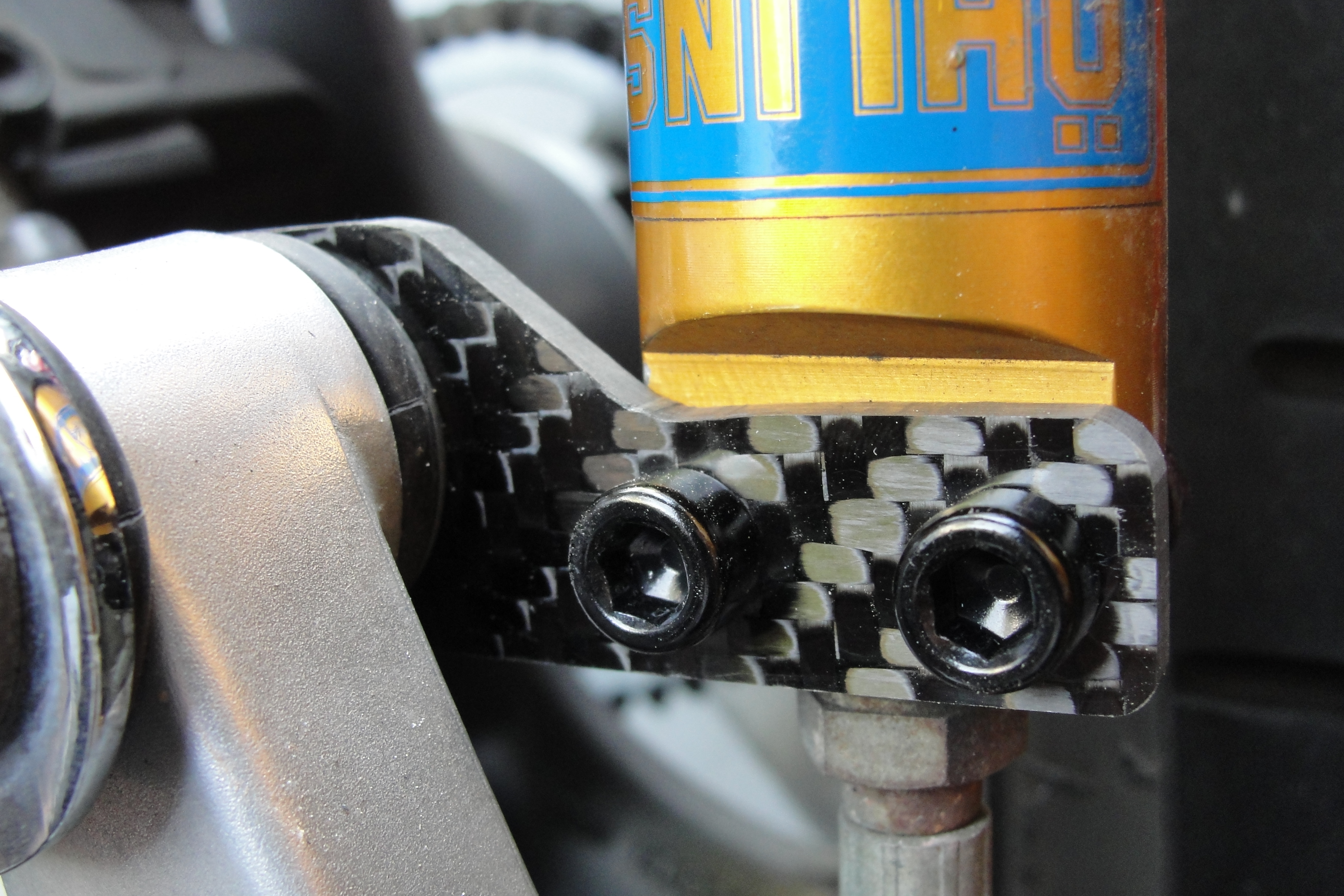

Bobby, I have a preload mount for ya! Let me dig up a pic.
Old Apr 25, 2016 | 05:25 PM
  #1755
Posts: 5,221
I have a spare...
Hmmm, anyone know what the deal is w/ photobucket?
Old Apr 25, 2016 | 05:34 PM
  #1756
I have a spare...
Attachment 19847
That carbon bracket is for your preload adjuster, right? Nicely executed I might add.

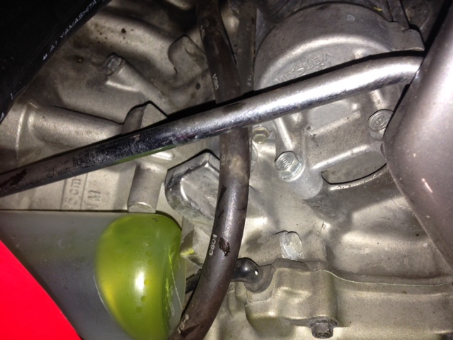

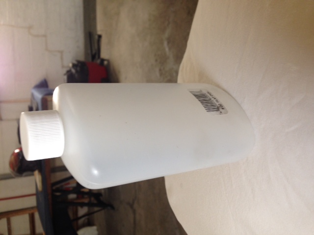

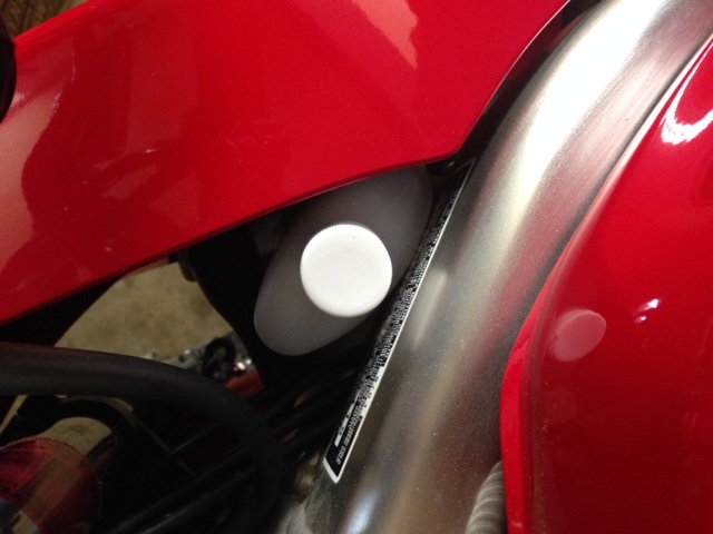

Old May 5, 2016 | 08:00 AM
  #1767
CrankenFine's Avatar
Posts: 1,481
promised pics
Here's where the HRC bottle is currently located behind water pump lower right side of bike. Basically wedged behind hoses securely. Great functionality but **** poor access so this is temporary.
Next will be this little gem I found at REI store for less than $2. A narrow Nalgene bottle it holds exactly the the same amount of fluid as the HRC but being narrow lends itself to so many other locations. After drilling for tubing I expect to mount it inside fairing above fan.
Attached Thumbnails What did you do with your SuperHawk today?-img_1916.jpg   What did you do with your SuperHawk today?-img_1918.jpg   What did you do with your SuperHawk today?-img_1917.jpg

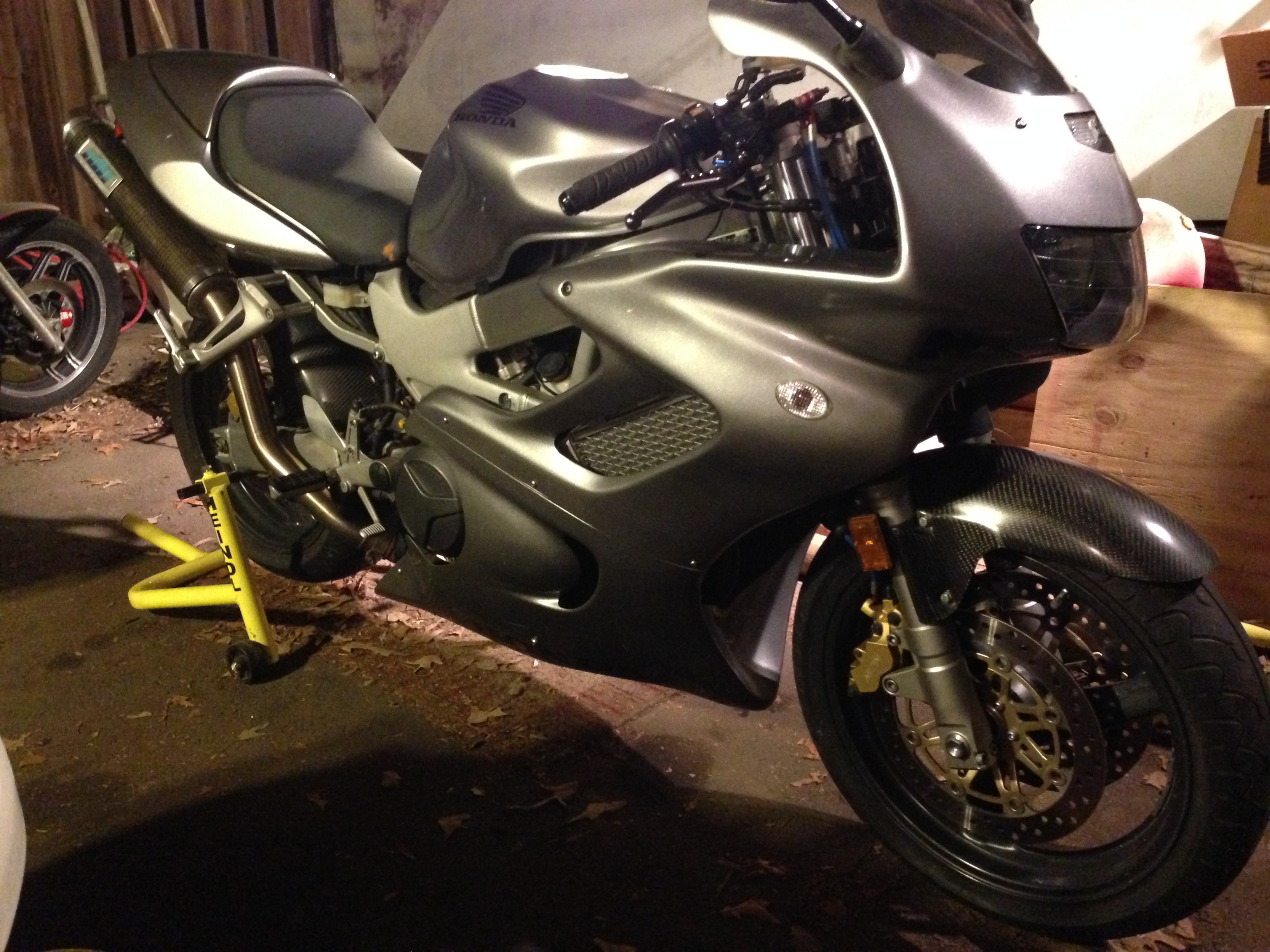

Braymond's Avatar
Joined: Apr 2016
Posts: 29
Braymond is on a distinguished road
I got this bike a couple of months ago from a guy who let it sit neglected in the garage for a few years. I got a lot of good info and advise here on the forum.
I finally got everything back together, the oil changed, and fairings back on. Only need an inspection, license plate, and some sunny weather to test it out on the road.
Only things left on the to-do list are install to new tires and some upgrades - suspension, maybe front brakes, and likely a lightened flywheel.
Old May 11, 2016 | 11:12 AM
  #1770
Really like that color. Seems OCMD has taken you over already!
