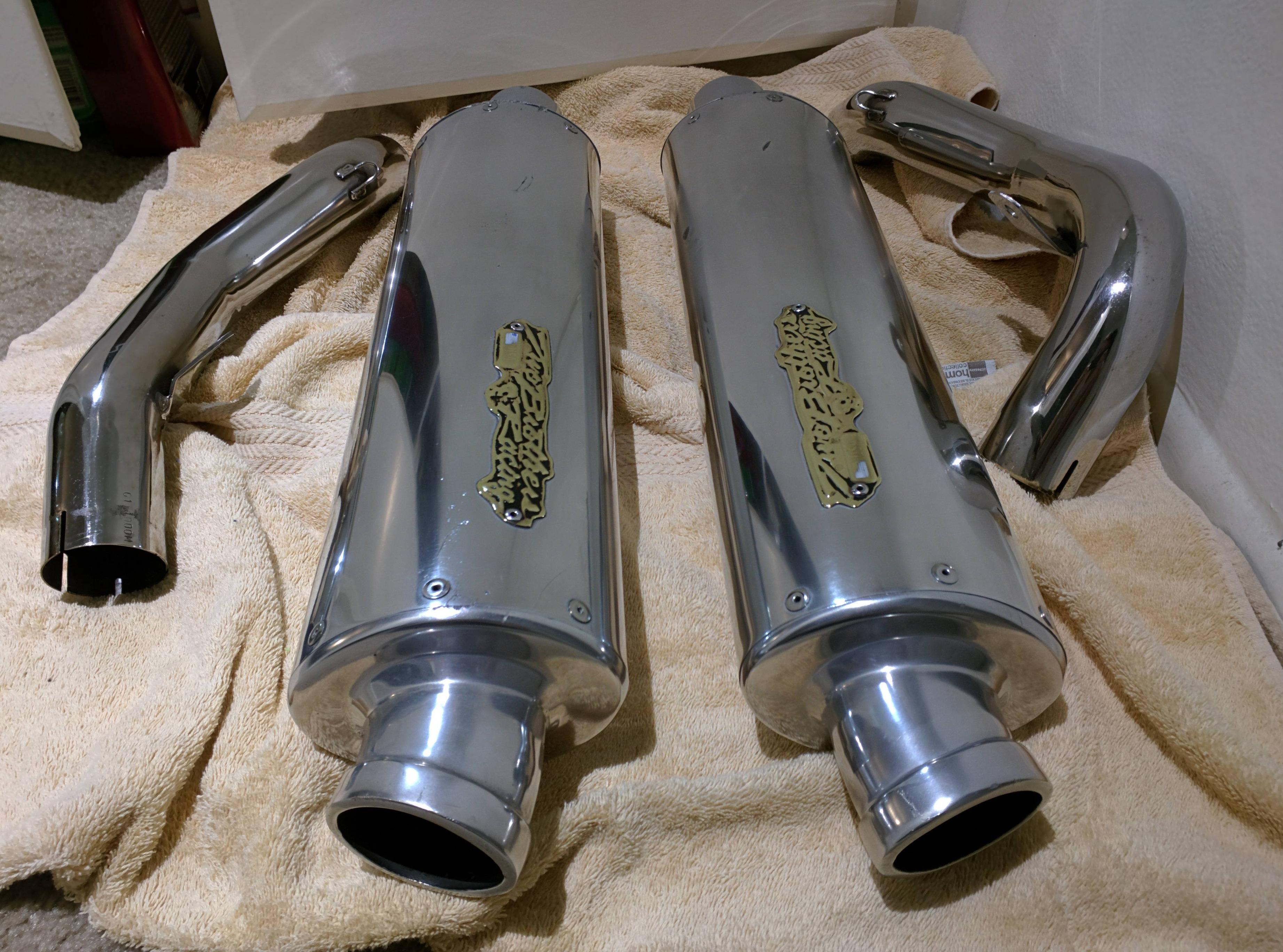

Ordered clamps, new titanium header wrap, stainless steel tie wraps, new donut gaskets, new exhaust gaskets, high temp RTV sealant, an exhaust tube expander (mandrel) to fix all my terribly deformed PO mistakes with hose clamps, and steel wool/cleaner to brighten everything up.
Hope to fully redo the whole exhaust then acquire some new Two Bros cannister clamps and actually have a 100% working system

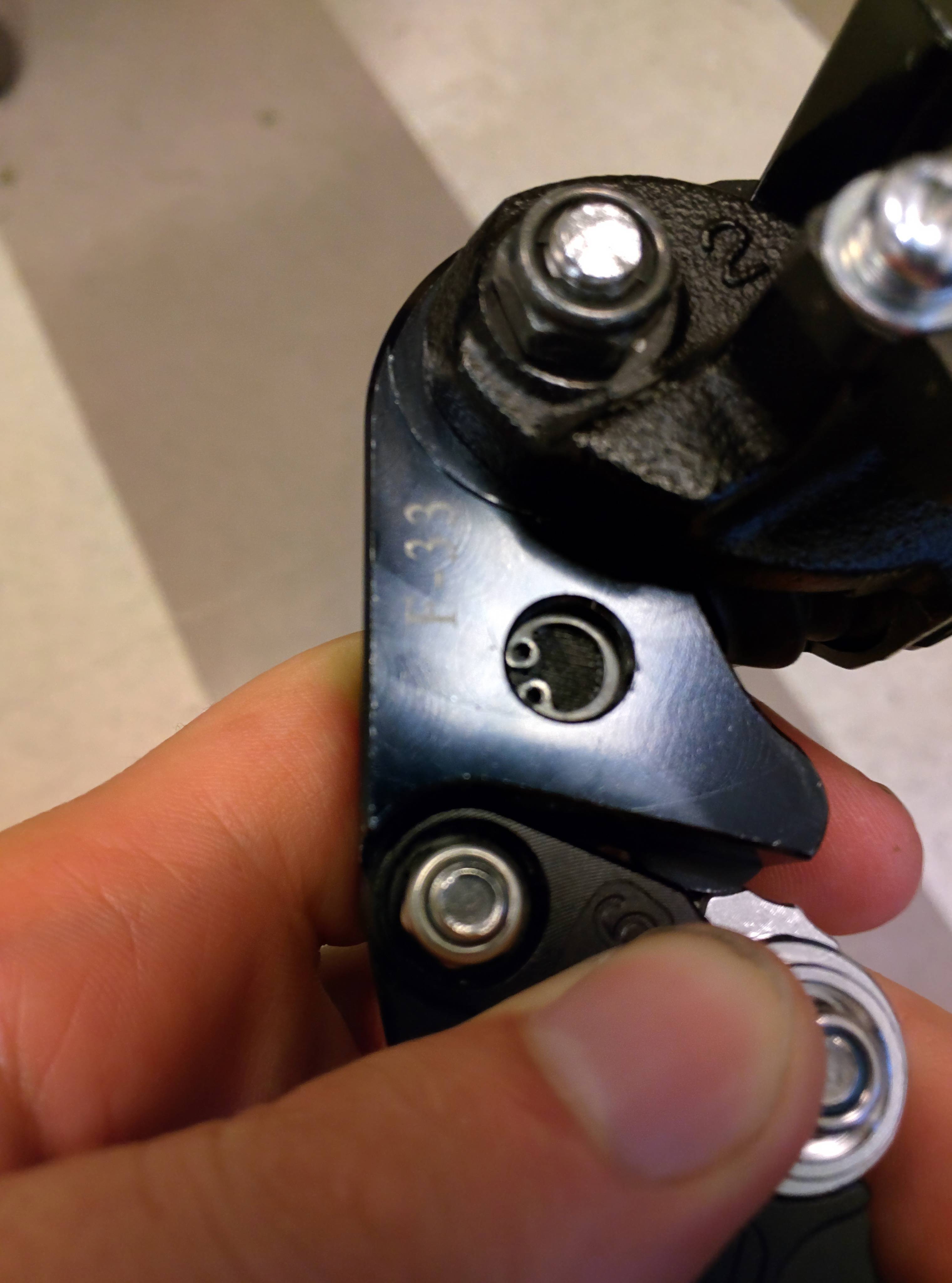

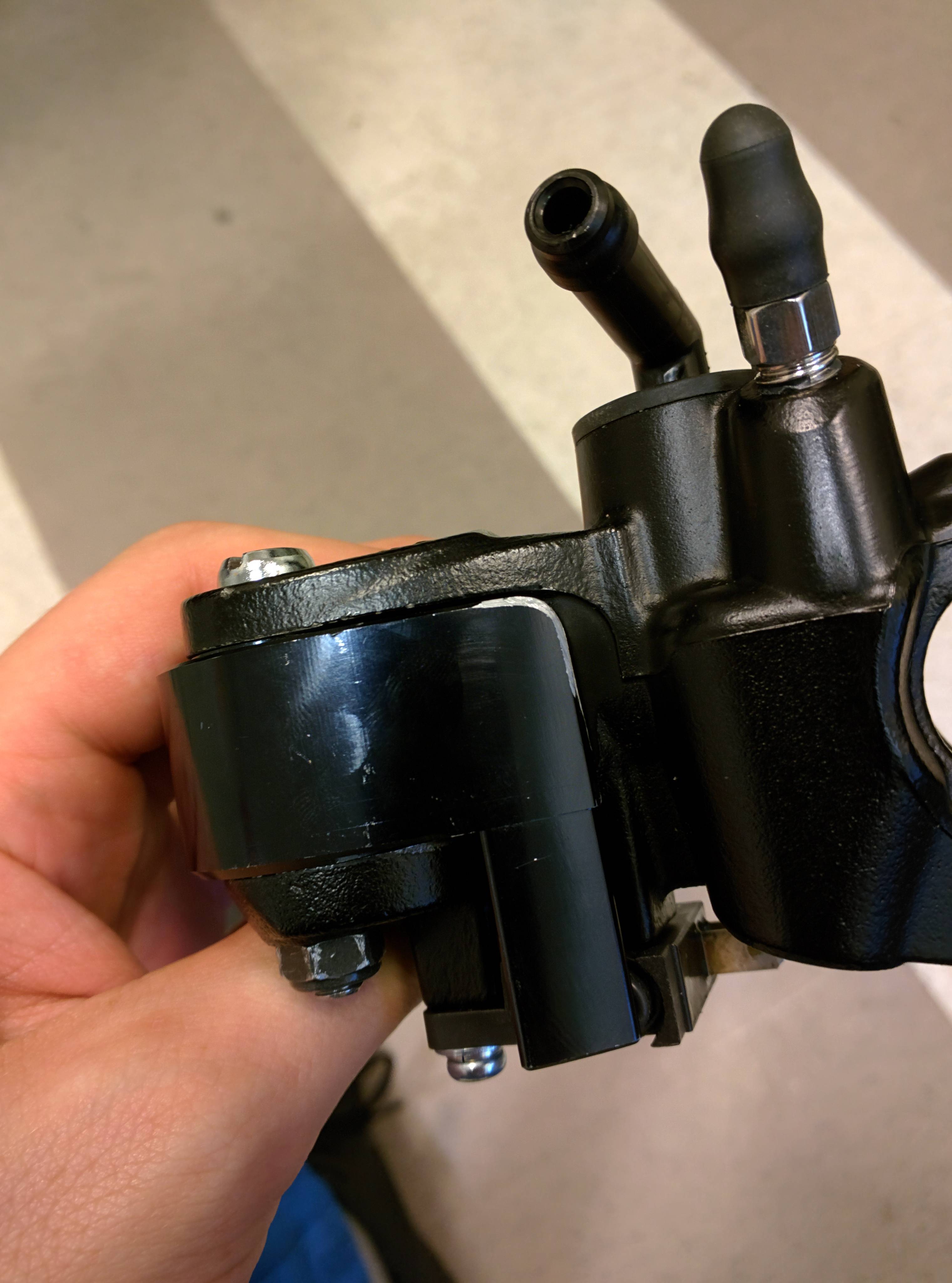

FYI to anyone installing an aftermarket lever or even OEM
I had to modify parts to get my new OEM radial from Nissin to work. The lever it came with would engage the piston slightly even at full rest. The aftermarket lever was even worse but I was able to grind off the section that prevented it from returning fully and engage the brake switch properly, then 3D printed a new bushing with a 1.65mm deeper hole to only engage the MC piston when the lever is actuated. These Chinese levers are full of surprises, to my amazement though, the OEM setup was also incorrect..

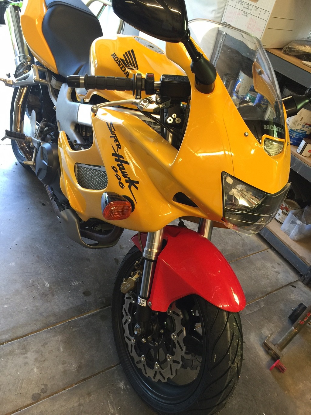

Fireblade front end finally installed.
Yes I have to paint the fender Honda color Y-124P.
I am using Woodcraft 3" riser bars for now. Although I wish I would have tried the Heli bars first since they are "one piece" and maybe back a little bit compare to these.
I can't even test ride it right now due to a recent bicycle crash that left me with a fractured elbow.
However, it started right up after my carb work, goes 'Vroom Vroom" and idles nicely.

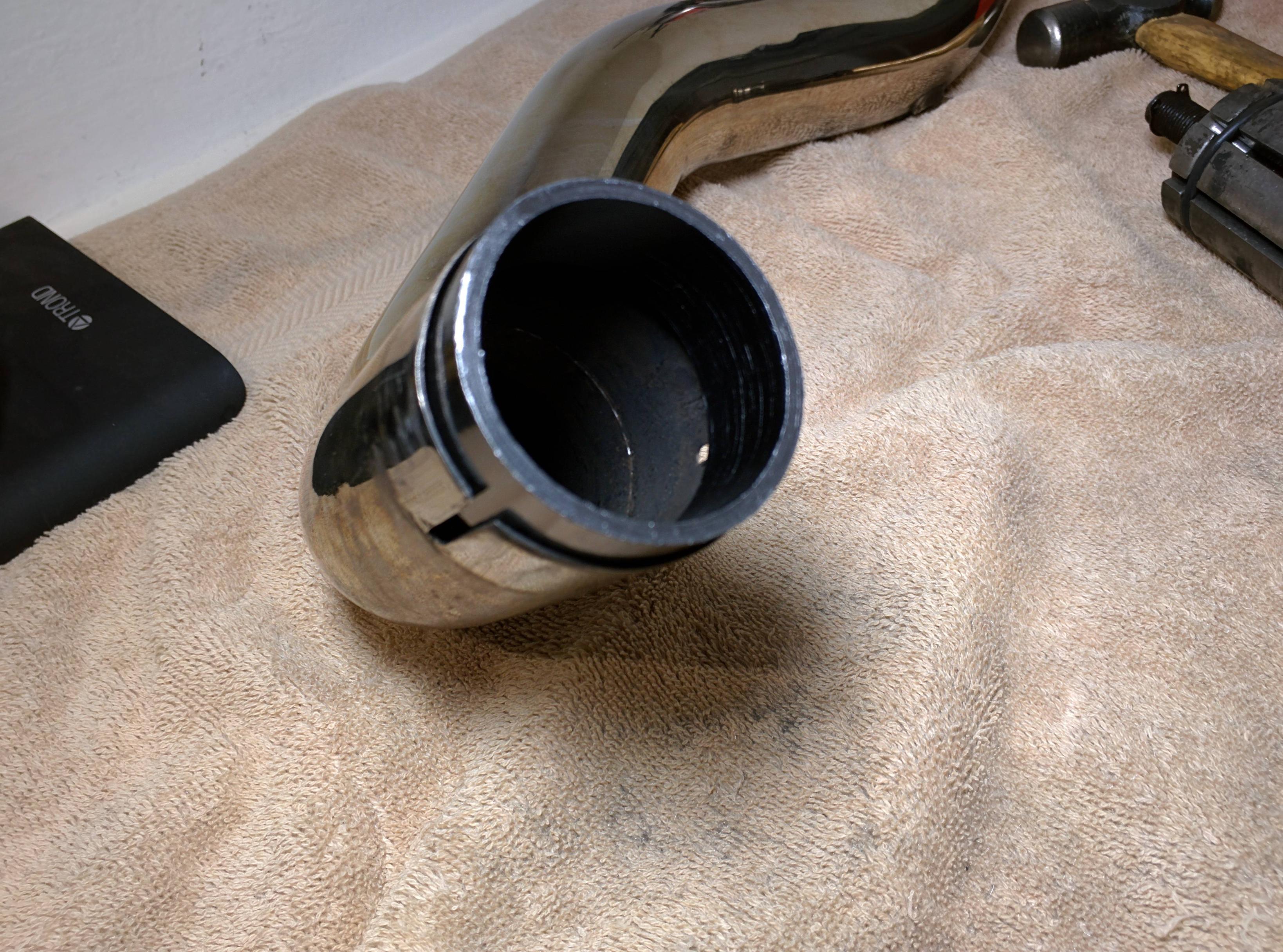

Ren, If it were me I would find a comparable or slightly smaller sized piece of heavy walled pipe, put the heavy walled pipe in a vice, and slide the exhaust end over it. Then reshape with a soft faced mallet. The mallet (I like weighted nylon faced ones) will not scar or ding the surface and should leave it very smooth. YMMV.
Oops......I see now that you bought a mandrel. If you have trouble getting the overlapped portion back over you may try using a "soft chisel". I make them from hard wood or old plastic cutting boards. They also will transfer a lot of force without scarring metal.
The mandrel worked fairly well! I do however have two little spots at the joint of the slots that are sticking up so I will reload it onto there and use a soft faced mallet to hit them out like you recommend. I've gotten the donut gasket to fit and it would not before

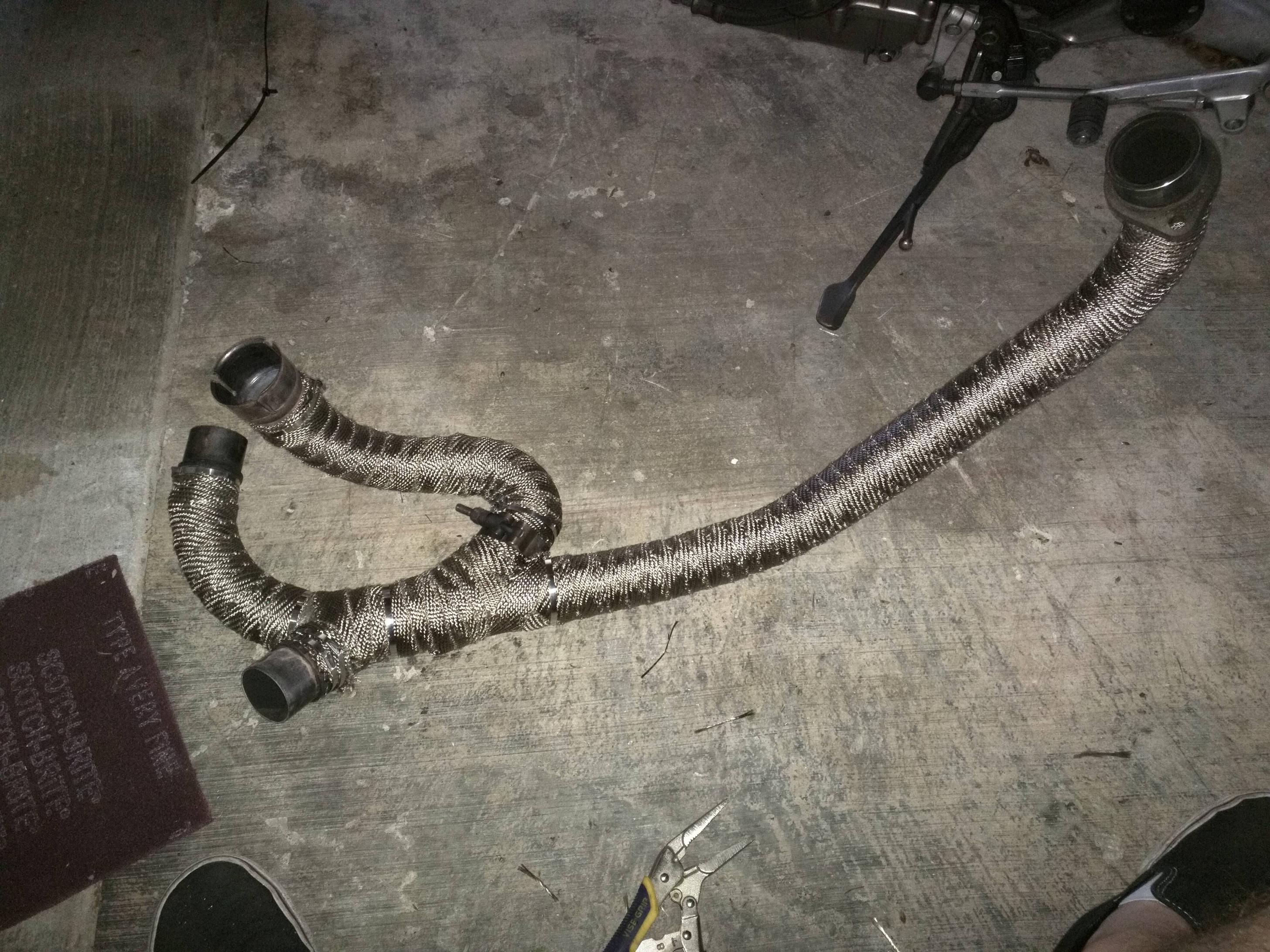

50 ft of wrap fits both header/midpipe PERFECTLY. Used DEI titanium wrap so I wouldn't have to soak it and I like the color

50 ft of wrap fits both header/midpipe PERFECTLY. Used DEI titanium wrap so I wouldn't have to soak it and I like the color.
ren, I like the look of that wrap. Post up pics when mounted on the bike.

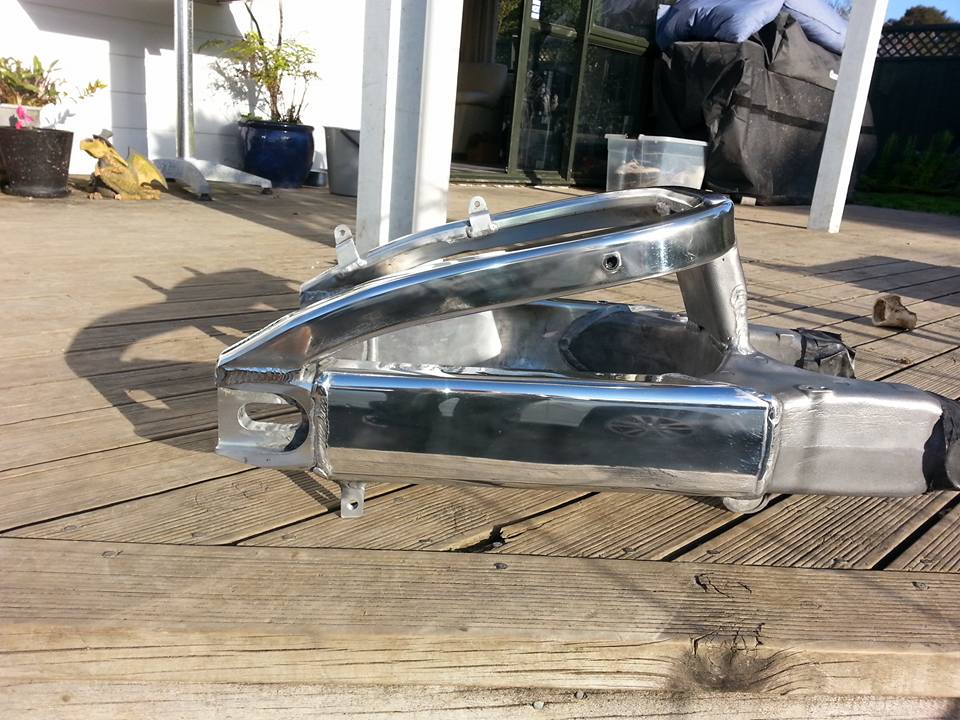

Started my day lifting the needles in my Bandit 1200, lifting the bars on it and adjusting the chain. Then moved on to making some highway pegs for my partners bike.
Once that was done went back to polishing my swingarm. Getting there but still a little milky in places.

Old Sep 12, 2015 | 01:44 PM

What is your polishing method? Have you polished aluminum before?

'Once that was done went back to polishing my swingarm. Getting there but still a little milky in places.'
That is looking pretty nice!!
I am working on the same thing. I decided to get a little crazy and sand away at the cast sections of the swinger too. My plan is so polish, then lightly brush and anodize it. Not sure of the shade I will choose yet. Natural, grey, black? even considered blue. Anyone like and use the anodized look for bike aluminum parts?
Old Sep 12, 2015 | 06:20 PM
James
Only a bit. Started out with 240 grit wet n dry paper to get the anodising off. They 400, 600, 800, 1000, 1200 paper. Orbital sander made it easy. Then buffing wheel on my bench grinder.

That is a very good method, but in my opinion needs a couple more steps:
After 1200 dry go to 1000 wet, then 1200 wet. That will GREATLY reduce the milkiness, and will produce amazing depth to your polish work.
I've hand polished way too much in my life, and the wet sanding is a key ingredient.
After wet sanding i slather the part with Mother's mag and aluminum polish, then use a high speed buffing wheel. I do the Mother's process twice.
All these steps equal an amazingly deep, rich polish.
