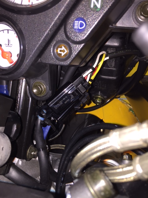

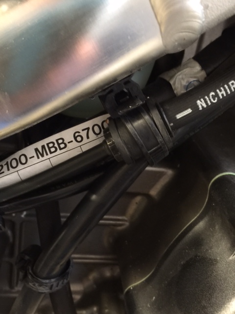

Old Sep 17, 2015 | 08:25 AM
  #1536
Hangfly's Avatar
Joined: Mar 2015
Posts: 409
From: Central CA

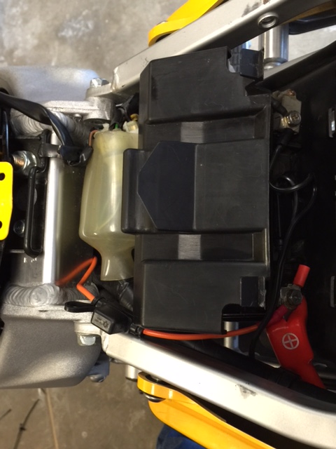

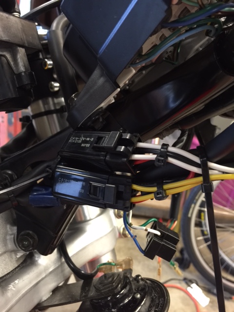

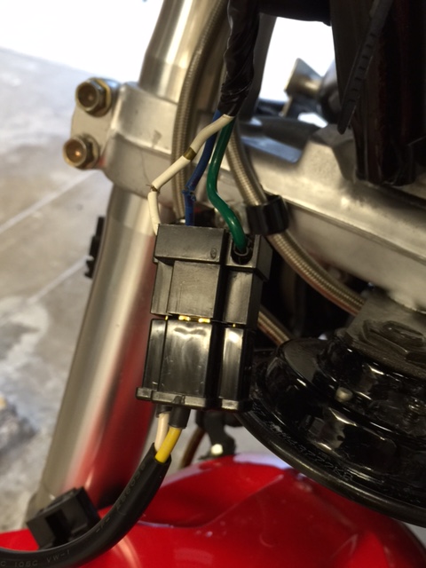

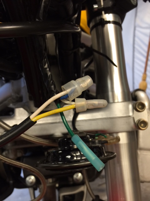

I Installed an EB headlight harness. See how I cut it up.
Eastern Beaver
H4 Single Fairing Relay Kit $54.95
Item #H4S-F
I had heard about this excellent harness from others and that it improves the stock headlight brightness.
Since some previous ("technician" had used quick connects to tie into my headlight wiring) work had damaged my wiring, Eastern Beaver's harness was a "no brainer".
The kit comes relays for low and hi beams. So you need to find a place for them. I zip tied them to the right side of the fairing stay.
Now run the long supply power wires back to the battery. Just zip tie them with the other existing harness that goes that direction. try to make it flow smoothly choosing a nice route.
Hidden behind the clutch hose here. Buy a big bag of zip ties if you are picky. I seemed to cut out many and before settling on a final path.
Nothing fancy here. I just routed the ends into the battery box area and landed them on the terminals. The way I routed the lines through the frame left me with just enough length. I should have shifted the whole length rearward a bit and left less slack at the headlight area. Notice the red wire with the nice fuse holder which is included .
Back at the front, see Eastern Beaver's provided male receptacle that plugs into your old headlight female plug. This is so no wiring connections or splicing is needed for customer's installation. There is also a new female headlight plug (not shown) that plugs into your headlight of course.
Well as I mentioned before, my wiring was damaged, plus I wanted a secure connection and I didn't want this connection taking up space. So I chopped it out of there and spliced the wires together with crimp connectors.
Here is a photo of the mounted relays as seen from above at instrument panel.
The relays could be hidden better. Perhaps behind the fairing stay.
If someone has already posted a better location, let me know.
I am pleased with my purchase. The lights are brighter and the harness is of much finer quality than the factory wiring. If only the rest of my wiring were to the same standard.

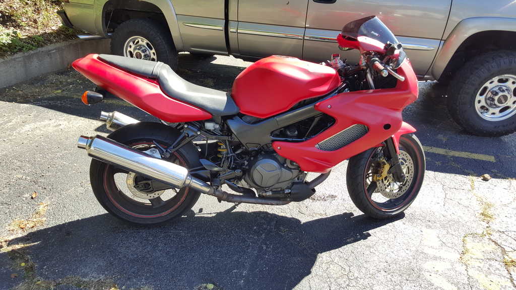

Old Sep 19, 2015 | 12:13 PM
  #1547
Rubicon0311's Avatar
Joined: Aug 2015
Posts: 28
From: Kalamazoo, MI
Rubicon0311 is on a distinguished road
I painted my frame black yesterdayName:  20150919_150548_zps1p0zfcyy.jpg
Size:  266.5 KBName:  20150919_150539_zpsdcdqkvk2.jpg

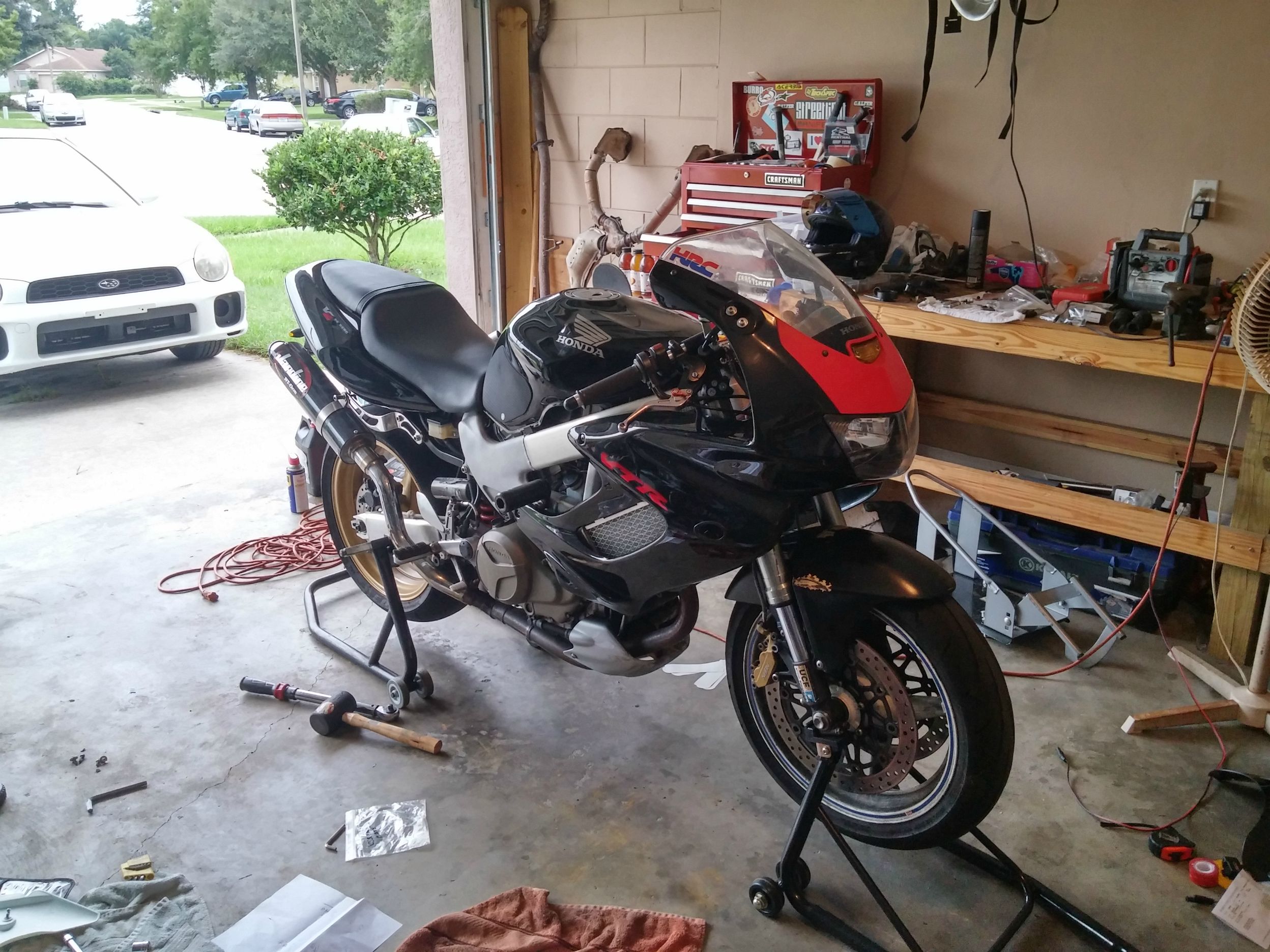

Old Sep 21, 2015 | 01:44 PM
  #1548
UCF Eric's Avatar
Joined: Jul 2014
Posts: 110
From: Orlando
Not today, or yesterday, but I finally got the girl back together after a nasty crash.

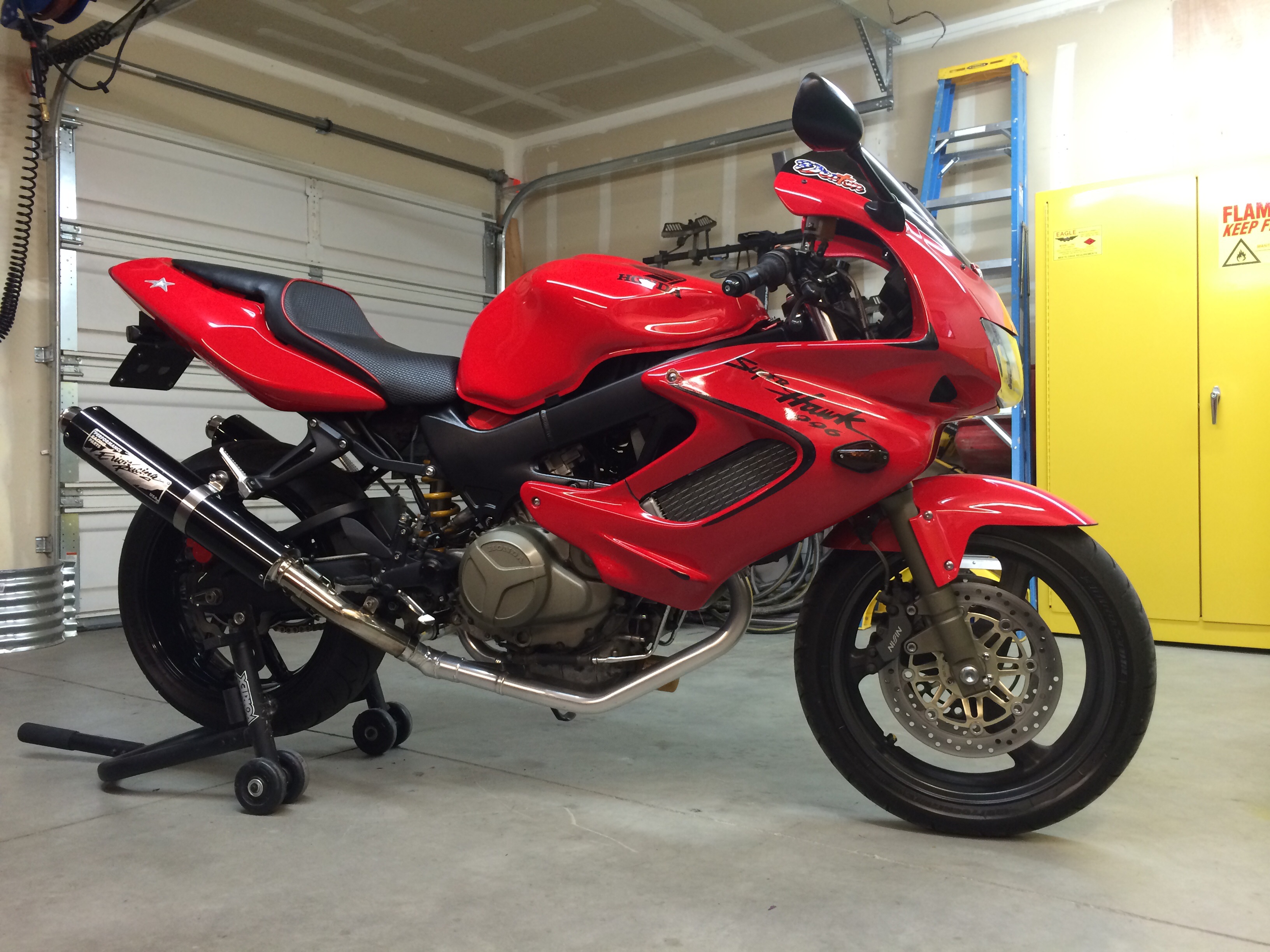

  #1558
thedeatons's Avatar
Joined: Feb 2013
Posts: 1,510

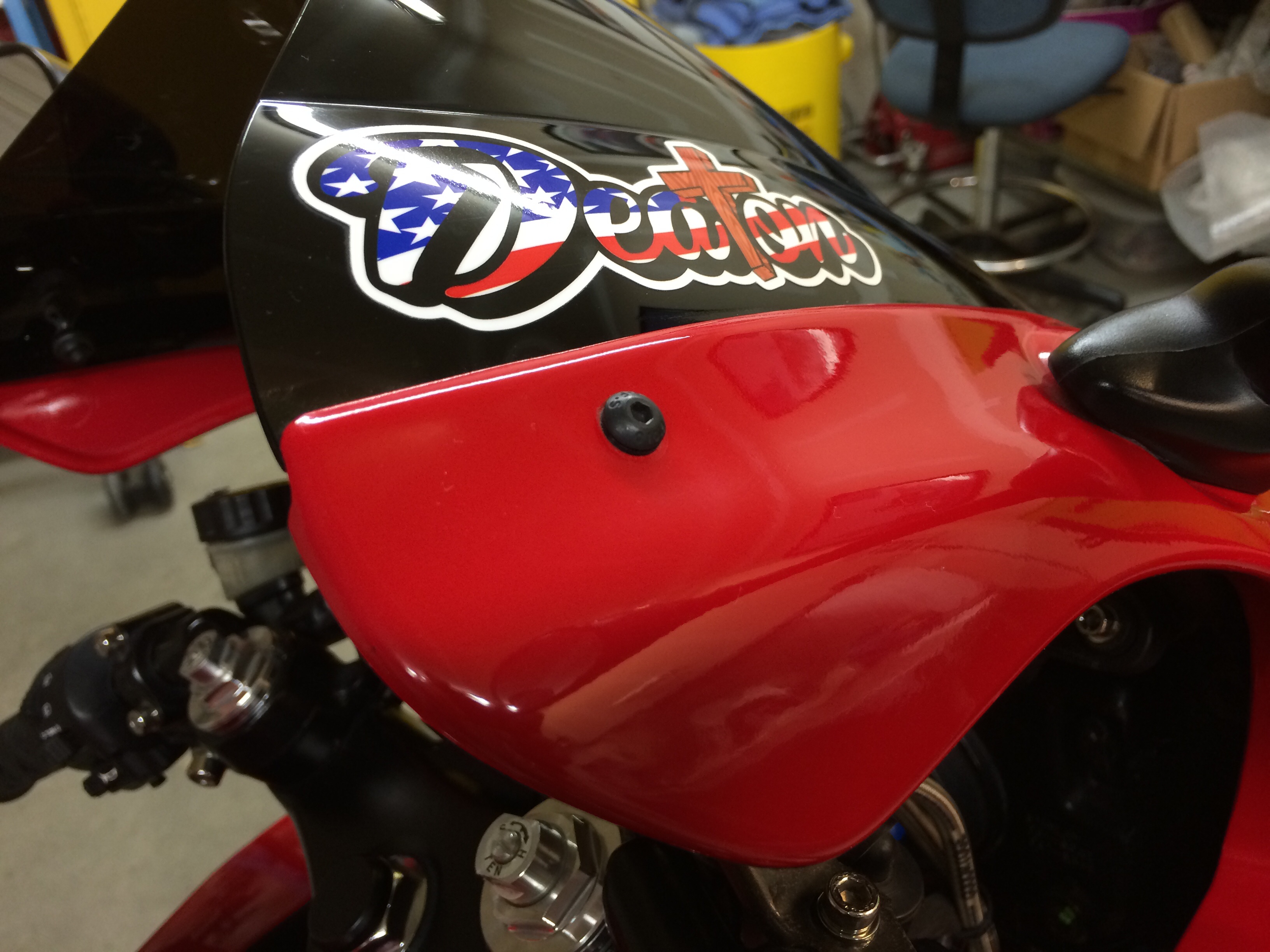

Installed low profile (and smaller diameter) windscreen screws and washers...
Why? Because I can
James
