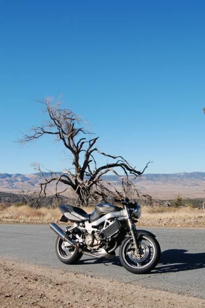

I'm going to endeavor to fix it in the next few days. Thanks for the help. Here's a picture of the bike in Frazier Park (middle of nowhere, CA). That was a great ride loop from Los Angeles, btw, a 300 mi. day. Anyone interested I'll disclose the details...
Old Jul 8, 2010 | 06:02 PM
No need for me..... I used to live in Frazier Park for a while....
