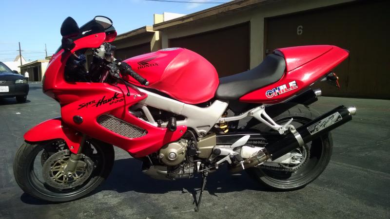

Forgot to mention that i upgraded the R/R for an 03 R1 too! Today i put it together and cleaned it..
Attached Thumbnails One exhaust getting hotter+popping-img_20141026_125907384.jpg
