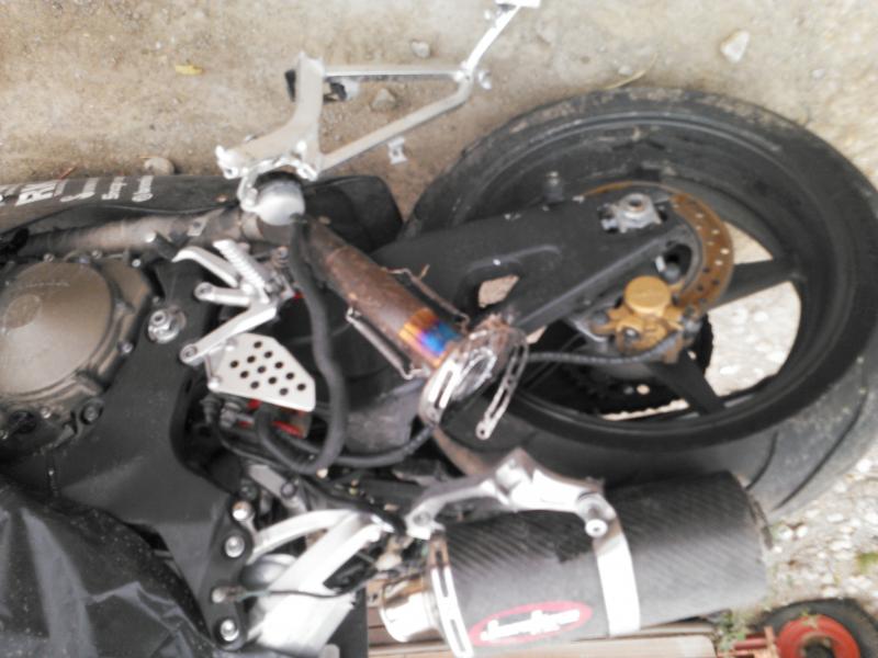

I ran across a wrecked 03 at a local yard. It has a USD fork, I think a Honda RR fork and wheel. Looks straight. I can get it cheap. Anyone id it? Sorry about the photo!

1krr i think it looks like to me... if its straight...its probably worth it!

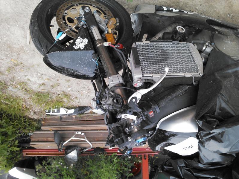

Here are a couple more pix.

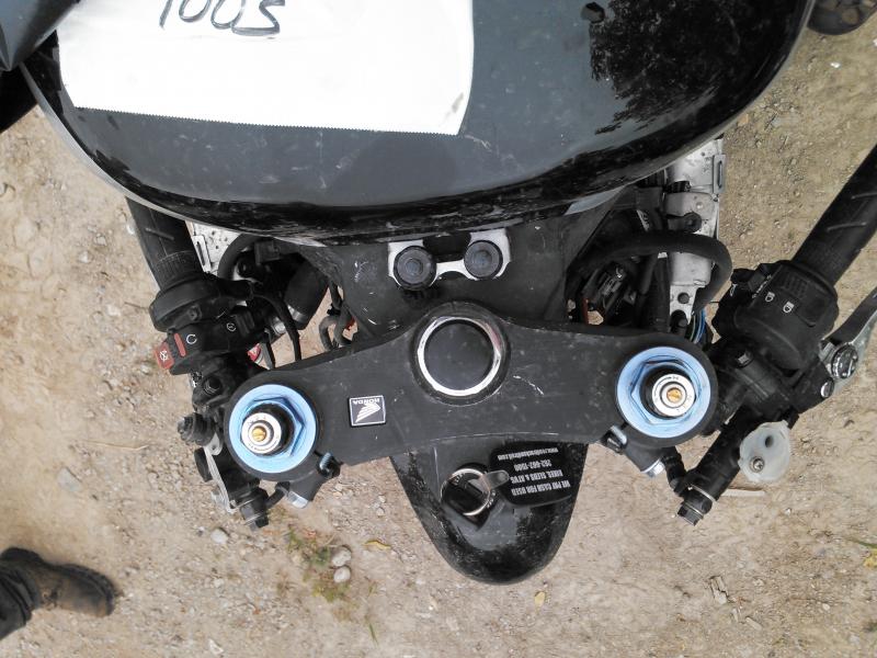

xxx

The forks are from an RC51 (bracket holding calipers is a giveaway)....

deffinatley RC51 forks ( i have the same on my bike)
now thats not a hawk in the picture, its an RC. its got the lighter sp2 5 spoke wheel which is nice. if everything appears straight you can prolly get a deal.

They're deffinatly RC51 SP2 forks (different preload adjusters than SP1's)

SP2 forks and the triple clamp will not work on a SH
sp2 forks and sp1 clamps will.

stem in the SP2 triples is too big........

All you need to do is source a different triple clamp, there are a couple of different options. Personally I run SP1 triples on mine,

the lower clamps on the 929/954 match up with the SP1 top clamps, I dont know what the differences in the actual stem are though

That will work but with SP2 forks you have to run them pulled up 10mm in order to get full engagement in the lower triple due to the way the fork body is relieved.
So depending on how you want to set up the chassis will dictate which triple clamp you need to use.
As far as stem size the 929\954 and the SP1 are the same.
