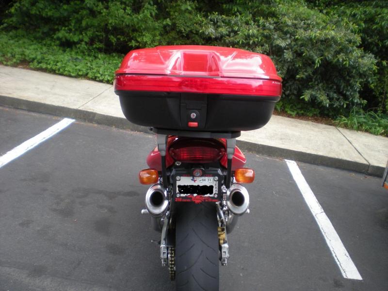

Good job, I installed one on my VTR awhile back. I also wired in two led lights that flash when braking. Like Karbon said.......we can't depend on gadjets and gizmos so save are bacon.....so look out.

Here's a pic.....

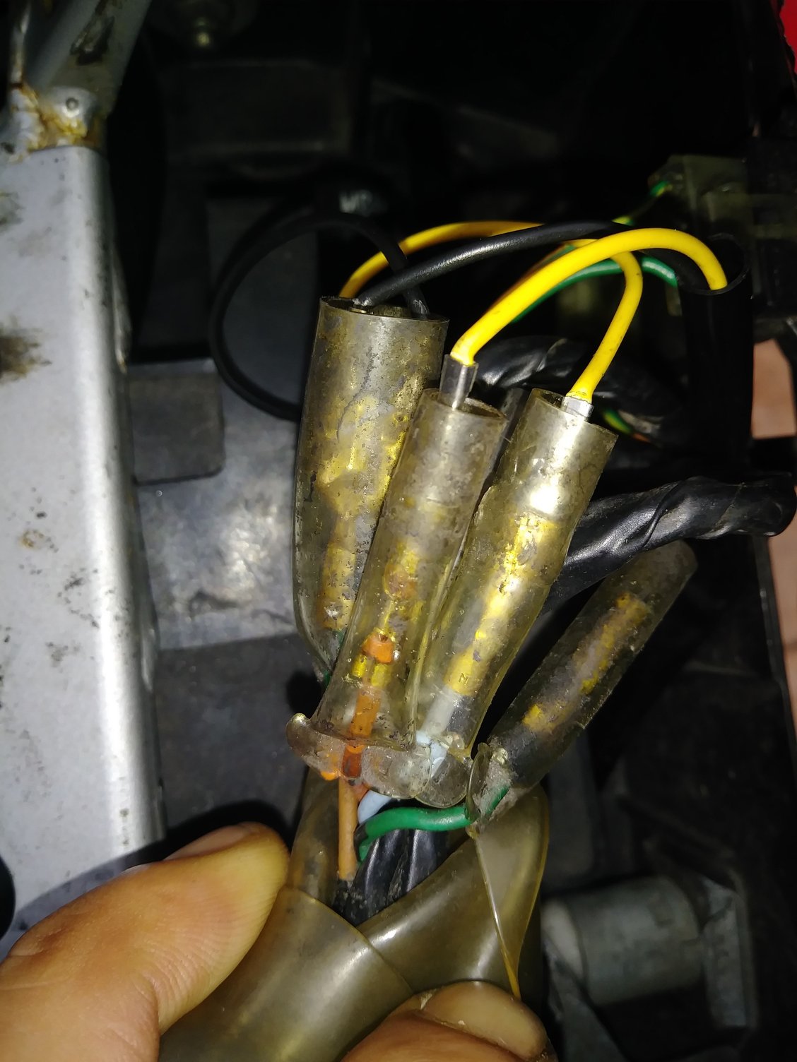

can you point out a picture of which wires ypu connected to it. I just bought mine today but sooo many wires
I've installed many dozens of these on different bikes..
Part of the install difference is which version of Back Off you bought and then how you want the light to flash.
There are several models, some that are "Dumb" and just flash a pattern when brake lights come on, some are "smart" and take a signal from speed sensor
What back off model did you get? and which flash patter do you want to use of those available for that back off model?
Tell me that and I'll give you specifics of wires to use and where to pick them up at.
And no matter what, DO NOT USE the 3M scotch Lock included, throw them in the trash can

i picked up the dumb one today.it's the original back off module. Though once i got it home and opened i saw where the price tag was covering important info.might not work with led flashers. So returning this to get a smart one that works with led
Old Dec 18, 2017 | 01:42 PM
The Back Off modules do not have any interaction or connection to turn signals.
The original Back off had only two connections, Ground, and brake wire signal wire from the brake light circuit
If you have two LED brake light bulbs, you can still use the original Back off if you use a LED light resister in line as you would with LED turn signals and a non LED flasher.
If you have incandescent brake light bulbs, that original Back off modual will work with no other install items.
The wire from the brake switch is cut. the side coming from the brake light switch goes to the red wire on the BO module , and the taillight side of that OEM brake wire connects to the BO module white wire with red stripe

ok so let's go into this cluster **** i have.
I have an integrated led turn signal cheap ebay one im supposing( came on bike. It has the original oem plugged up to right side of bike) my running lights and brake lights work with integrated.
so i bought some cheap led blinkers and connected them up so I have blinkers.
They blink fast but i dont care because its a little more visible for cars..
i honestly dont know what type of setup it is Turn signal and brake light
Old Dec 18, 2017 | 02:49 PM
OK, so you have an LED brake light then... You can get a Back off XP and it will work with that LED, or you can add a resister to the circuit so the brake light circuit pulls enough power to activate the back off modal
Old Dec 18, 2017 | 03:00 PM
The brake wire should be green with yellow dots..but test with meter or test light.
Should be a green wire to the bulb or now LED unit that is ground, brown that is 12v key on for the tail light, and green with yellow dots that is for the brake light filament in a stock set up or sensor wire for the LED unit.
If you use that Old model Back off, you will need to add a 50 watt load resister like this https://www.ebay.com/itm/2X-50W-6ohm....c100506.m3226
all it does is "use" the wattage the 21 watt incandescent bulb would have
yes i am going to pick up the. Xp later on in the week.honda dealer owed me money so no point in spending my own. When i get the xp ill let you know when i need help on install lol
Old Dec 18, 2017 | 03:46 PM
Take a look at the install now, see if you have any questions.
https://store-wfdoukr.mybigcommerce....20Off%20XP.pdf
Or besides the XP, there is the "hold" version which i just did a few installs for last month https://store-wfdoukr.mybigcommerce....structions.pdf
