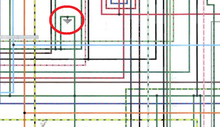

I have noticed that the Negative terminal on the back of the engine got oil spilt on it a while back from the cam chain tensioner, which if you remove the inspection nut has oil behind it. Iv just checked the connector and the connector is fine to the engine block. but the wire clamped onto that connector has soaked up the oil and its gone up the cable. Would this cause any issues?
Also for the life of me i cannot find this ground point... and it seems to be the most important ground point for the wiring harness.
Where is this?
