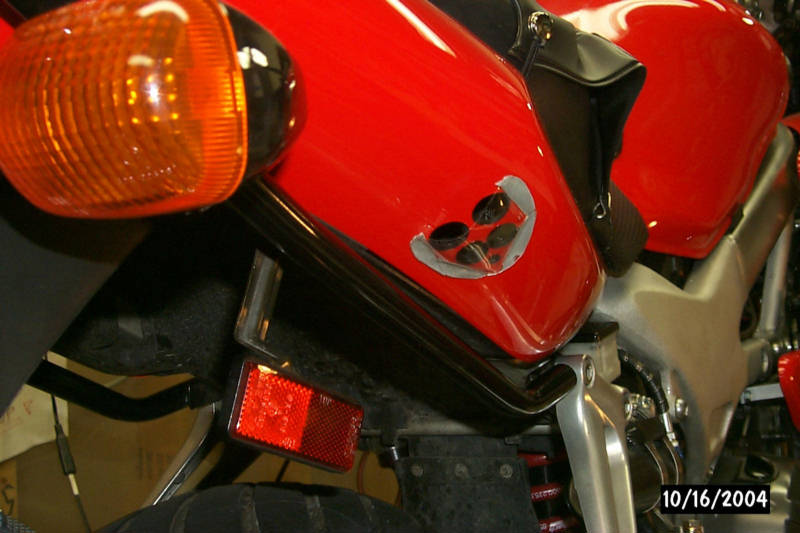

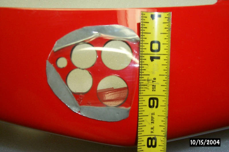

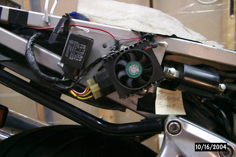

I drilled vent holes in the lower portion of the tail cowl and made a reverse NACA duct over it to draw out heat, and installed a custom intake snorkel above the rear brake fluid resevoir that focuses on the VR/R. I also cleaned and applied heat sink paste between the VR/R and frame and a CPU heat sink and the outside face of the original 98 OE unfinned VR/R. The heat sink has a 12V CPU 50mm X 50mm fan integrated that is powered off the tailight circuit. So far in 50k miles its been a champ but a have a spare non-finned VR/R I carry on long trips and a spare plug with crimp connectors ready to splice in. My onboard volt meter keeps an eye on things. I finally replaced the original 98 battery late this season but the old one still takes a charge and holds +12.8v.
Wow! Got pic's? I'd like to see that.

Here ya go
Attached Thumbnails Done with R/R conversion!-vtr-seat-cowl-vr-r-naca-duct-3-600-x-800.jpg   Done with R/R conversion!-vtr-seat-cowl-vr-r-naca-duct-2-600-x-800.jpg   Done with R/R conversion!-vtr-vrr-air-scoop-1-800-x-600.jpg

I wouldn't go as far as making holes in the fender, but i got mine with R/R replaced. I read about people putting cpu fans on them and since i'm **** about heat i decided to put one on even though my R/R has fins.
Well i noticed that my hawk was idling rough, jumping about 400 to 500 rpms up and down, i though maybe air or fuel or something, decided to take care of it later. I put the fan on w/o ever thinking about the RPM issue. first thing i notice, even after a long run, the rpms jump only about 100 while in idle.
Just food for thought.....
