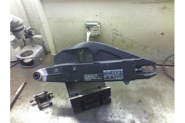

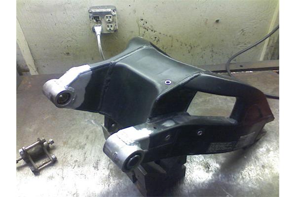

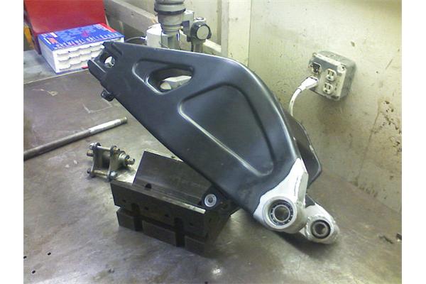

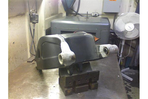

I used an RC51 SP2 swingarm that I modified to fit the vtr. I cut the origional pivot mounts off and welded new mounts on the the swingarm is the same length as a stock vtr swingarm. If you are interested in doing something like this I could do the same modifacation to a CBR954RR swingarm for you. However it is not cheap as a fixture also needs to be made to ensure the swingarm is straight when its welded up. Send me a PM if you are interested. I'll post pics of my bike and a modified RC51 swingarm later today.

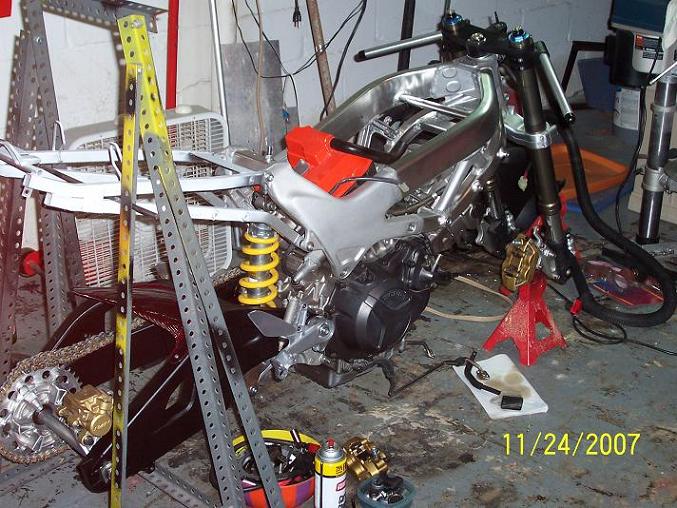

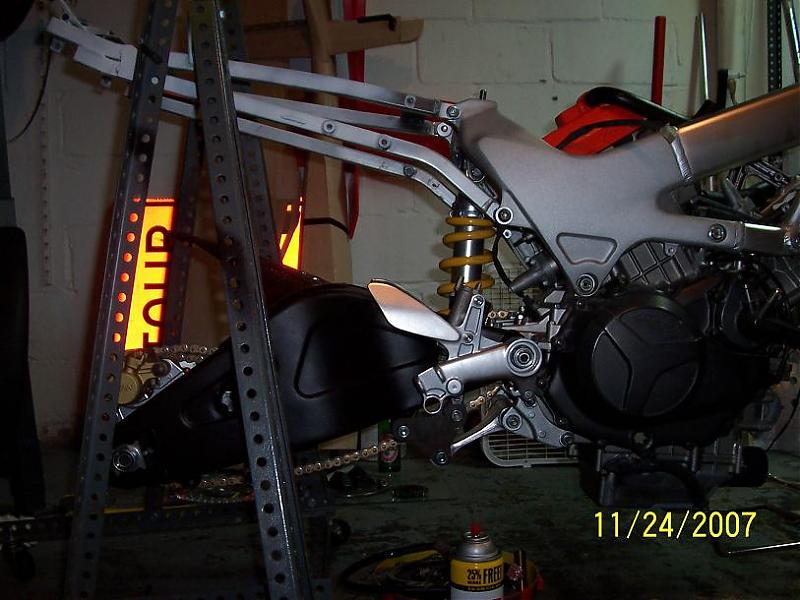

Attached Thumbnails CBR954RR Swingarm - Question for Anyone Who Has Done It-assembly.jpg   CBR954RR Swingarm - Question for Anyone Who Has Done It-profile.jpg

Here's a couple of pics of the shortened RC51 SP2 swingarm.

couple more pics
