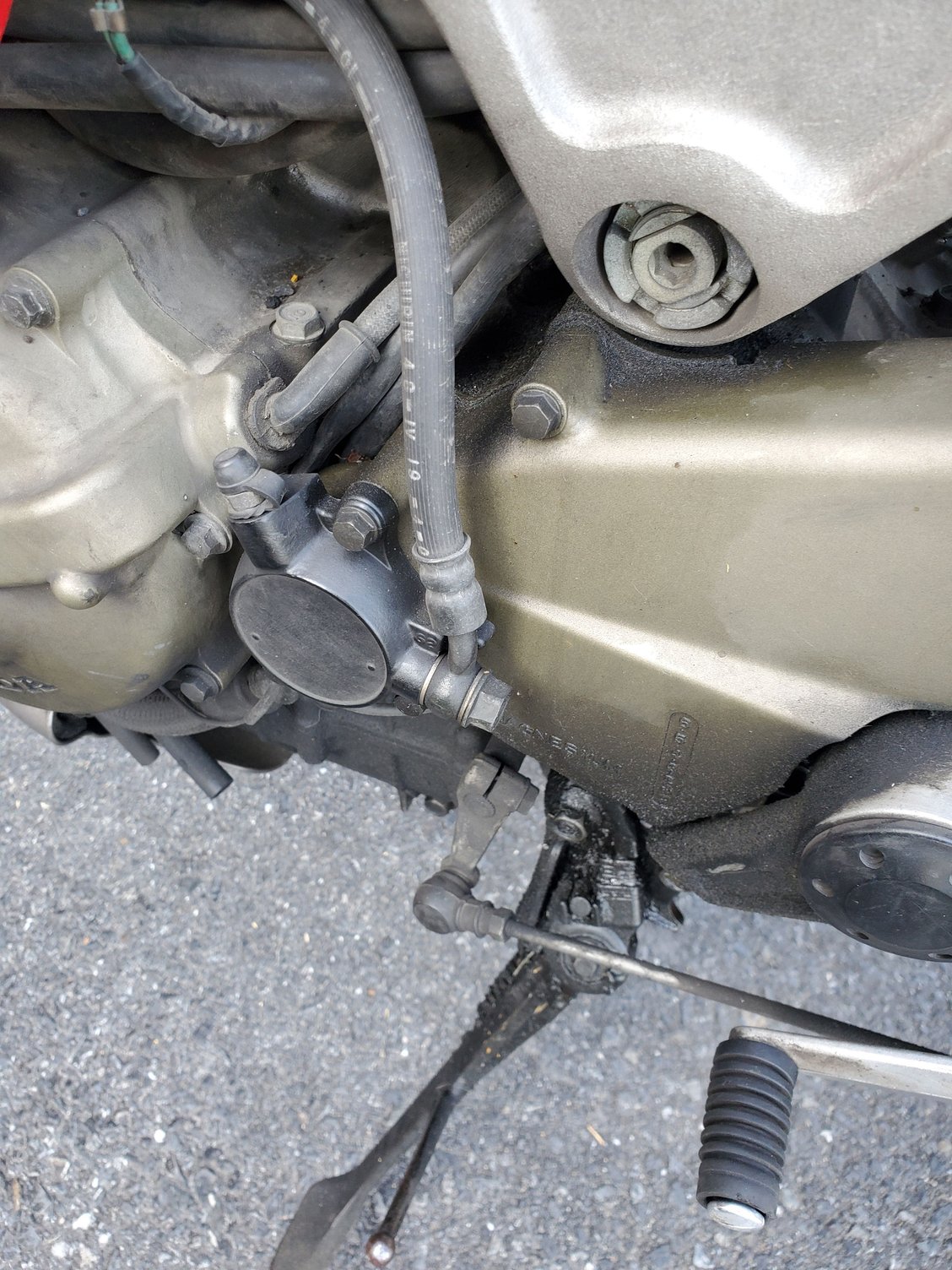

Finally uncovered the VTR to troubleshoot clutch not engaging
No fluid & Slave looks like it sprung a leak.

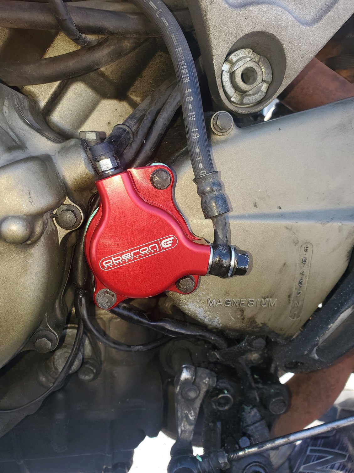

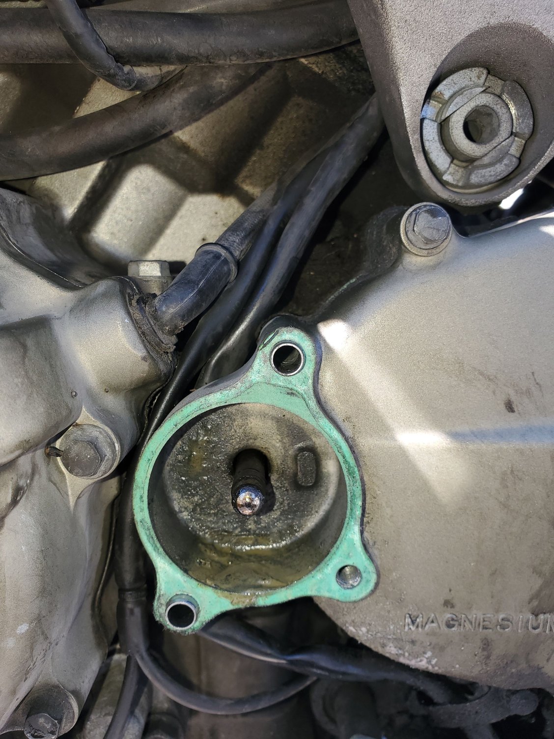

All Good now - Got new one from Oberon Performance in the UK - easy & quickly shipped. Rec'd yesterday & just finished install.
not too difficult to do - PITA was getting old paper gasket off.
Yuckies
Oberon - All Good now!

No - I did clean out the junk from inside & flushed out with new synthetic
