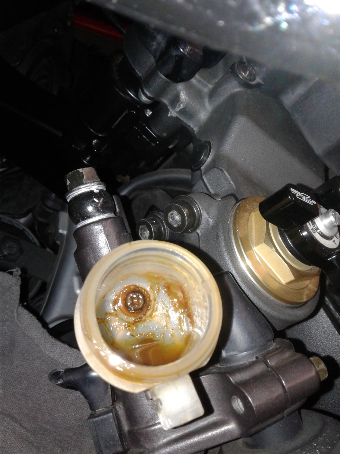

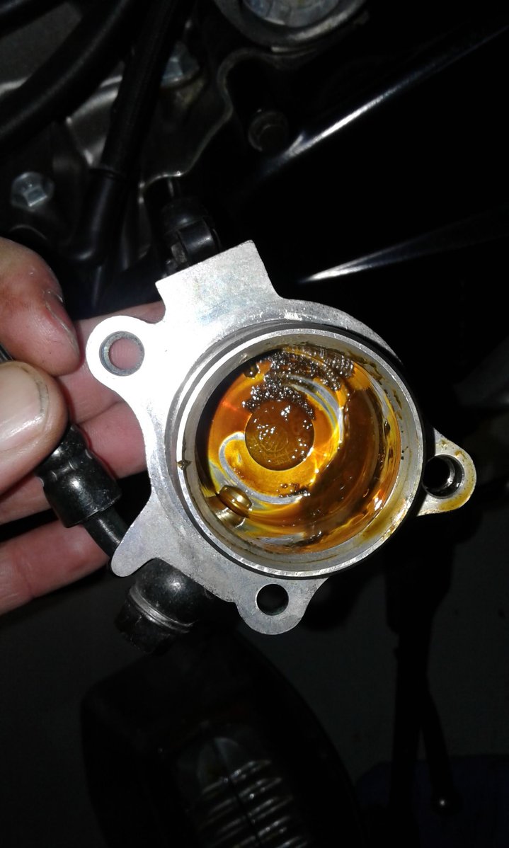

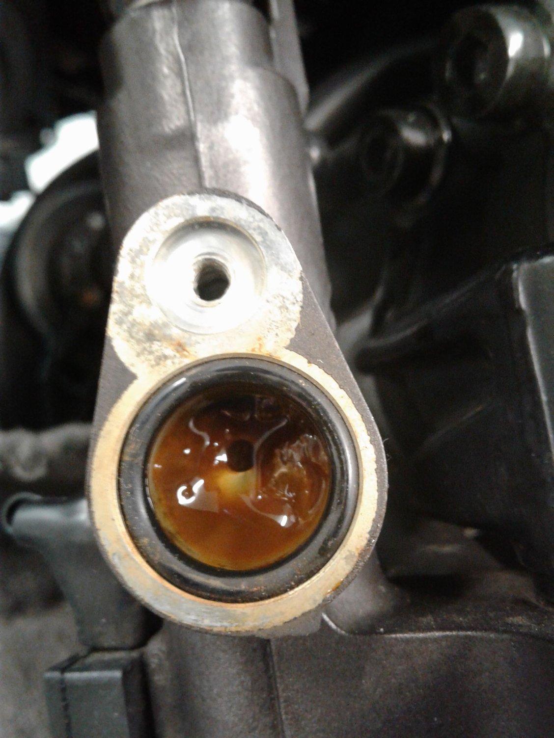

In an effort to keep your issue in one thread, Ill reply here. Brake fluid is hygroscopic. It absorbes moisture. If you have 20 year old fluid in there, Chance are it's looks like this.
Refresh the system first thing. Try to trace the clutch line and feel it for softness or extreme hardness, cracking etc.
Does the slip happen right away, when the engine is still cold? Reason I ask, a highly moisture saturated system could build pressure with heat, essentially pushing in the clutch.
