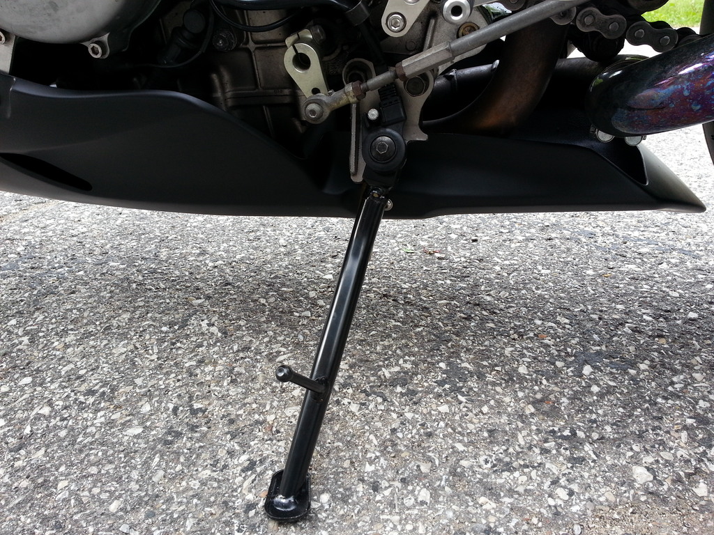

@ one point, I explored that option as well Crux. Eager to see your pics.
I installed a new belly pan today and one of the mounts was sandwiched between the engine case and the sidestand mount. So, as long as I was doing that, I threw the '06 CBR1000RR sidestand on. Works awesome! The bike isn't leaning anymore like it's drunk or had a stroke. Only two modifications were needed for my bike. Like was mentioned, grinding a little metal on the bracket and also bending the foot grabber thingy (for lack of better words at the moment *cough* SoCo 100 proof *cough*
And that's it folks. It just plain works.

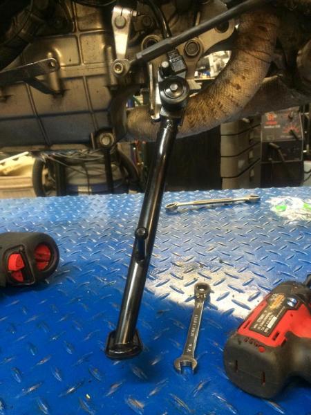

Part Number 50530-MEL-000, Description; BAR, SIDE STAND extended price $28.18
CBR1000R
I milled the stand about 4mm where it contacted the bracket in full open position.

Originally Posted by matt365
I ground a little too much out of the bracket. I wanted it nice and close to the pipe.
We were talking about grinding the bracket at 6 o'clock. So, when the sidestand is down, it moves down and forwards a bit more. Otherwise, it doesn't really "lock" in the down position. Your bike can easily roll backwards and fall over.
While doing this mod, I was behind my bike (level ground) and very gently pulled on the bike with one hand. It rolled backwards way to easily and would have fell over if I wasn't holding it up. This is why the bracket is ground down a bit.
I ground enough out that the sidestand switch keeps the light on in the dash. Ended up pulling the bulb. Problem solved!
What's wierd, is after the sidestand install, I took the bike for a run and during a full throttle up to redline run, my sidestand light came on. I pulled over and played with the sidestand connection under the seat and all has been well since. Just a loose connection I guess.
