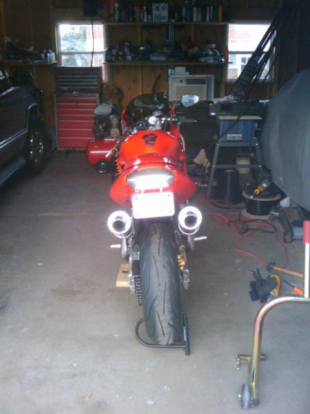

This is what mine now looks like:
Penske shock/sidestand question-2011-03-20-18.24.13.jpg

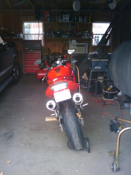

I don't know how much you need, but I need somewhere between 3/4 and 1 inch (probably closer to 1).
This is what it looks like with 1.5 inches:
Penske shock/sidestand question-2011-03-20-18.23.48.jpg
Old Apr 6, 2011 | 09:37 PM
Yeah that is pretty much what mine looks like. I can only park on a hill. I have been parking on a 2x3.

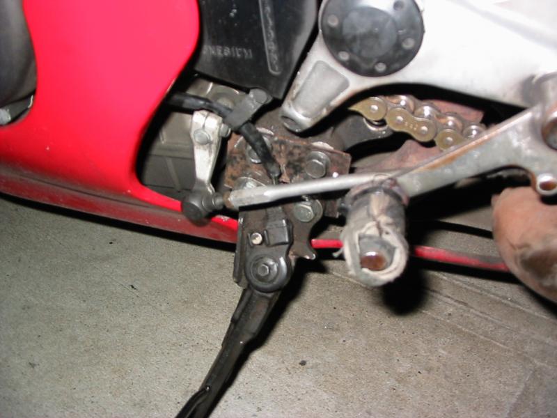

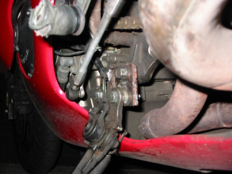

OK so I solved the problem by hacking some steel plates and drilling them and putting spacers. Here is a pic but it was alot of work with hand tool so I cant mass produce them.
The bike leans the exact right amount now so all is well.
Attached Thumbnails Penske shock/sidestand question-sidestand-013.jpg   Penske shock/sidestand question-sidestand-011.jpg
Great idea. I'm starting on mine tonight.
Any idea if it reduces the lean angle any?
Old Apr 19, 2011 | 10:55 AM
Yes substantially. I was worried about tipover before but not now. I wish I would've taken before and after pics but its too much work to swap back just for the pic

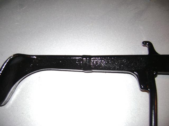

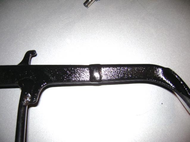

Well, my side stand is now the perfect height and the lean angle is back to normal. I needed 1/2" of length added to it.
I have a friend from work who is an unbelievable welder hook me up.
I brought him my stand and the stand from my parts bike.
This is what he came up with:
Penske shock/sidestand question-dsc03458.jpg
Penske shock/sidestand question-dsc03459.jpg
