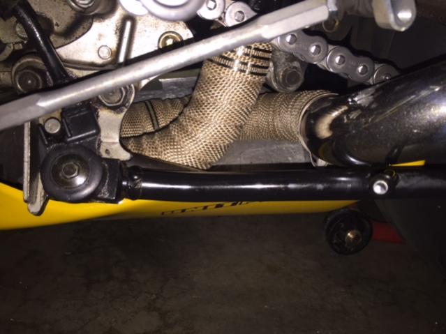

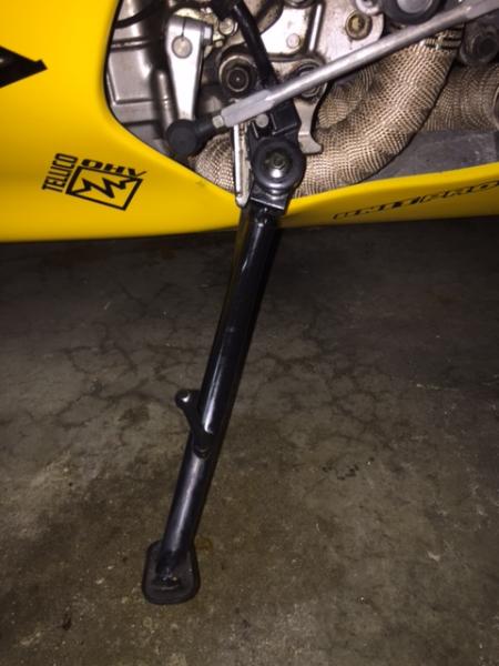

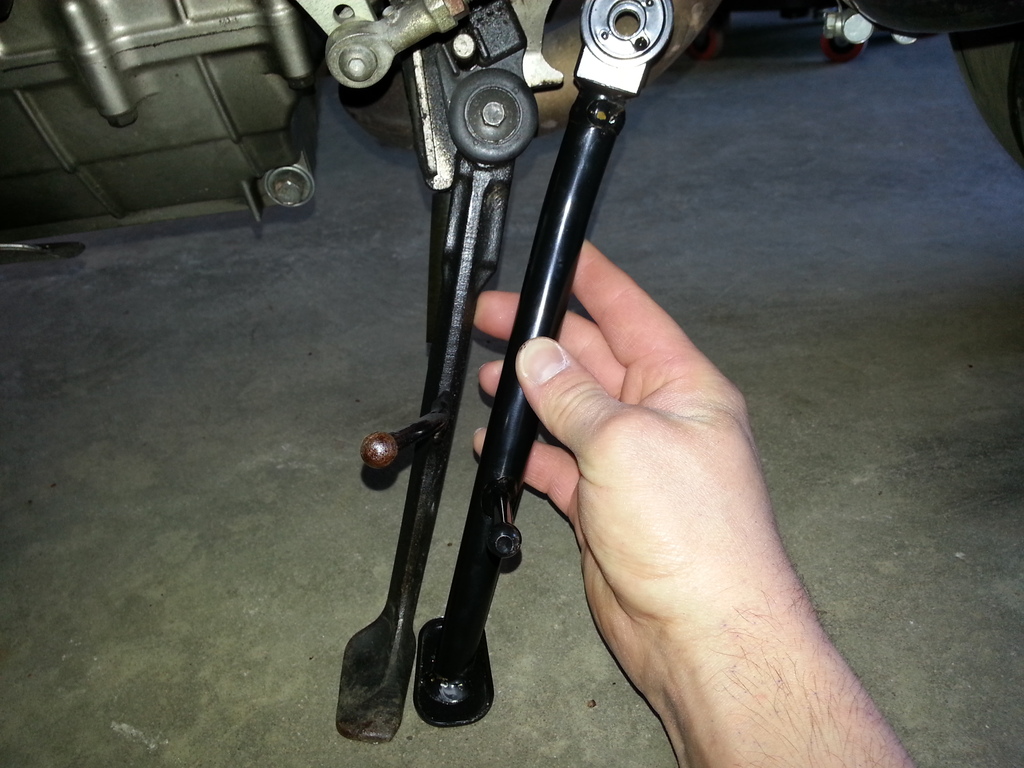

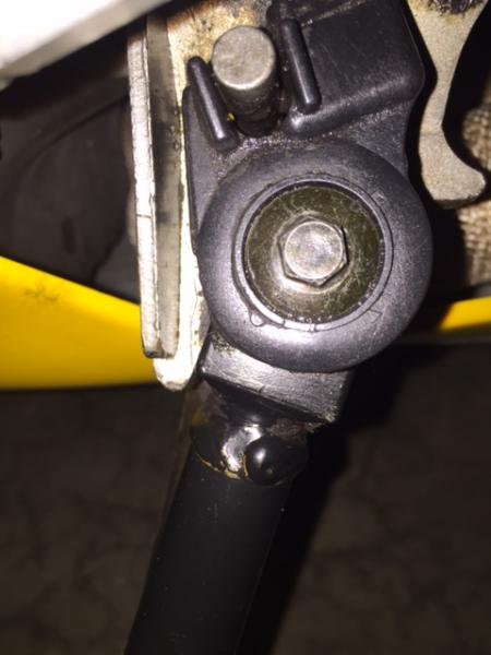

07 1000RR side stand
Hey Guys, I used an 07 1000RR side stand for my conversion. Only swapped the stand out. Used original bracket with switch and bolt. Had to grind down the bracket stop until I had the angle/lean I liked for the bike. Also had to bend the push rod a little to clear my pipes while up. Overall great conversion and easy to do. Cost for me was 28 for the stand only new on ebay. Hope the pics help.
Attached Thumbnails CBR1000 Sidestand yrs-stand-1.jpg   CBR1000 Sidestand yrs-stand-2.jpg   CBR1000 Sidestand yrs-stand-3.jpg   CBR1000 Sidestand yrs-stand-4.jpg
