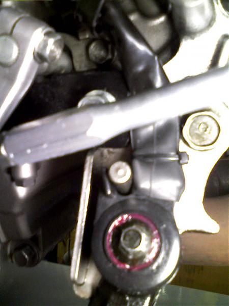

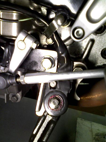

This happenned to me at least 5 years ago and again yesterday. In a moderate-to-heavy rain, the spray from the road really floods the sidestand pivot area and leaks into where the wires go into the sidestand switch and shorts it; fooling the CPU into thinking the trany is in gear with the sidestand down. Yesterday (near the end of a 700 mile ride) it happened as I was in the middle of a 2-lane bridge in a downpour. Scary to say the least. While stopped, I repeatedly worked the sidestand to get it running but it continued to happen intermittently even after spraying it with oil. I finally stopped at a Farm & Fleet just before they closed, and bought some water displacing lube and dielectric grease. I removed the switch and the grease I had previously packed in the backside was still there, leading me to believe the water was getting down inside where the wires enter at the top of the switch. I sprayed with the lube to displace the water and packed where the wires enter with dielectric grease and was on my way. Of course the sky cleared and my on-road fix was never tested. I plan to de-grease where the wires enter and pack in some RTV silicone, and fashion and install a "rain boot".
Anyone else had this happen? I'm sure Honda uses the same basic switch on other models.
Old Jun 28, 2008 | 08:50 AM
Posts: 2,223
The Fix is in
I'm surprised no one else at least commented let alone also have had this problem. Maybe all you other "ChickenHawkers" (a term I don't like but that was covered in another thread) really are chickens and don't ride in the rain.
Anyway, I removed & throughly cleaned the sidestand switch assembly; after letting the 91% iso alky dry, I worked RTV silicone into where the wires go down into the switch and sealed the sides; allowed the silicone to dry, and then made a rainboot out of 50mmlong piece of 21~28mm butyl road bicycle inner tube, sliding it down over to the bottom of the anti-rotation peg slot and snugged a mini ziptie down slightly above, at the top of the boot Icoated the ID with tube patch cement, let it dry and then doubled-over the tube to seal the top and snugged aother mini ziptie down; then wrapped some really sticky electrical tape over the top of the rain boot as a belt and suspenders.
If it shorts out again, I'm removing the dam assembly and jumpering it under the saddle; and will take my chances of a rolling right tipover if I forget to put the sidestand up.
BTW, the blate plate with a bolt thru it behind the shifter rod and above-left of the SS SW is the bottom left mounting plate for my 3-point mount case guards; so don't get confused.
Attached Thumbnails Sidestand Switch Rain Short Out-vtr-ss-sw.jpg   Sidestand Switch Rain Short Out-vtr-ss-sw-1.jpg

I have to assume (u know how to spell it) the light went on. But as I recounted, the first time (this last ride it occurred) it happened on a long 2 lane bridge in a driving rain leading a pack of 7 other riders. The other times that day, again I was in the lead and I was very concerned about getting taken out from behind. My visor was not clear and I was focused on where to pull over while watching my mirrors, and the stand light was not in my direct field of vision. I'm confident the switch was the problem and my fix is the solution. The hardest part is removing the switch cable so the inner tube "boot" can be slide over the plug and down the cable. The plug connects in the gaggle of connections in the clear rubber cover under the seat immediately behind the tank. You have to clean where the wires go into the switch very well (chain oil messes the switch) so that the silicone can be worked into and over the rubber reinforcing section at the top of the plastic body cap. The inner tube must slide down over the hard plastic portion into the "U" groove where the anti-rotation pin bears, as is decinerable in my pics. I'm sorry I did not photograph how I glued, folded and zip-tied the top of the boot, which I wrapped with electrical tape for a double seal. The lower zip tie is visible in my pics.
