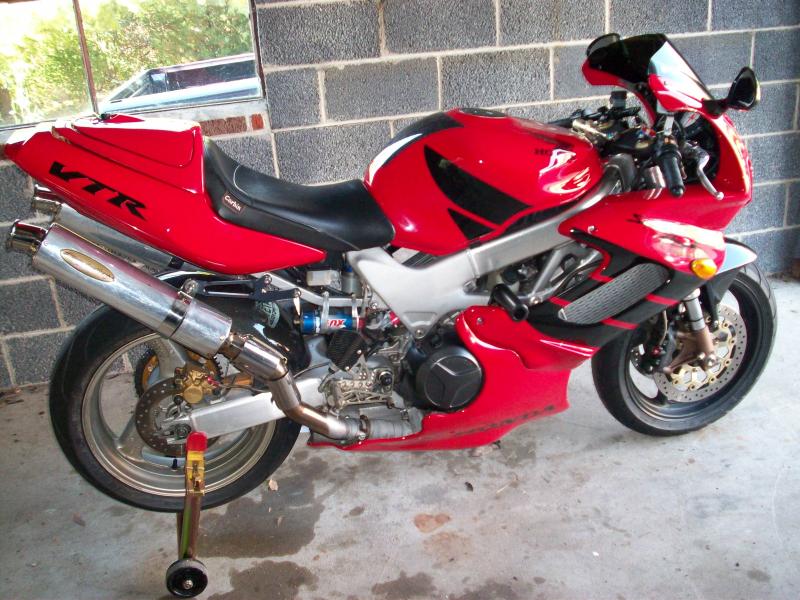

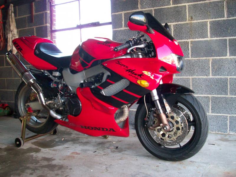

It Kicks ***! Finally got to ride it today. So much better than what it was. It is so flickable now and much more nimble than before. Set it up for my weight and it performs perfect. The radial brakes are what God intended for this bike. It will stop on a dime with one finger! Im still not used to the limited steering at slow speeds. I almost bit it comin out of my driveway this morning. Deffinently the best mod I've ever done. Snapped a few pics...

nice, one day i hope to do this mod, i like your paint job looks good

Yeah, thats nice. Actually you're bike is gorgeous, I really like it. If you don't mind me asking, how much did the whole front-end end up costing? Assuming you did the work yourself.

What did you use for clip-ons?

I think it looks great. I am about to do the same myself. Did you use the 929/954 tripples, or the 1000rr tripples? Any tips would be much appreciated. I also like your lower fairing. Which one is it? The fox rear shock you have. Was it made for the superhawk or was it modified?

Yeah, looks good, what clip ons?

Ive spent roughly $600 and some change, but have made about $450 of it back so far selling parts. All done myself with the great people on here. Used Apex Riser clip-on's that work perfect and are pretty cheap. Used RC51 Upper and 954 Lower from 8541 Hawk with 954 Wheel, 1000rr Forks and Brakes. Lower Fairing is Sharkskins. Fox shock was made for the SH but briefly. For me what limits the movement at slow speeds is the huge Radial Master cylinder that sticks out and it hits the fairing stay turning left just like smokinjoe said lol. Turning right my steering damper holds it from sliding the rod all the way out of the damper. Wooooo lot of questions. Guess I posted in the wrong section...
