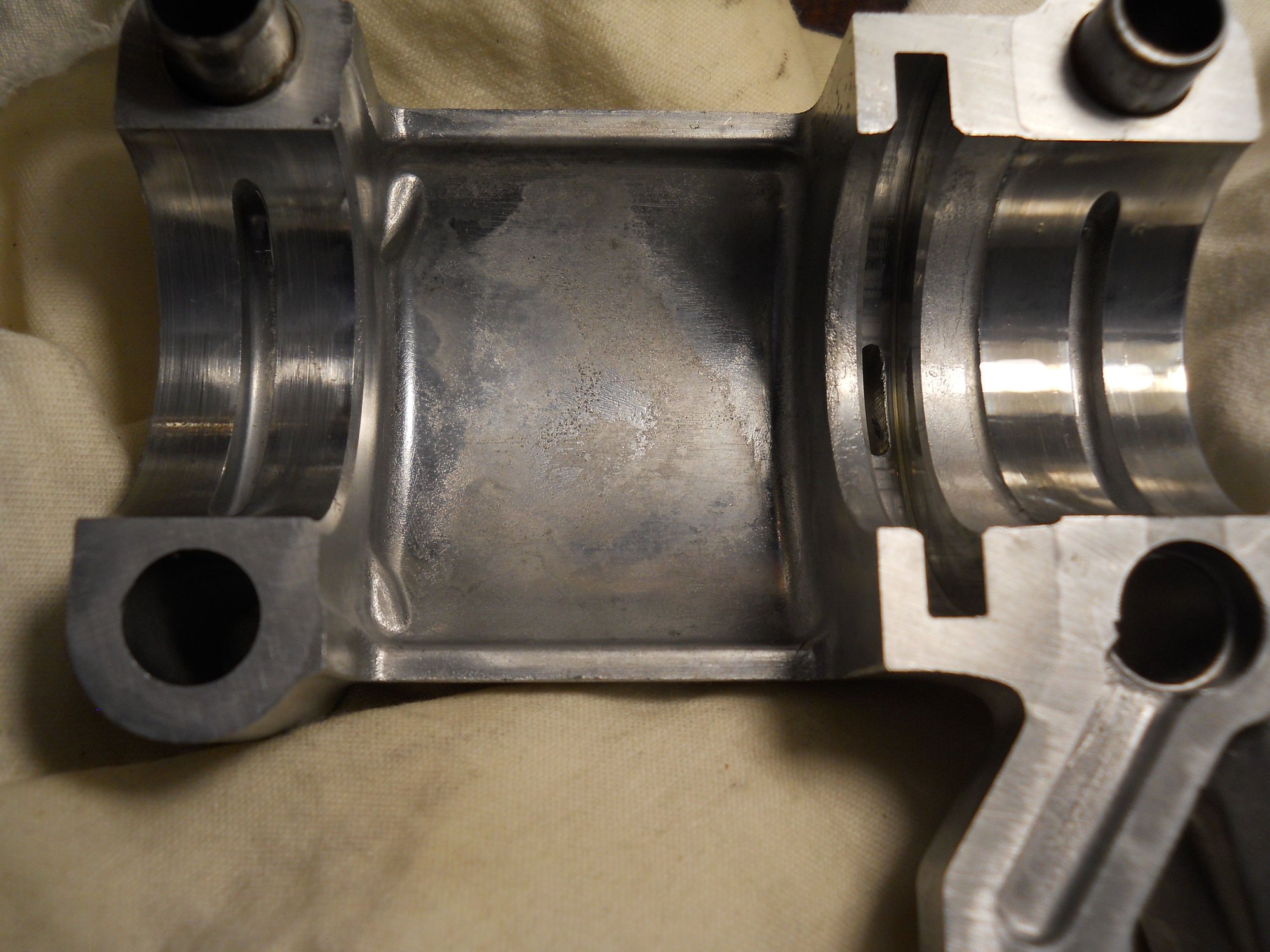

I'm seeing some wear marks on the camshaft holder cap bearing surface furthest from the cam gear; front cylinder exhaust.

Can you share a pic of this wear?

I thought about taking a pic when I posted this but didn't. I can though; it's no big deal to take the front chain and cap/caps off again; I've got to replace the old tensioner in the front still after I finish up the back one.
