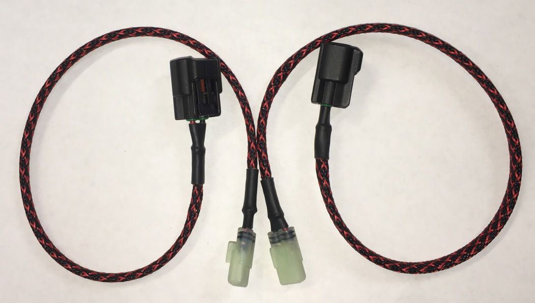

What would you say if there was a no worry, no soldiering, plug in play using OEM quality water tight sealed connectors allowing the VTR owner to get rid of the bulky OEM coils with spark plug boots some 20 years old and swap in Modern Coil On Plug assembles.
No additional connectors in play so no additional failure points over the OEM set up.
What if such a harness was available now, custom made from new highest quality materials. No scaveging used wiring harness and cutting up your VTR to make this work
what if ....lol

Making a set now...
Planning on offering just the harness and harness with a pair of good used coils.. Rider would only need to remove the rubber boot from the stock plug cap and slide it on the new coil

The Harness only is looking to be $49 including shipping to US locations.
The Harness and coils ..... well its going to depend a lot on availability at a decent price ..I got a few so far at a good deal...but the rest I found were not such a good deal, or of untried source application.
I can do 4 sets of complete kits at $74 assuming all 8 coils test good when I get them next week. After that is will depend on market price (kind of like ordering the Fresh caught lobster at your local restaurant...lol )
I'll start a new thread in the classifieds when I have coils in hand and ready to ship.

I think the trickiest part is the "waterproof boot" that keeps water out of the plug opening. I had some lighting bolts arcing in heavy rain. Took some carefulness to get the seal right.
Old Dec 30, 2018 | 08:24 AM
It is really an easy deal if you are willing to use the stock spark plug boots. I've done 1/2 doz now besides my two SH, and all fit well with minimal work.

First set completed.

Got mine in the mail today. Quality work.
Now I need to find the time to install them!
Thanks Erik!

Erik, Got mine today. Great workmanship, as usual. I turned down a few CBR1000rr coils so I can install them tomorrow. By the way if anyone needs additional plug caps/moisture seals to mod for a COP project, they are available from Honda (part #30700=MBB-640) for about $16 ea. If anyone needs a couple of CBR1000 coils already turned down, I have two extras for $25 shipped.
