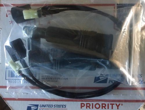

If you have wanted to clean up the VTR frame area up front, shed a bit of weight, replace old spark plug caps, leads and coils by installing Denso Coil On Plug coils...but did not want to hack up your harness or do any wiring at all.... Now you can.
Better then OEM quality modern sealed connectors that directly plug into the VTR wiring harness and coils. If you can unplug and remove your old plug wires and coils, you can install this harness.
Buyer can choose any of the 5 types of cable sheathing I have available.
This MOD uses the DENSO Coil On Plug (COP), sometime referred to as "Stick Coils". In the motorcycle world they have a high time before failure rate, with low known failures overall in common use, making used DENSO coils a good deal.
The DENSO coil like that which comes on the Honda CBR1000 works well with reusing the lower part of the stock spark plug boot.
If long coils are purchased they will come prepped for boot install. The lower section of the coil is relieved so the boot will fit easier over the coil
The coil will come prepped for install of your trimmed spark plug boot..
NOTE I do not supply the spark plug boots to to MOD and use with your COP install. That is on the bike owner to source if you do not have a set currently to use. Good news is used VTR spark plug wires are cheap on ebay, and they can be purchased as a new service part as well.
The shorter COP like found on CBR600 bikes, fits on the VTR plug and head, but will need a different approach then the long COP for sealing out moisture due to not enough coil length though the seal to seat on the spark plug when trimmed. Im only offering the long COP in the full kit.
Two custom harness to adapt DENSO coils to the VTR are $55.00 shipped in the US 48 contiguous states.
Pricing for used long coil and harness kits $89.50 shipped in the US.
Now available brand new Denso coils and custom harness kits $159.50 shipped in the US

Parts came in this morning at 10 AM, 8 kits went in the mail today.... I can only do harness till the next batch of coils show up.
On the bright side, with the wire and sheathing length gauge I made today, another set of crimper's that are optimized for these smaller than common terminal pins, and 8 kits built back to back........Im getting faster...lol
Last one for the day

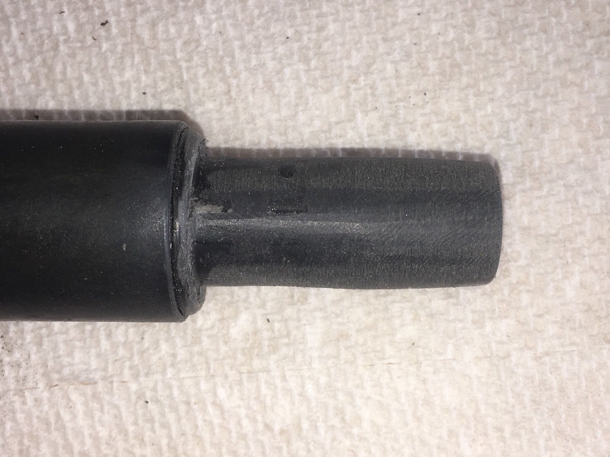

Fit and finish
In order to fit the stock plug boot on the coil, the bottom part of the coil has to be reduced.
currently I’m doing so by hand on a sander with a little bit a file work
it’s not as clean as I would like it but is fully functional
if somebody would prefer to do this fit and finish on their own please say so at time of order and I’ll leave them unmodified.
in the process of building a roller jig to make the modification a little quicker and more consistent but it may be sometime before I get that up and running

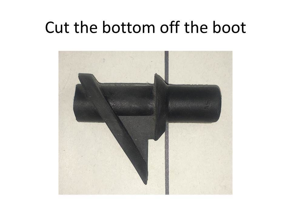

Modifying the OEM spark plug boot for use on COP
