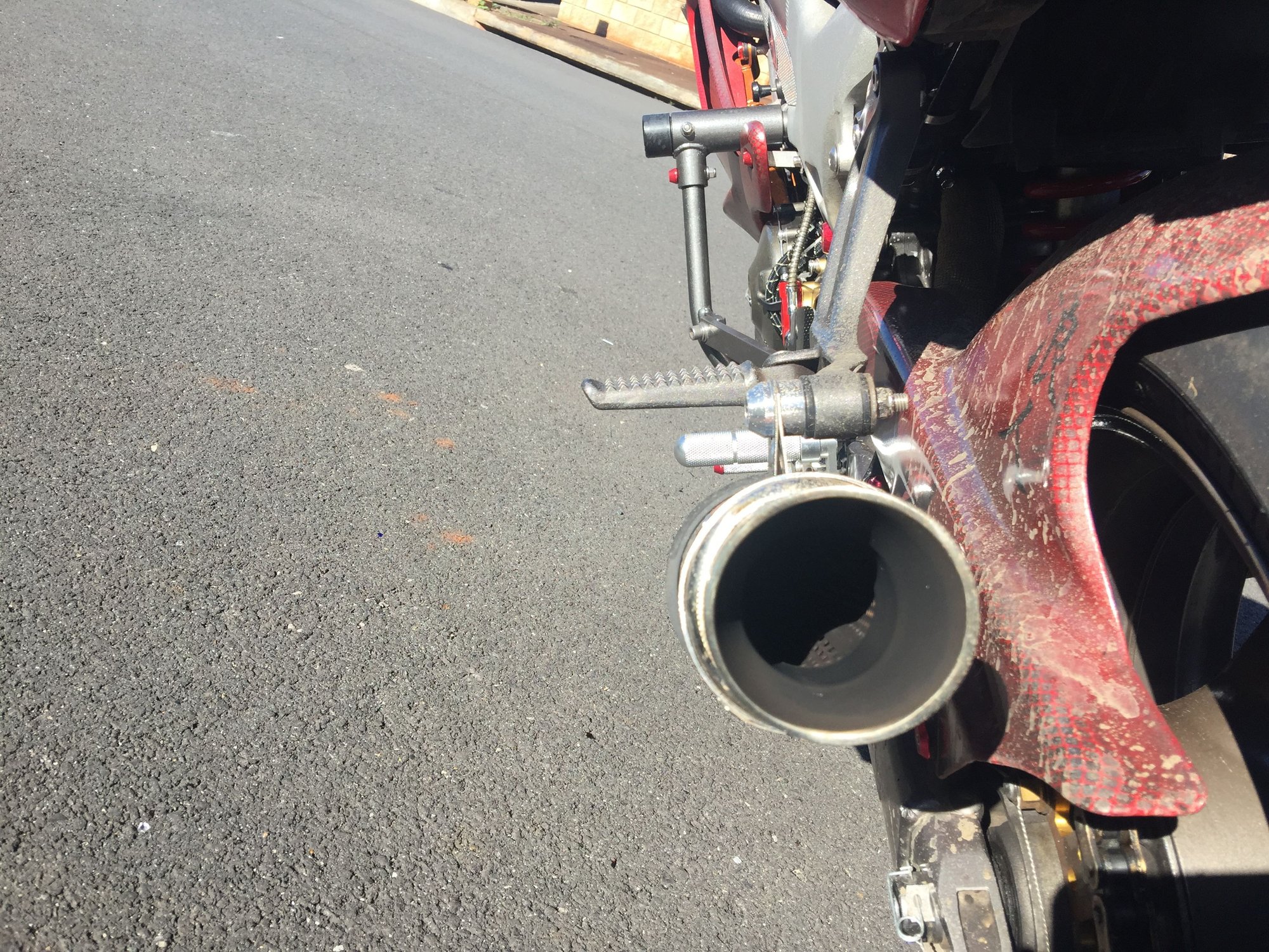

MY Black Widow Exhaust is almost a straight pipe with a bit of baffle at the end. Its basically a GP track pipe. They sound SOOoo Good!
I am considering installing the baffles, if they would provide some needed back pressure for optimal scavenging effect.
I'm not sure how to measure that modification for analysis. Your thoughts would be very welcome!

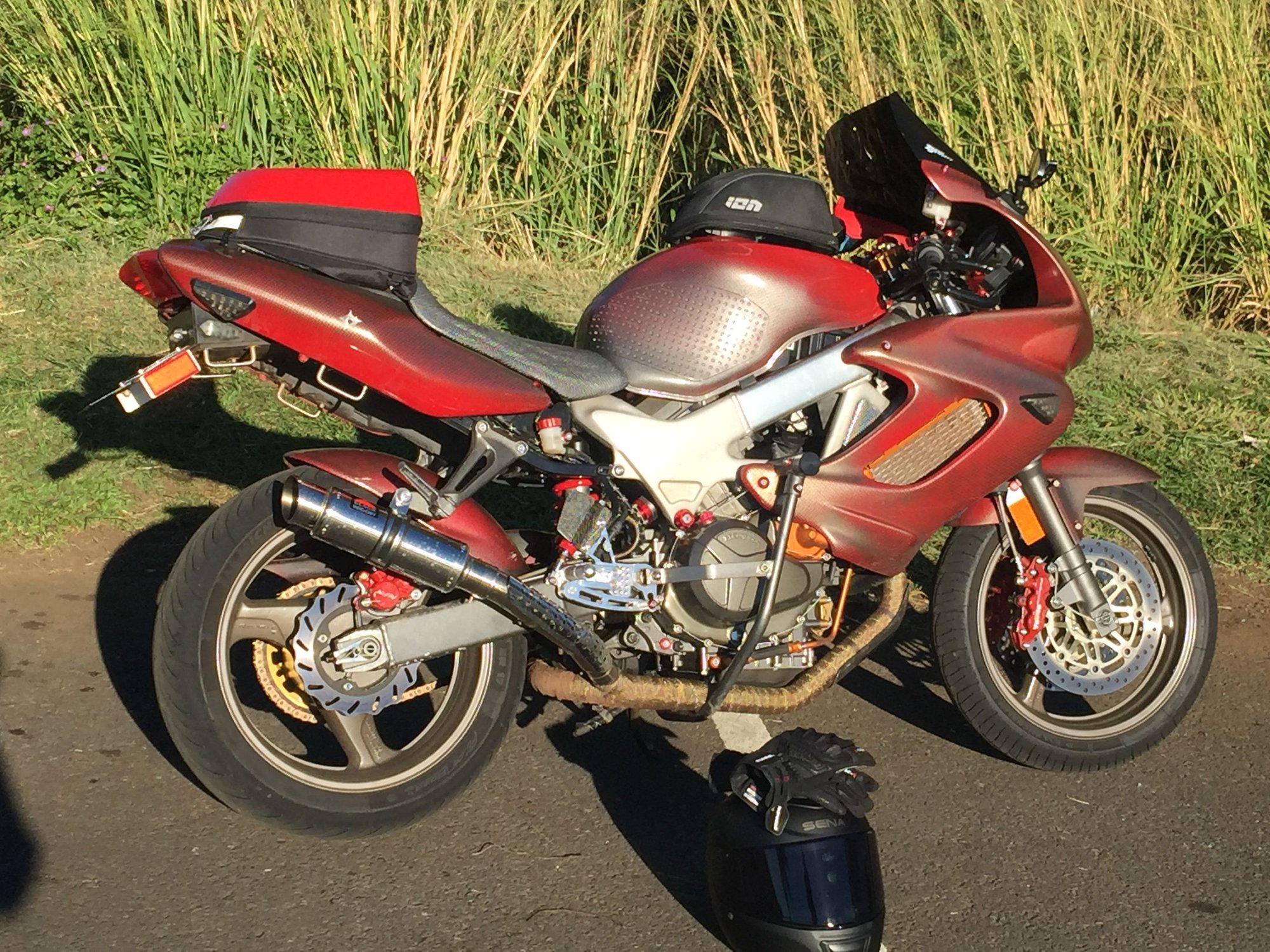

this picture was taken before leaning it out and dialing it in. yes its too rich in this pic
The no baffles might be the cause to the issues you are still having. If you do install them you might need to drop the mains down one size.
This is typical with the Dr Honda stacks.
