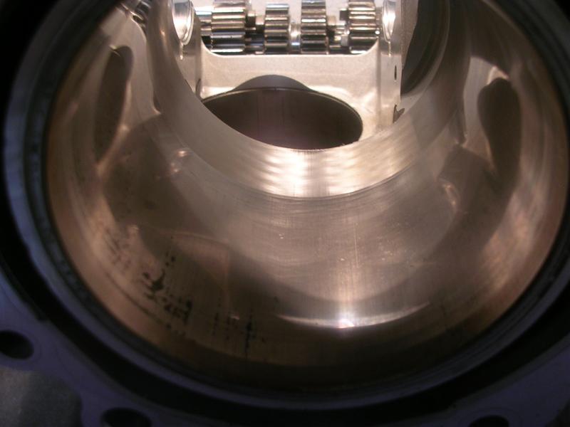

hey guys im really new at this internal engine work.
could someone show me an example of a shrouded and unshrouded valve?
I'm no pro, but shrouding is anything around the valve seat area in the combustion chamber that interferes with flow when the valve is open.
usually seen as a raised lip around the seat...

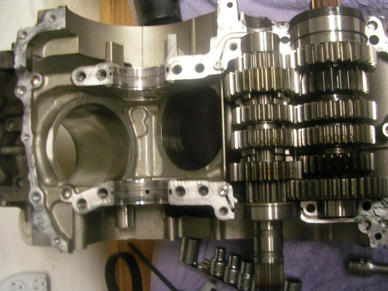

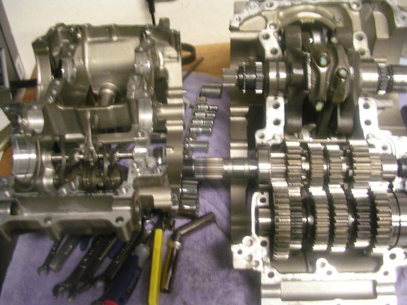

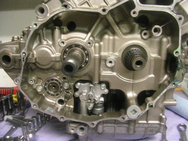

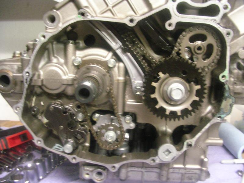

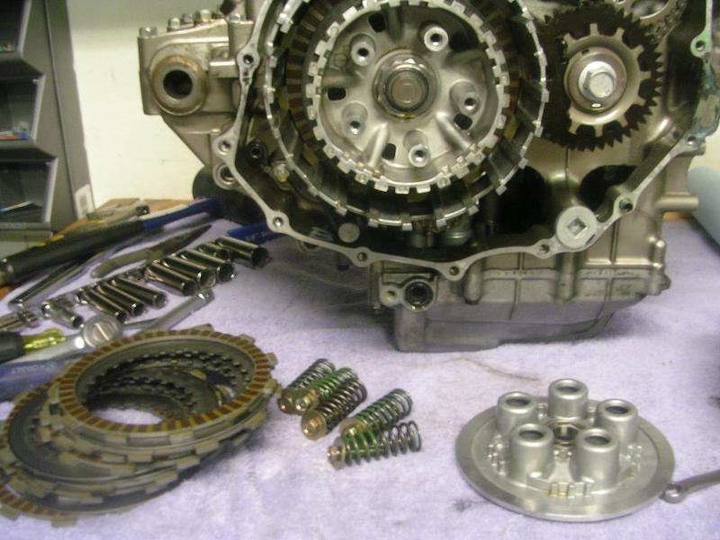

Okay, had to get my hands dirty again tonight cuz the grease was wearing off my hads from the last time
Here's some pics after pulling off the main gears, clutch & cam chains and runners etc...
Attached Thumbnails Time for Stage I-02-04-09-003.jpg   Time for Stage I-02-04-09-004.jpg   Time for Stage I-02-04-09-005.jpg   Time for Stage I-02-04-09-006.jpg

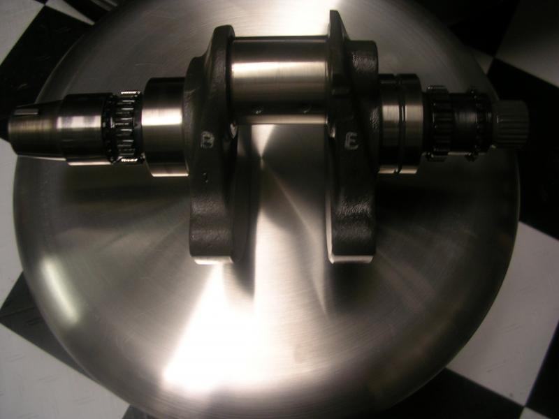

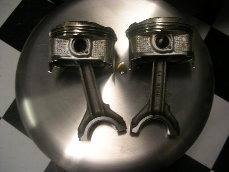

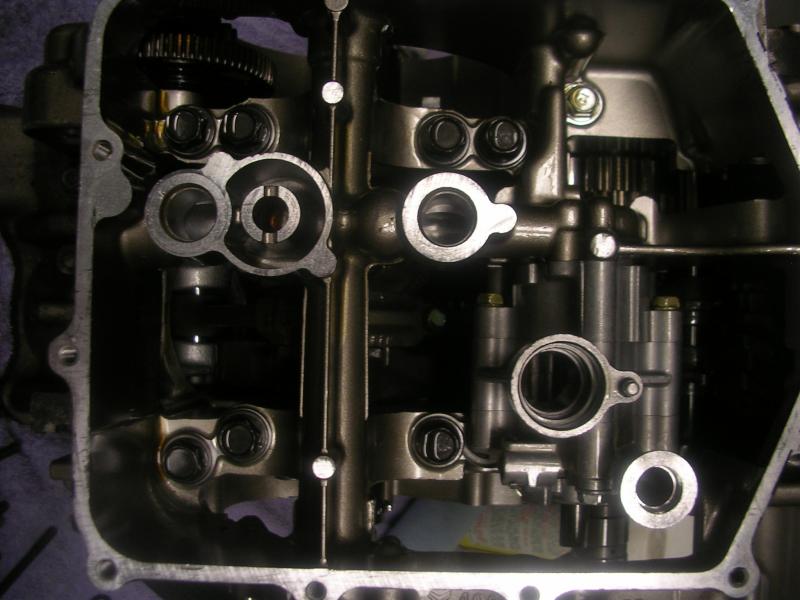

Well, you know i couldn't stop there...so I went ahead and busted it open
Not much blowby at all past the 1st ring, so I'm hopeful the jugs aren't outta round...
Attached Thumbnails Time for Stage I-02-04-09-008.jpg   Time for Stage I-02-04-09-010.jpg   Time for Stage I-02-04-09-011.jpg   Time for Stage I-02-04-09-012.jpg   Time for Stage I-02-04-09-015.jpg

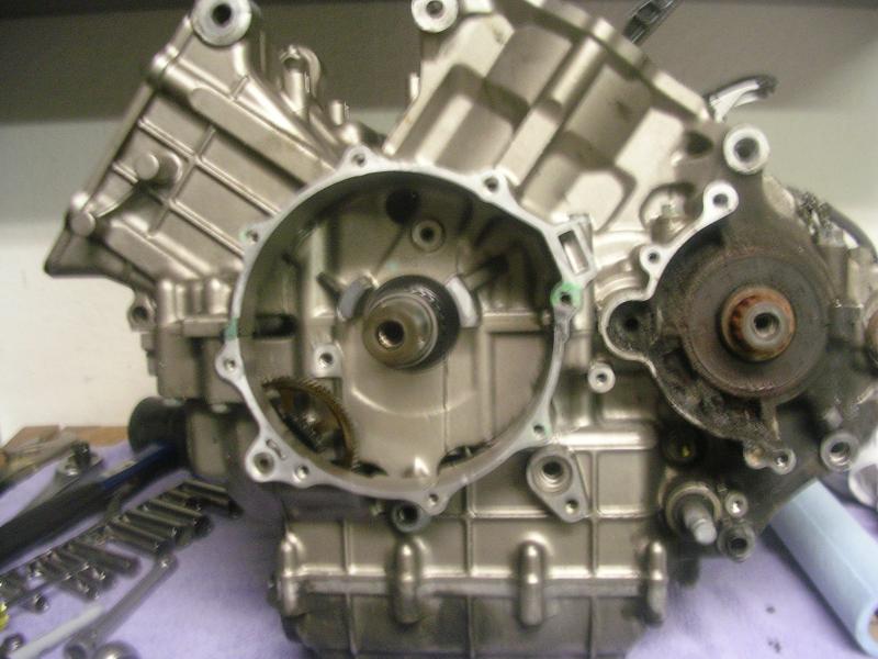

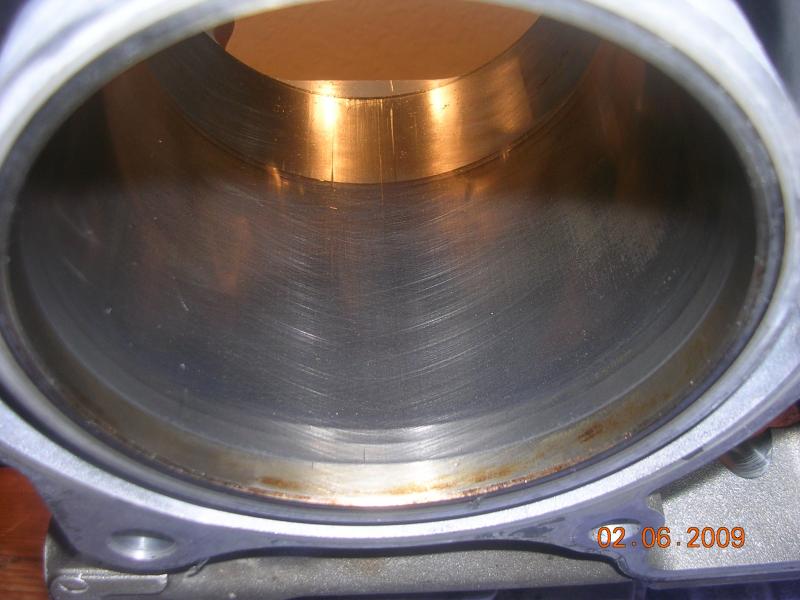

Take a look at these jugs. Amazingly you can still see some of the original honing cross hatch that wasn't worn down by the original rings
Attached Thumbnails Time for Stage I-02-06-09-001.jpg   Time for Stage I-02-06-09-003.jpg

here is some shrouded valves
http://www.034motorsport.com/gallery...qUberHead8.jpg

Good example Bill and compared to that the SH has nearly no shrouding to worry about...RC
