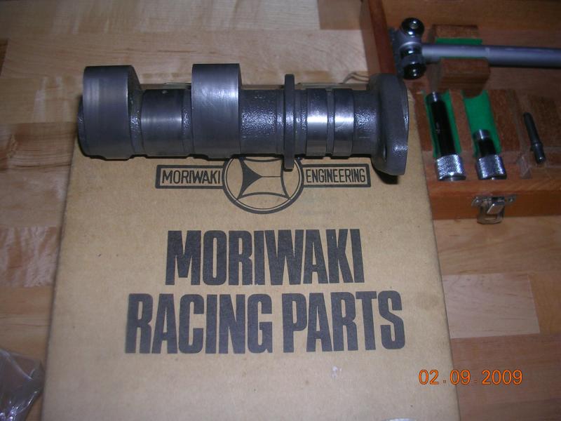

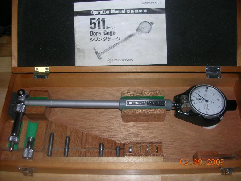

Cams, Velo Stacks & Bore Gage came in today. Who can explain to me how to properly use the bore gauge? I've got a 50mm anvil holder on it with a 2mm washer and an anvil marked 3 that's 15mm long and the bore readings are around 55-56mm
They aren't easy, you'll need to get with an experienced machinist so they can train you. It took me a while to get the hang of it, and I'm still not that great.

use the bore gage to make 4 measurements. 2 at the top of the cylinder 90°apart from eachother (think of a clock 6-12 and 3-9)
make the others at the bottom.
You should be able to calculate how much material has to be removed to get straight round cylinders.

You need to remember that it is just a gauge. It does not make measurements directly.
It should be somewhere in the middle of travel, when it is square in the bore. That will tell you that you are in range to make a measurement.
The most accurate way to set it up is with a precision 98mm ring gauge, but you don't have one of those. The next best way is to set a calibrated micrometer to 98 mm (3.8583 in.). Hold the micrometer gently in a vice, padded with a rag, so it's stable (but not distorted!) Place the pins of the bore gauge between the anvils of the micrometer and sweep it around until you find the minimum and set "0" on the dial fo the gauge. Recheck several times until "0" repeats and is the true minimum, within .0001" (1 graduation on the gauge face.
Take your bore measurements several times to be sure they repeat. The bore measurement is 98 mm + or - the deviation from "0" on the gauge.
Bore measurements should be taken under stable room temperature conditions. Not in the cold garage. The error would be small, but not insignificant.

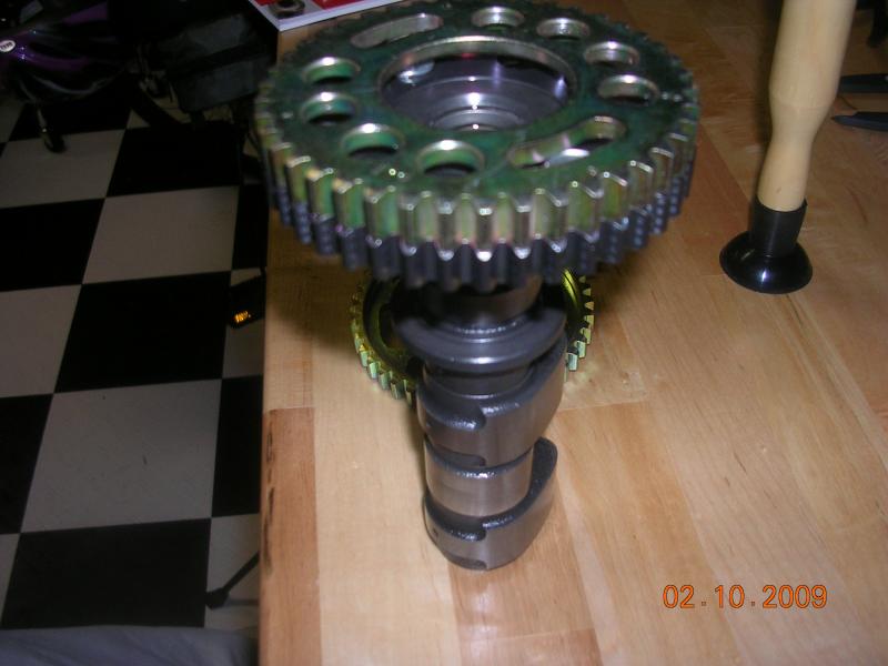

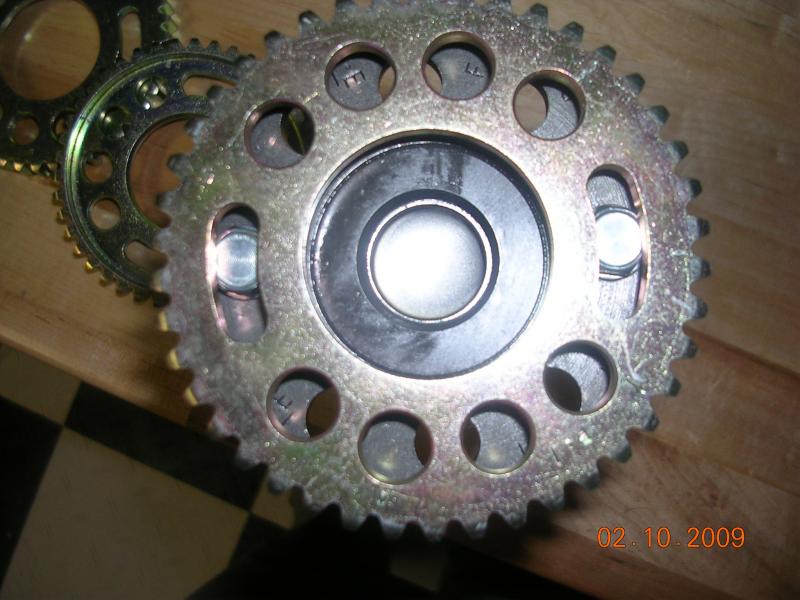

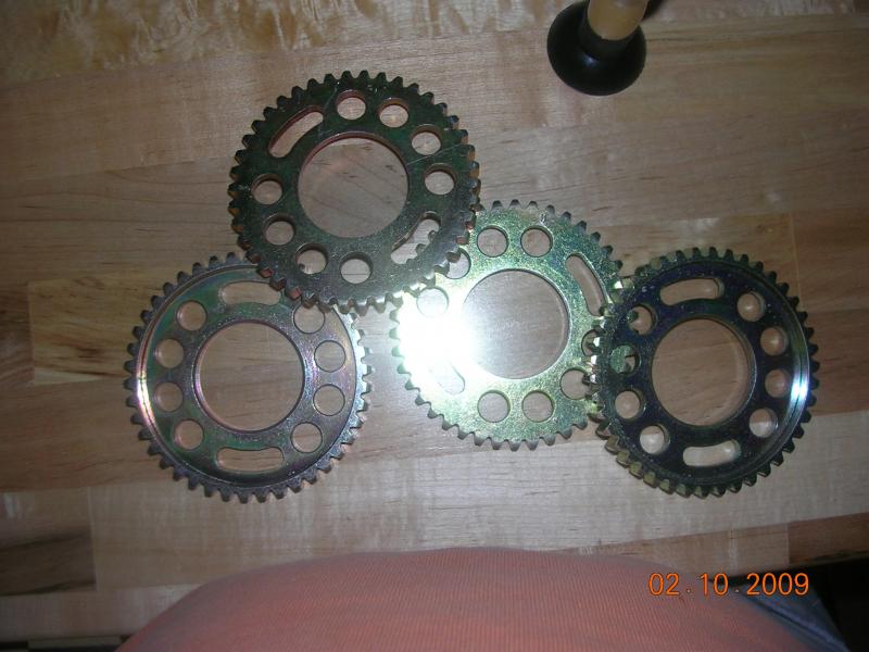

Falicon Adjustable Cam Sprokets came in today and they are better then I'd hoped for! They are marked better than the stockers
Can anyone tell me if I can advance my timing here with these cam sprokets by 2 degrees or if I'll need and electronic or mechanical advancer
Maybe you are confusing cam timing with ignition timing. They are two totally different things.
Items like the timing advancer that Factory Pro makes adjusts the ignition timing by faking out the ECU into thinking that the crank is in a different position, therefore skewing the timing in that direction. This can help build a little more midrange at the expense of a hp or so on the top end.
Adjusting the cam timing tweaks when the valves open/close. This can also shift the peak power up or down depending on which way you go (advance or retard directions). Usually cam timing changes require some dyno tuning to achieve the desired results (what are your desired results?). For the vast majority of us, setting the cams to the spec-sheet is best. Adjustable sprockets are needed because the stock sprockets do not always, if ever, get the cams in exactly the correct spot.
