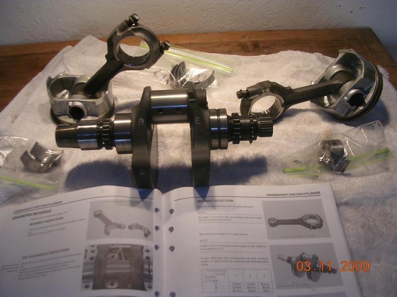

Here's a new pic, but I'll never be as fast as Triplets, I mean Truckinduc
Did the ole bearing color boogie tonight so i can order new rod and main bearings.
Anybody want to guess what their crank weighs?

  #166
Truckinduc's Avatar
Posts: 1,033
I guess thats my new nickname
18 lbs?
Old Mar 11, 2009 | 04:34 PM

FL02SupaHawk996's Avatar
Fastest Color
Posts: 2,091
From: Lithia, FL
18 lbs?
hehehe, if da shoe fits
That's not far off! Mine weighs in at 11.8 lbs...one big baby...couldn't hardly believe it was so heavy
If you have a stock flywheel my advise to one and all is to lighten it cuz with a crank this heavy the heavier flywheel is overkill...RC

  #168
Truckinduc's Avatar
Posts: 1,033
damn I was thinking 12 lbs honestly. But im not good at guessing.

  #169
RCVTR's Avatar
Joined: Dec 2005
Posts: 1,689
Yeah, a v-twin crankshaft is heavy. You don't have pistons-rods 180 degrees out of phase to counterbalance. i4 cranks can be balanced independently of pistons and rods. V-twin cranks have to counterbalance the rods and pistons, etc.

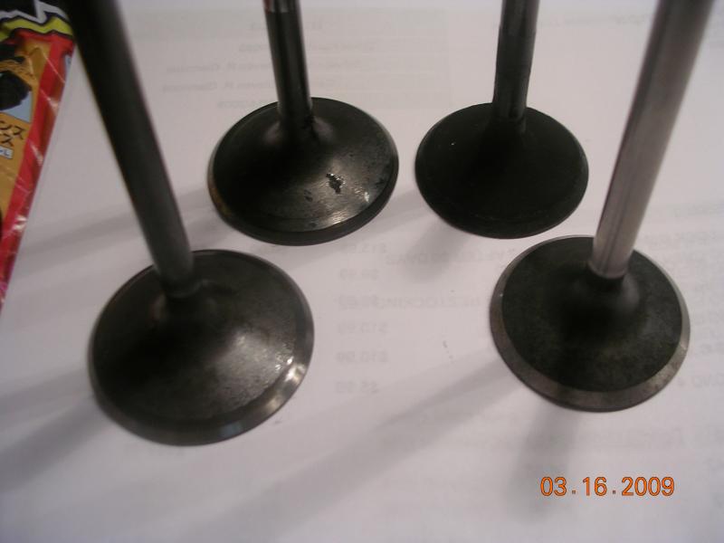

Morwi OS Valves came in today! Here's a comparison pic with OEMs.
Is 'a lot' accurate enough. I didn't weigh mine when it was out but I remember it being pretty hefty.
Where did you find those? Care to disclose what you paid?
A lot is right! I'd have mine lightened and add light weight rods if I had another $2K burning a whole in my pocket
Roger Ditchfield tracked them down for me from the land of the dragons and they cost more than anybody in there right mind would pay
Okay, though I'm not an engine guru like you guys , I have been into my motor by force, not by choice. So I need some education about what the Moriwaki valves have over the OEM - weight? seat cut?
By the way, I was thinking 10 lbs. on the crank.

Chickenstrip, The OS valves are 0.5mm larger on exhaust and 1.0mm larger on intake which allow you to force more air/fuel down it's cullet! Yes, new seat will have to cut in moving them out.
