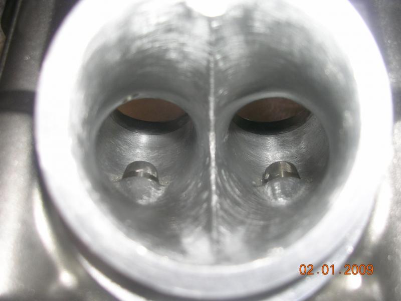

Porting Before & After
here's some before & after bowl shots
Attached Thumbnails Time for Stage I-02-01-09-014.jpg   Time for Stage I-02-01-09-015.jpg

More before & after porting pics
ext ports & int ports before & after porting
Attached Thumbnails Time for Stage I-02-01-09-016.jpg   Time for Stage I-02-01-09-017.jpg   Time for Stage I-02-01-09-018.jpg   Time for Stage I-02-01-09-019.jpg

I plan on turning down some aluminum to plug the pair hole, and blend it so it is as if the hole was never there.

Will it help my performance to plug the PAIR hole in the bowl?
Old Feb 1, 2009 | 05:39 PM
  #78
The performance should be the same weather you plug it in the bowl or otherwise... Altough the bowl might turn out nicer without it and that could possibly affect combustion? Seems unlikely though...
It saves some hassle plugging things on the inside though... just rip off anything pair related...

I see it as the hole causes minimal turbulence when the pair is disconnected.
Thanks man!
Yep, I agree it's a pretty big hole in the bowl, so it could easily cause some drag on gases flowing out...
Thanks,
RC
