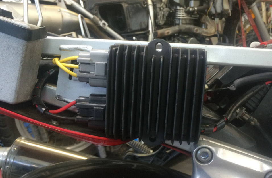

Pulled the cowl off and removed the FH020AA, man, this new SH847 is a monster..
Not going to get it to fit under the cowl as I had hoped
And found a unpleasant surprize
Nothing some nice new yellow, 12 AWG 37/28 stranding, Tinned copper conductor, Tefzel insulation, -50° to +150° C temperature rated
Tefzel insulated wire is in particular outstanding for it's resistance to oil, oxidation, heat, sunlight and flame; and also it's ability to remain flexible at low temperature. They have excellent resistance to ozone, water, alcohol, gasoline, acids, alkalis, aromatic hydrocarbons and solvents.
in a new Furukawa QLW-F-300 socket with silicone seal cant fix
Attached Thumbnails SH847 Series R/R-correded-wire.jpg   SH847 Series R/R-all-better.jpg
Old Jul 28, 2016 | 05:29 PM
Well maybe it'll fit..... just maybe... with a bit of trimming.
But it is bigger for sure
The fins JUUUUUUst interfere with the curved lower inside of the cowl, I'll have to trim just a bit.
Always fun to take a cutting tool to a brand new $160 electronic part
Attached Thumbnails SH847 Series R/R-bigger.jpg   SH847 Series R/R-well-might-fit.jpg
Old Jul 28, 2016 | 05:49 PM
Ok so with some mods it fits under the cowl
New mounting bolts had to be welded on as the FH020 were too close together
Attached Thumbnails SH847 Series R/R-image.jpeg

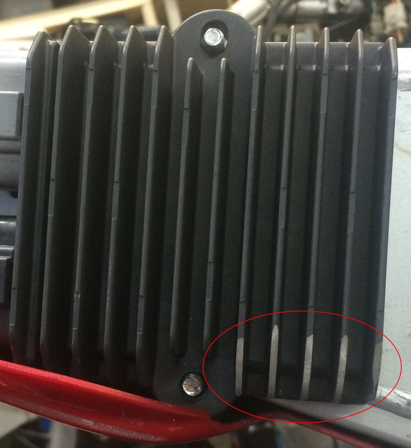

Im very happy with my install some years later.. gently shaving just a few mm on the lower side of 5 fins allowed the SH847 to fit under the plastic with no fitment issues.
Old Mar 2, 2020 | 02:00 PM
Wait, I get it, you shaved yours on the top side, i missed that ,was not where I was looking for the MOD

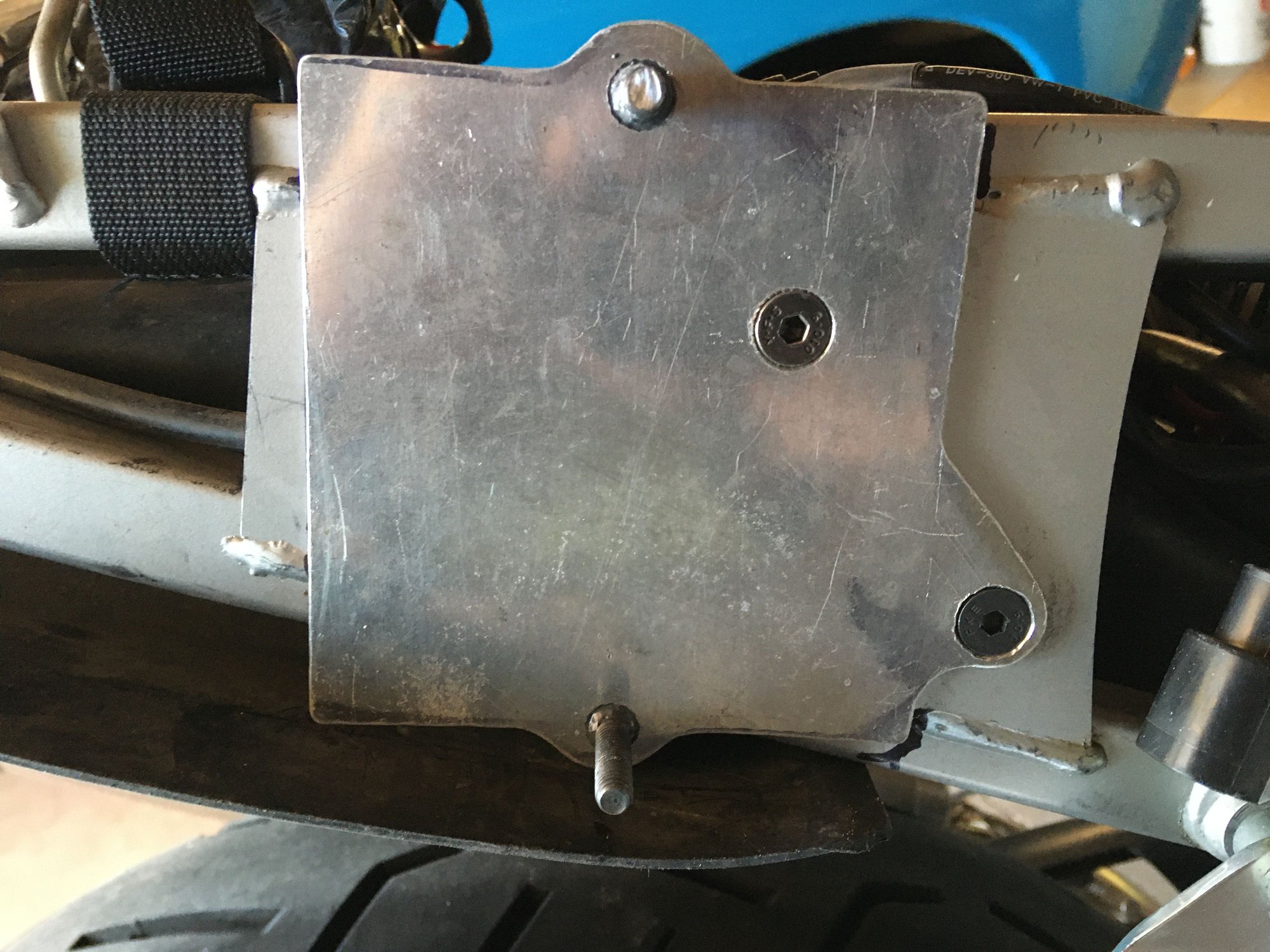

Nice mounting plate though.
I cheated and just welded studs onto the steel subframe to position it where I wanted
Yes, I had to trim the top side to get a small amount of clearance to the rear cowl. Grinding on a new $170 part seemed a bit silly. Would have been better a little lower and back, tighter against the stock under tray.
I see what must be a tail tidy on yours. I don't know if that gave you more space to mount a little lower.
