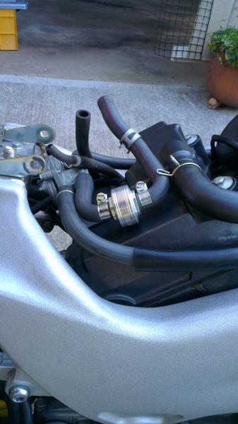

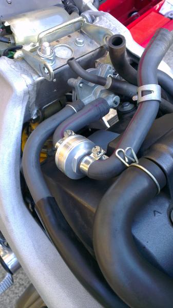

Hi!
Just wanted to pass on the sucess story of installing a re-usable Golan fuel filter on a Storm.. Any owner will quickly realise the lack of in-line filter on these bikes. Yes we all know the tank has an integrated one but does that comfort you?
Most would so no, you cant see what its picking up and you have no idea of its condition or even how fine it is...
Solution- Inline filter!
This Golan product comes in a $53 AUS and is reusable. The 10micron mesh is fine enough to pick up all the nasty's and its fits in nicely on the bend in the fuel line.
Easy install, easy service, piece of mind.. WIN!
Attached Thumbnails Golan Fuel Filter-imag0027.jpg   Golan Fuel Filter-imag0028.jpg

Nice piece of kit. I can only look on in envy. You've got a 19 litre tank. Canada and the U.S.A. only got the 16 litre version which has the fuel tap attached to the tank.

It is an '05 with the 19lt tank your right.. but we also get the carby restrictors on both cylinders limiting us to 100Hp
That's the next trick.. a full carby rebuild with Factory Pro 1.1Ti
