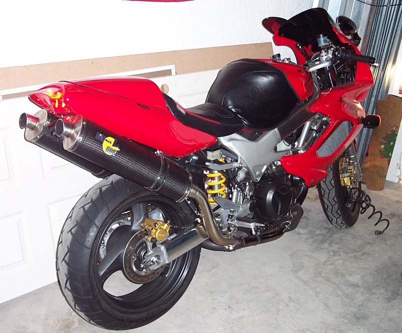

Years back I did cut away a small piece of my stock undertail (along with rear mudflap of course) which allowed me to mount my LeoVince high mount brackets inboard of the rear fairing and pulled my mufflers pretty close together at the outlets. Again it's not 916 Ducati "underseat" but if that's what you want you'll have to fabricate it. And the midpipes required to do so usually look kinda goofy with the stock swingarm.

No I meant the midpipe routing on some of the custom underseat systems I've seen looks goofy. Those are just LeoVince highmount midpipes with the mufflers pulled in closer together.

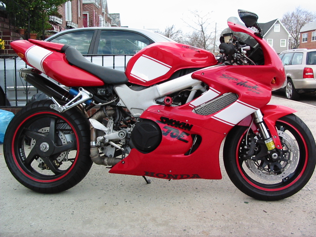

This setup on my B bike came out pretty sano I think. (I am biased). Its not quite undertail but its only a nudge away.
The real issue is clearing that spinning tire.
I love the look of a SSSA. Factory looking, clean under tail exhaust.
I see the "goofy" that Chaos was referring to.
Agreed. That's how Honda should've built the damn thing in the first place.
