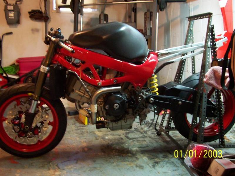

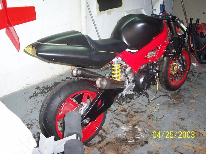

thought id show mine also
Attached Thumbnails Photos of 6 Spoke Wheels On A VTR ... Who Has Them??-maggots-1.jpg   Photos of 6 Spoke Wheels On A VTR ... Who Has Them??-prototype.jpg
Lookin sweet Hawxter. hopefully the date is wrong on your camera or a lot of us will be dead by the time you "get er done"!
hell its been damn near the death of me!
yeah date is more than 6 yrs off.
When you get into unchartered territory like you are, it's not worth rushing things. Take your time and make certain everything is right and it'll likely save time and money and maybe even you're *** in the long haul. looks great so far!
