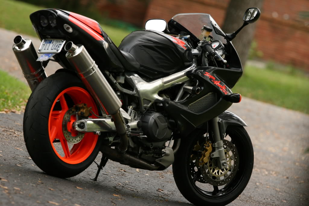

Here ya' go. 900rr rear, 94 vfr front:

Front: F3 and 94-97 vfr bolt right on, no mods. 98-present VFR 800 might have slightly different rotors but I don't think so IIRC. Check a brake catalog (EBC).
90-93 vfr should also bolt on but use a different rotor carrier so you'd need those rotors too.
Rear: 900rr bolt right on. I'm not sure about the RC51. It might need mods (6inch width).

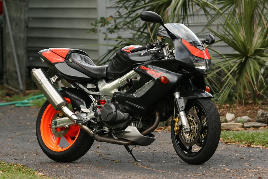

F3 Front, 900RR rear... Centers painted silver, rest is polished... Zero mods, just bolt up.
Attached Thumbnails Photos of 6 Spoke Wheels On A VTR ... Who Has Them??-supe.jpg
Perfect, I'll take mine in white please. I'll be doing this mod over the winter, just waiting on my bonus check in October. They look good.

Yeah. I was going to do them in white too, when I paint the SH white this winter... One tip, get a dollar store dishwashing brush for cleaning them, especially the rear... Unless someone else has a better idea for getting inside the inner spokes?

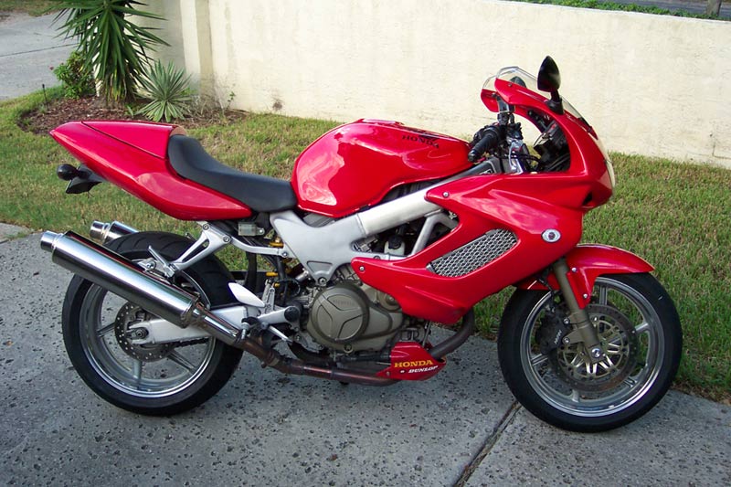

Finally got mine on yesterday... nearly a year after my first post in this thread...

Iv always thought your hawk was one of the cleanest looking out there....but with those wheels its just amazing.
iv got a set i just got powdercoated gold to go with my blue Mario Nava bodywork, i can't wait to put them on after seeing those pics.
is that paint or powdercoat?
