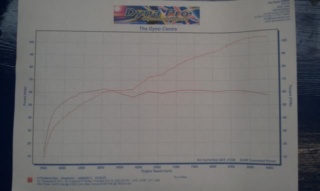

Whilst I havent been up to much lately, I did manage to rope one of my mates to put my bike on his dyno. He used to race karts back in the day and just so happened to have a dyno locked away :thumbup:
He was tuning some karts when I got there one of which made just over 60bhp (not bad for a 200cc - I think- 2stroke!)
IMAG0643.jpg?t=1316015055
After he had done the karts top power run it was time to get my bike on there...
IMAG0644.jpg?t=1316015041
Managed to get a vid of goings on during the run but its not the best...I've got it on Youtube but chuff knows how I link it to here lol
Link is below if somebody can show me how to properly insert the code...
VIDEO0043 - YouTube

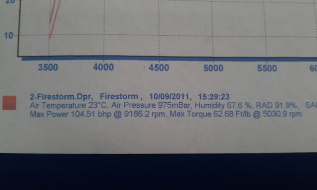

The result...
A very solid 104.51hp!! Considering I have a single sided exhaust on and according to other experiences of such mods I was expecting around 80-90hp it has surprised me very much!!
WELL HAPPY!!!!
Looking at the chart I've got a flat spot in the power around 6k rpm. Any ideas what this could be down to? I have noticed a bit of a stutter previously but seeing it on the chart kinda shows it for what it is.
My only real "problem" is I have no idea what mods have been done to the carbs (if any). Think my mate wants to the carbs down to see what jets are in there with a view to a DJ kit or similar. Any other suggestions? 8)

Nice! 104 not too shabby. Check 8541Hawk's carb setup before changing too many things... there's a link in my sig
