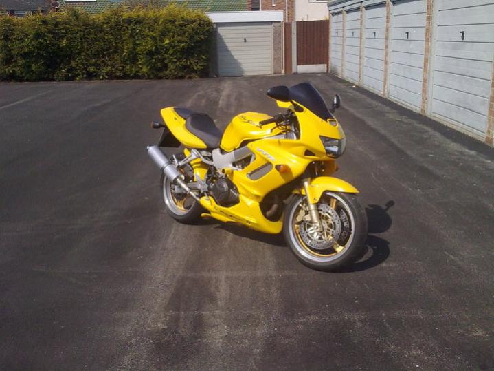

Well the time has come to do something a bit different to poor old "Goose" basically I'm in the early stages of streetfighting my fairly bog standard Firestorm...
This picture is how I bought the bike back in Feb last lear....
Since that picture was taken I've changed the chain and sprockets for 16/45, added some chinese knock off Pazzo style levers and braided front lines (still got the clutch line to do but will do this while the panels are off.
How she looks now.....

Nearly there...
I finally got my hugger, front mudguard and headlight cowl/fairing back from my mate who's spraying it for me.
Pic of me throwing them on...
IMAG0482.jpg?t=1308914426
Got my headlights set up and the beam pointing in the right direction. All the wiring connected and shrink wrapped behind the newly painted and fitted cowl...
IMAG0488.jpg?t=1308914241
Got a pic of the rear end and lights...
IMAG0457.jpg?t=1308915387
And here's a pic of the decals I had made (can you guess where I got the inspiration??)...
IMAG0456.jpg?t=1308914665
Also got this one to go on the front cowl when I get chance
Firestormlogo2.jpg?t=1308608200
Here is an up to date pic of her sat outside the test station waiting in anticipation of a fettle by the test man.
IMAG0495.jpg?t=1308913973
All in all a very busy week, she just needs a ******* GOOD CLEAN!!!!!
I'm still waiting for my belly pan to come back as we didn't have time to get that prepped and sprayed with the other bits so that's something else to look forward to. I think that and getting the wheels powdercoated white will finish off the look I'm after! 8)
I did blow the end plate off the exhaust can when I went for a ride after the test lol so the next project on the cards will be fixing or replacing that
Let us know wot ya'll think :beer:
Nearly forgot....the Lincoln Autojumble is tomorrow, so me and the lad will be popping along to see if there are any deals to be had :thumbup:
