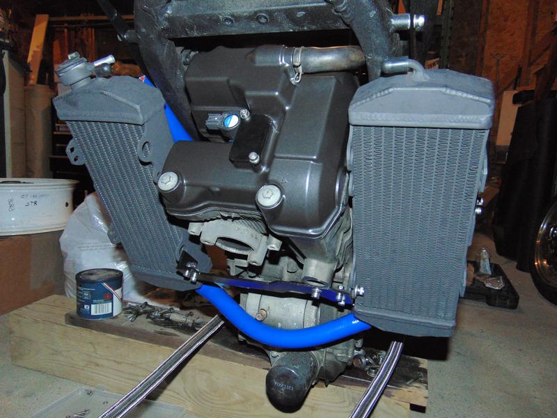

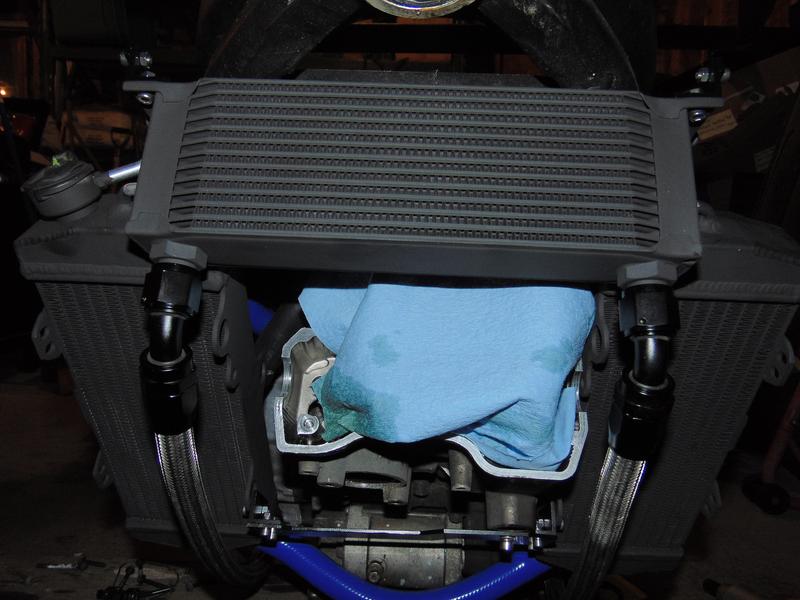

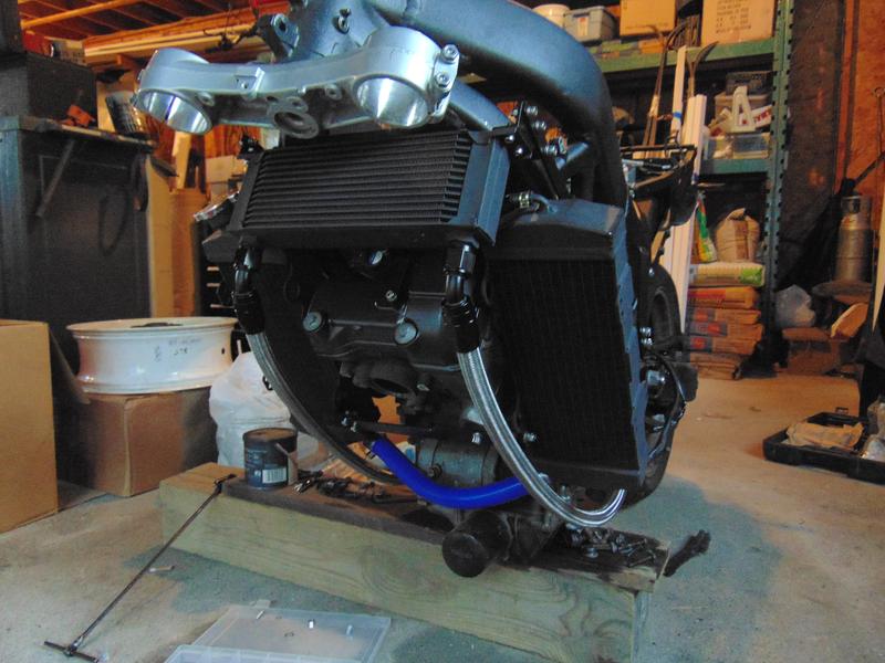

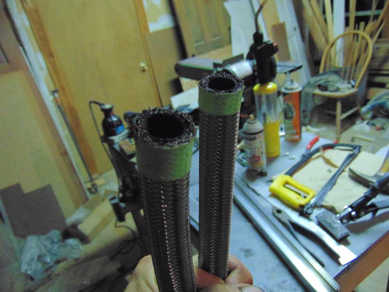

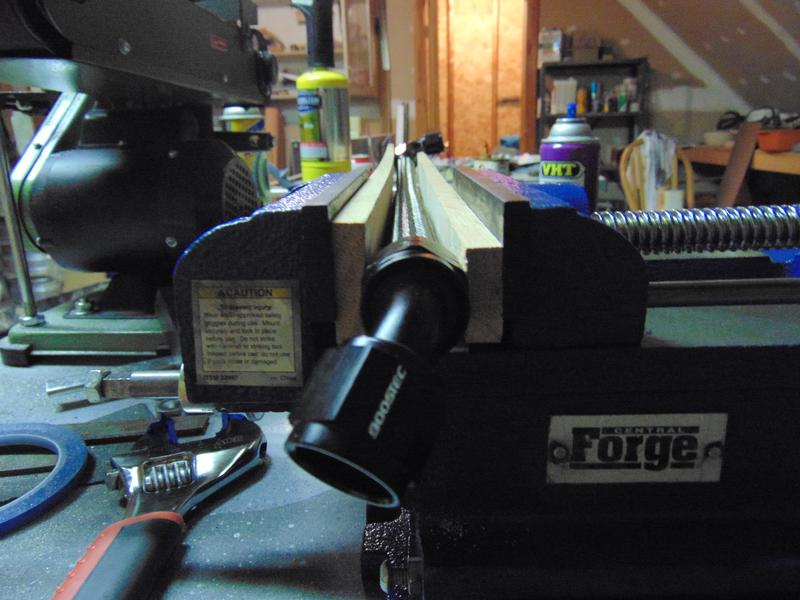

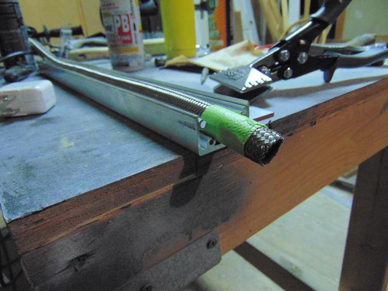

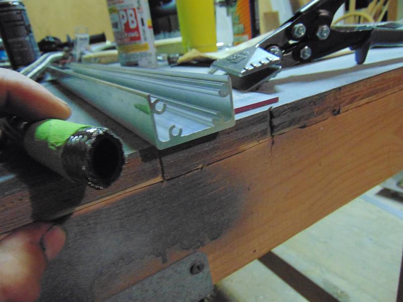

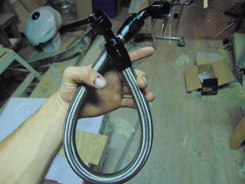

Today spent fathers day with the little man at the aquarium then cookout at my brothers house. To all you fathers on here happy fathers day!

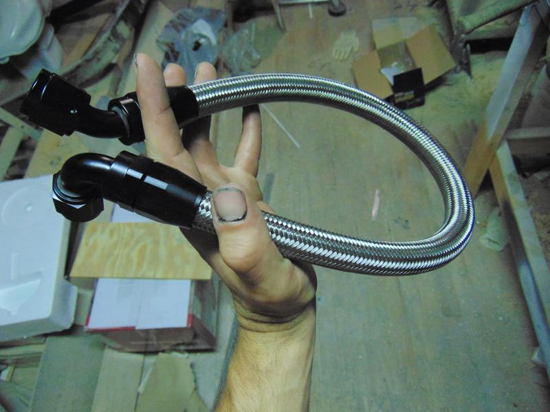

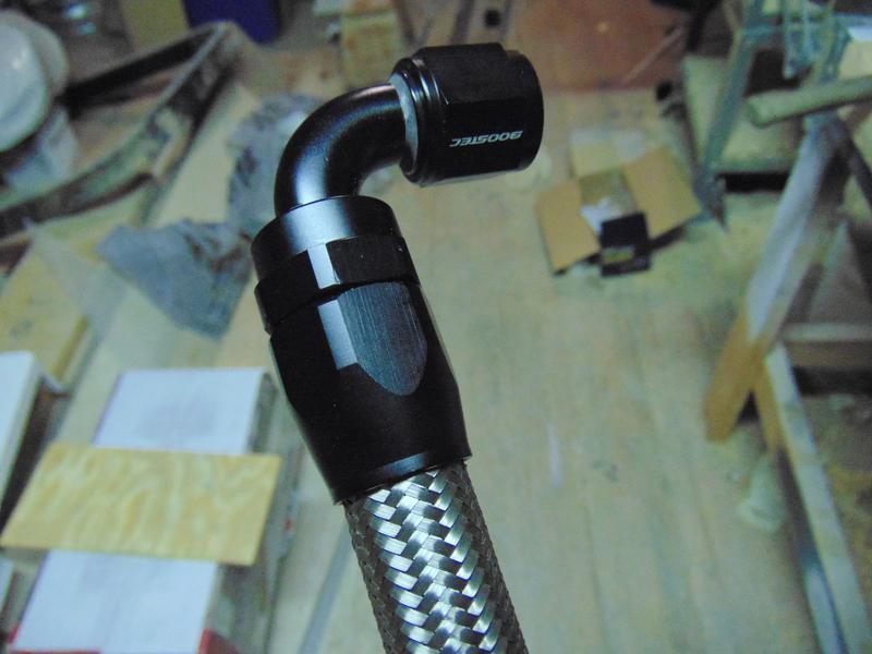

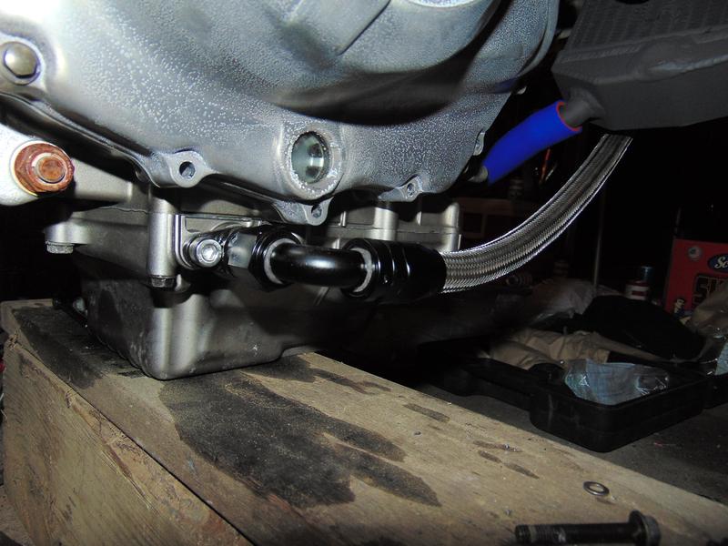

After I dropped the little man off at his mothers I was back in the garage for some AN fun!!! I use the term fun loosely, these things are a bitch if you dont have the "proper" tools... fucked up the first fitting, scratched it to hell because my shitty aluminum vice couldnt hold it, flexed too much and let it slip. good thing I have 4 of those fittings and only need 2. So I finally unpacked the beefy vice thats been sitting around for about 2 years, used oak spacers instead of pine and all is well in the world...
As I have seen recommended, using 3-in-1 oil on the threads and inner fitting work wonders. I used oak spacers on my vice as to not mar up the anodized finish. the company that sold me the hose doesnt use a proper hose cutter so a fresh cut had to be made on both ends. I found these really cool aluminum channels to hold the hose while I cut, apparently I have a bunch of these channels and could possible do something with them in the future...hmmm... I also put a strip of electrical tape on either side of my steel crescent wrench in order to not mar it up as I cranked it down. I'm sure the beveled seal on AN fittings do a good job of sealing but a little permatex high temp thread sealant cant hurt...
The engine side is final but the oil cooler isnt sealed and cranked down because I will be removing it to install the front valve cover and all that fun stuff...

Jason - its hard to tell with the valve cover off but the cooler only comes down about half way through the valve cover and sits about 1/2" from it, if the tires gonna hit anything it'll hit the cylinder head lol... also the lines dont come out nearly as far as the front header pipe so we dont have to worry about those either

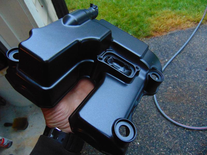

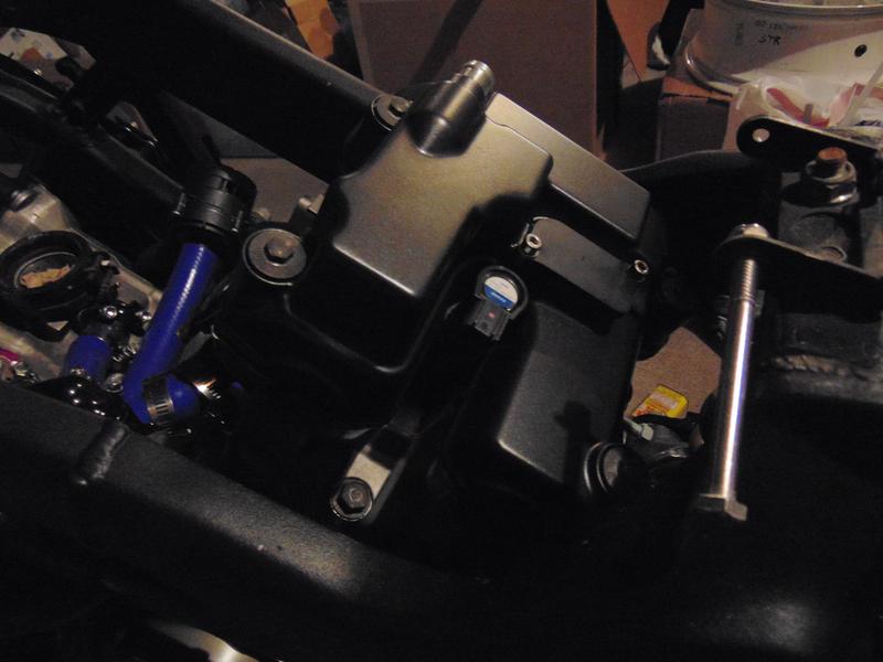

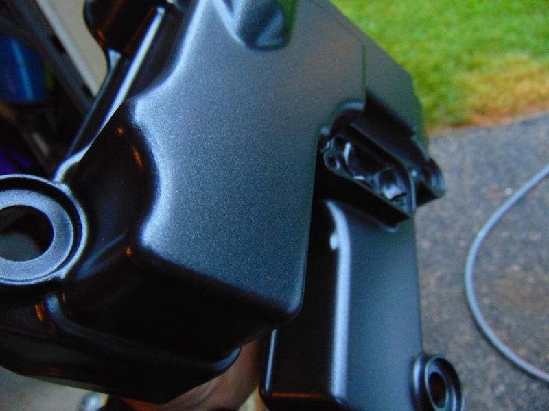

Alright so some shitty pictures... like I said, got my valve covers painted thursday night before going away for the long weekend. Its satin black pearl, very close to the factory color but darker, better and newer. Got those mounted up last night, coils installed, Pair blockoffs installed, PCV hose installed on front cylinder because zero clearance, and got my oil cooler installed permanently.

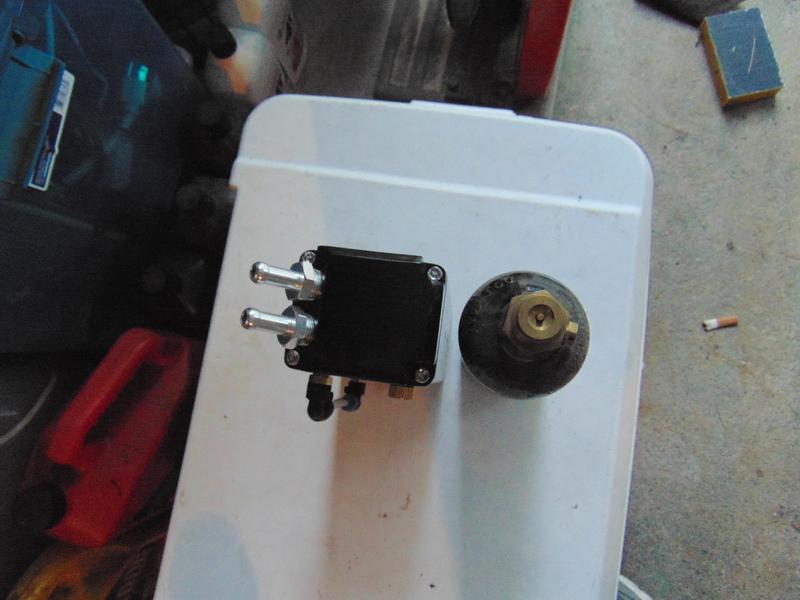

I like the look of the oil catch can I bought to use as an overflow tank but I'm not sold on the size and weight of it... for one I would have to mount it about 1 1/2" above the right rad to clear the fan switch and two, it will stick out 1/2"-3/4" past the rad to clear the coolant out at the mechanical pump cover...
Might just have to go to the packy (for you PA guys, liquor store) and find a cool bottle of something and drink it real fast to finish up the cooling system

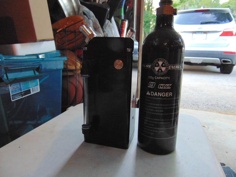

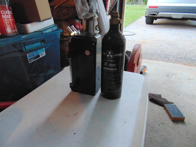

I think I just got an idea for my res tank. I believe I have an old 9oz CO2 tank kickin around... Ive seen it done before, it looks good and may give me more options for mounting. Gonna have to check it out when I get home from work and see if it will work for me.

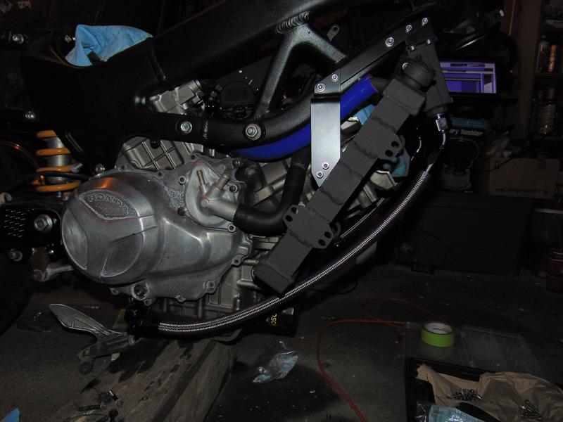

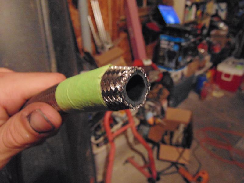

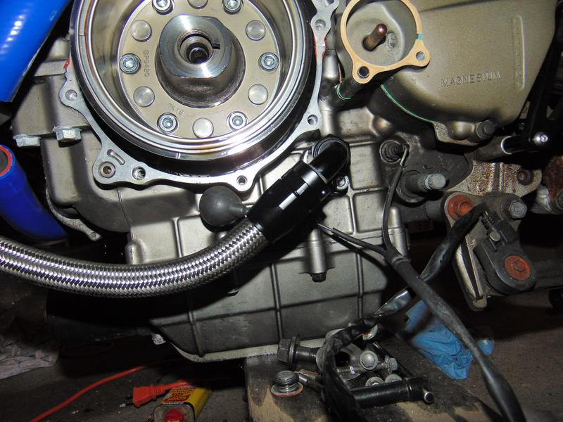

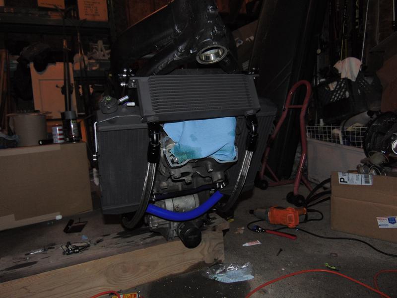

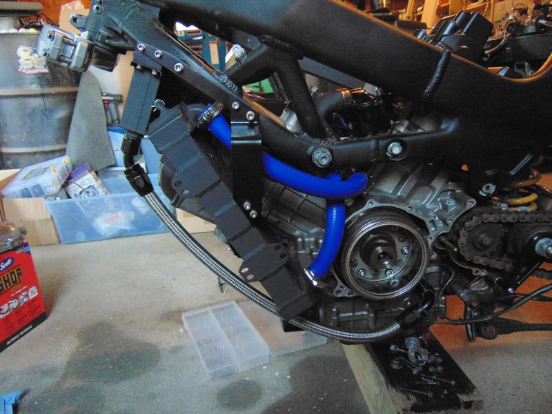

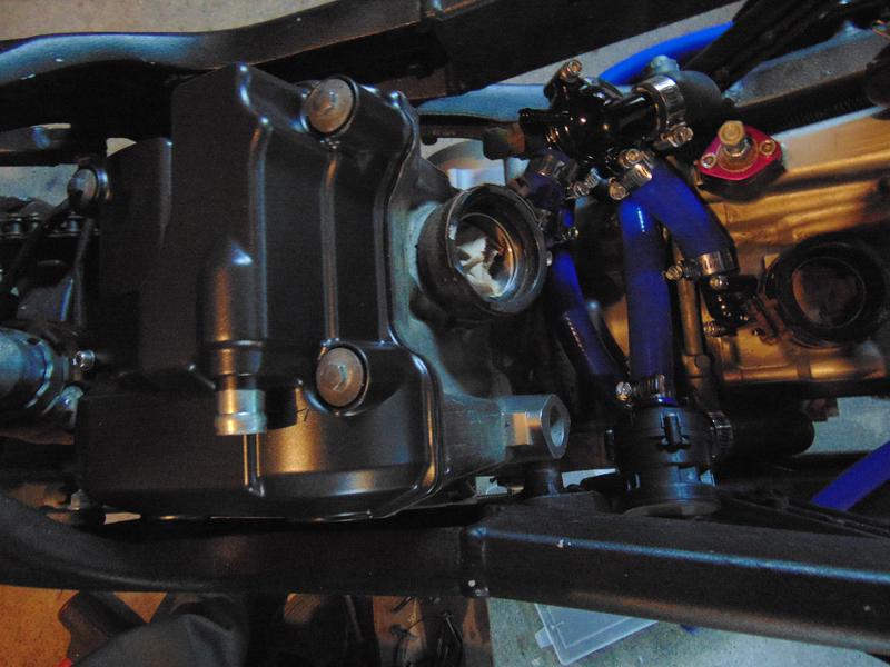

Got home from work today with a little bit of daylight so I took some more pictures of the cooling system. And a few more pictures of the 2 possible overflow tanks. The oil catch can is very heavy and takes up a lot of room with little options as to location but does look pretty cool. The CO2 tank however similar size is a little lighter (not much) but does allow more options for mounting (strapped to the subframe under the tail maybe). I'm probably going to use the the CO2 tank but any thoughts?

  #299
Remember, you don't really need an oil catch can. And the stock coolant system displaced 4 fl.oz. Not sure what capacity your new system has, but it looks a little bigger? Maybe displaces 6 fl.oz.? So, with a few ounces extra just to be safe, imagine a little more than half a soda can of space is needed.
Old Jul 1, 2015 | 05:35 PM
  #300
scottiemann's Avatar
Posts: 1,252
From: boston
I know I dont need it to be that big but the CO2 tank is roughly the same capacity as the factory tank, it looks cool, and is not susceptible to damage...
basically I need something durable, functional, and something that looks half decent because its going to be mounted outside of the frame
